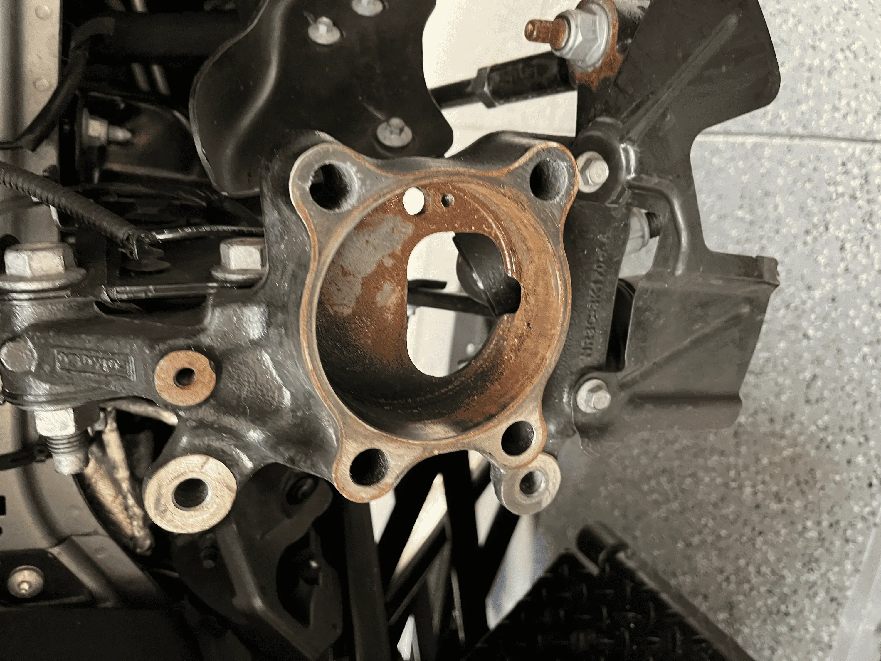

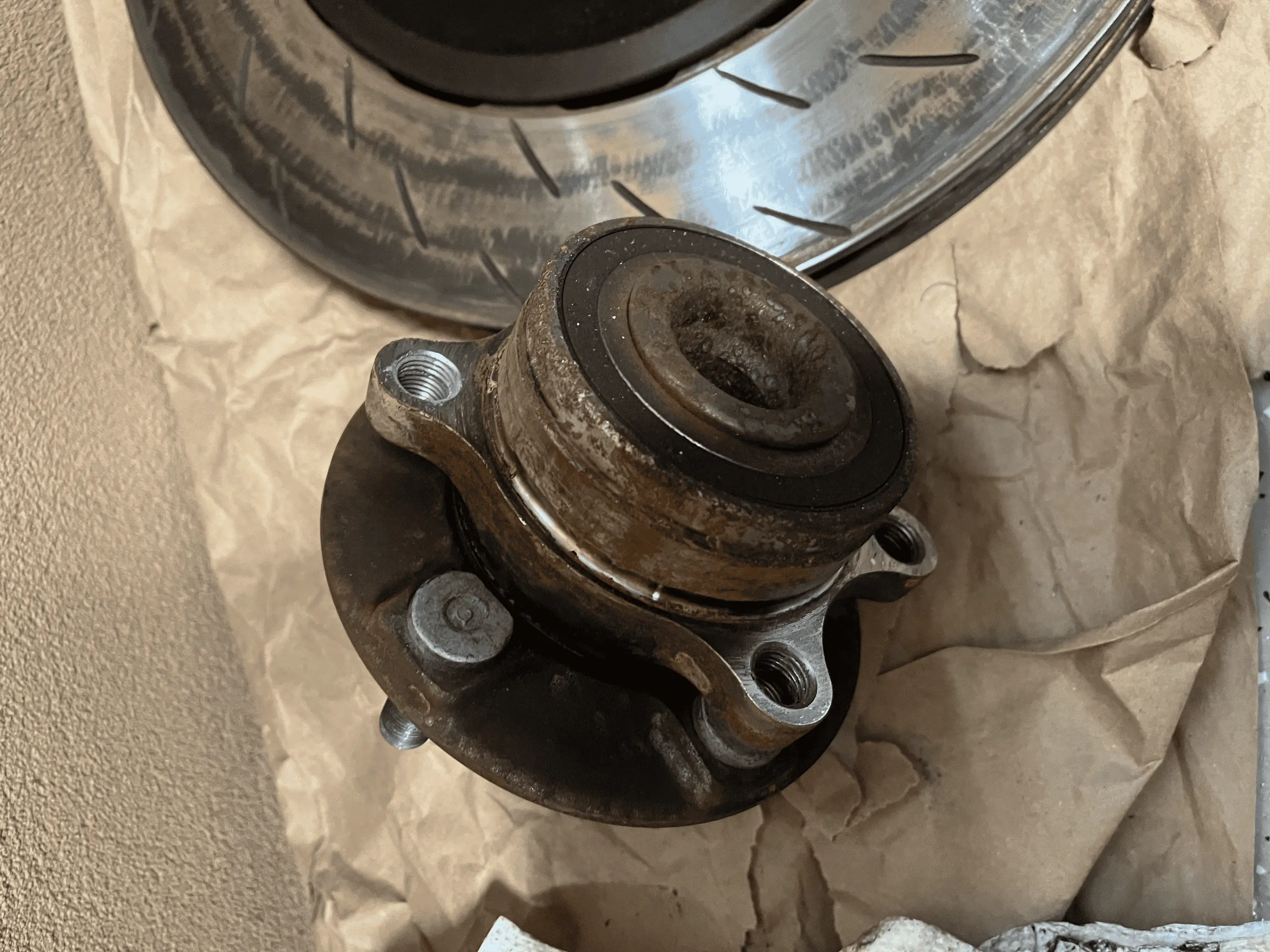

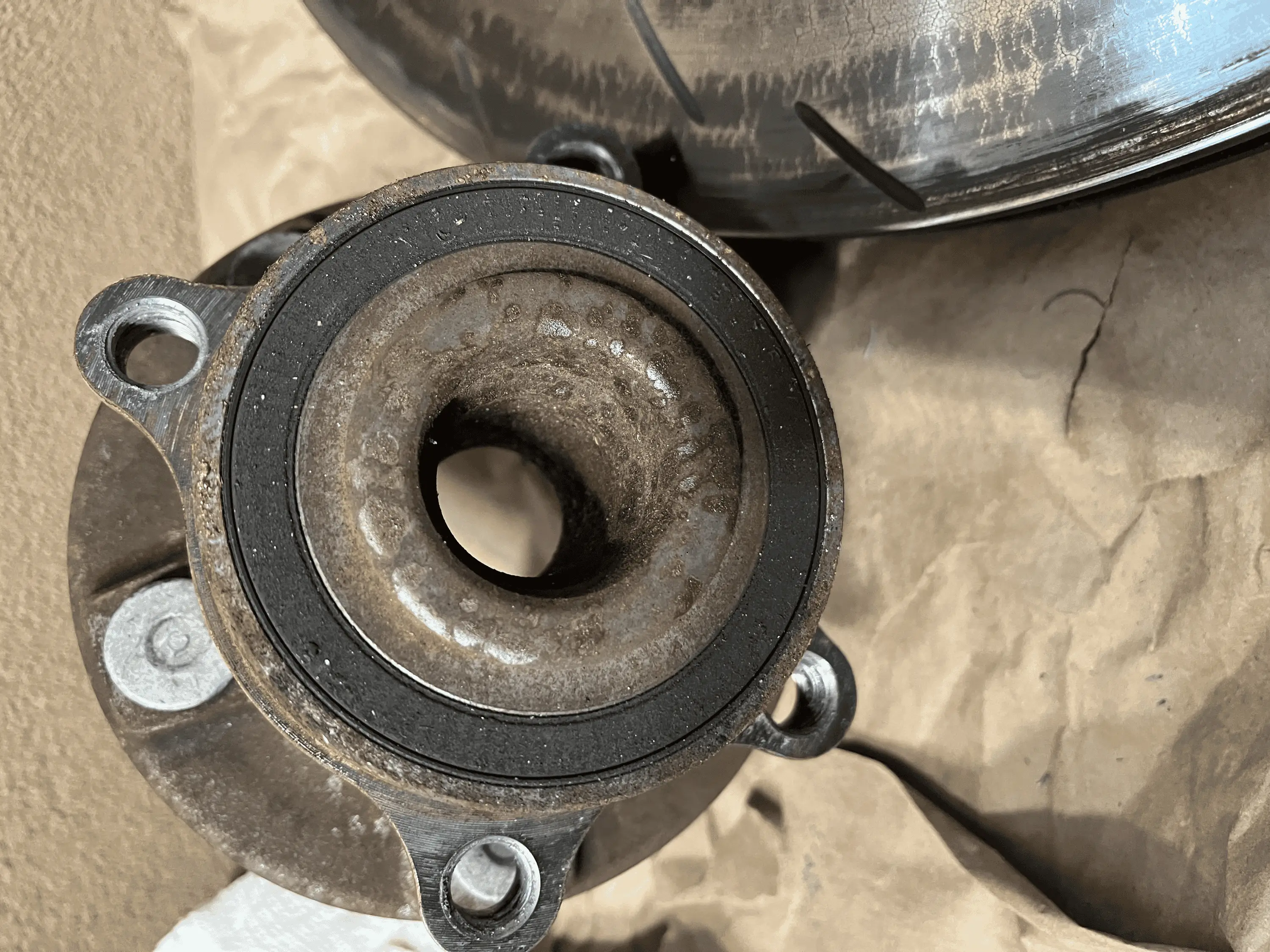

Old bearing out. Looks ugly, but only because of rust. When everything is off the only thing I notice when turning the bearing is it's really stiff. Once I get a replacement in and hopefully problem fixed I'll see if I can press or cut the old bearing apart.

-3.2° of camber and the fact that hub looks like it sat in the ocean for 39.3 days, will do it. 100%....

Yeah, the amount of rust is really amazing. My car has run literally 4x times in the rain since new. Of course there's a bunch of stuff under the car that's not painted and rusting. I'm in a pretty mild climate too. No snow here.

First, I am glad to see the hub is so easily changed.
Second, that rust makes me want to take it all apart, clean up and coat with some synthetic grease...... That rust will only get worse and eventually possibly fuse the pieces together....
