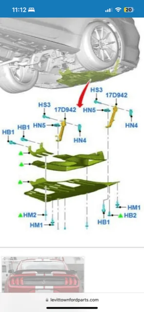

Hello,
I ordered the GT500 Diffuser kit from Levittown Ford. There are no directions with the kit, and the diagram image on the website it not quite clear enough for me to see how the two support brackets for the closeout panel mount to the car and panel itself. Has anyone installed this kit and can provide guidance? Or, is someone that has a GT500 or Mach 1 able to take a photo of how it is mounted on their car? Thanks in advance.

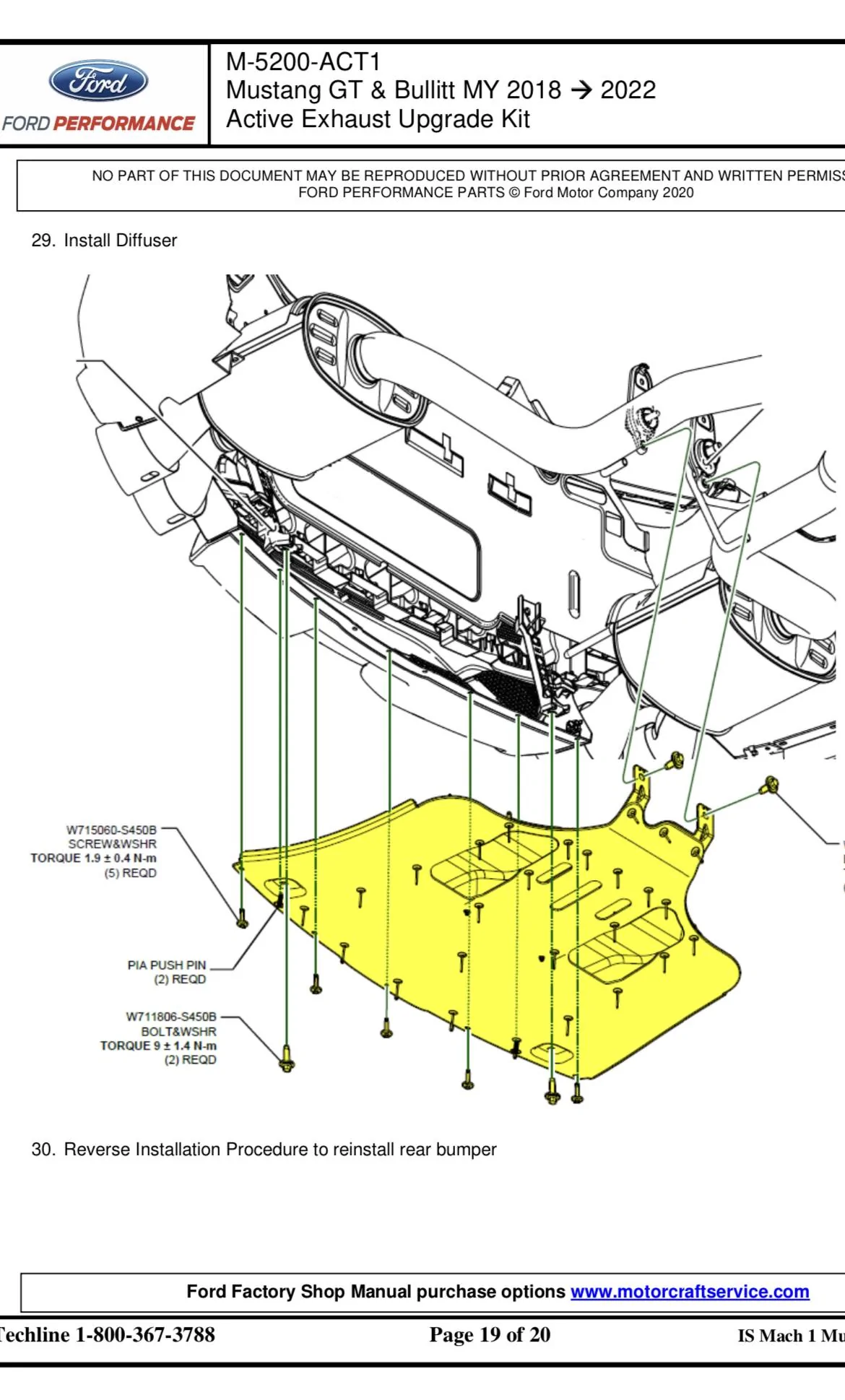

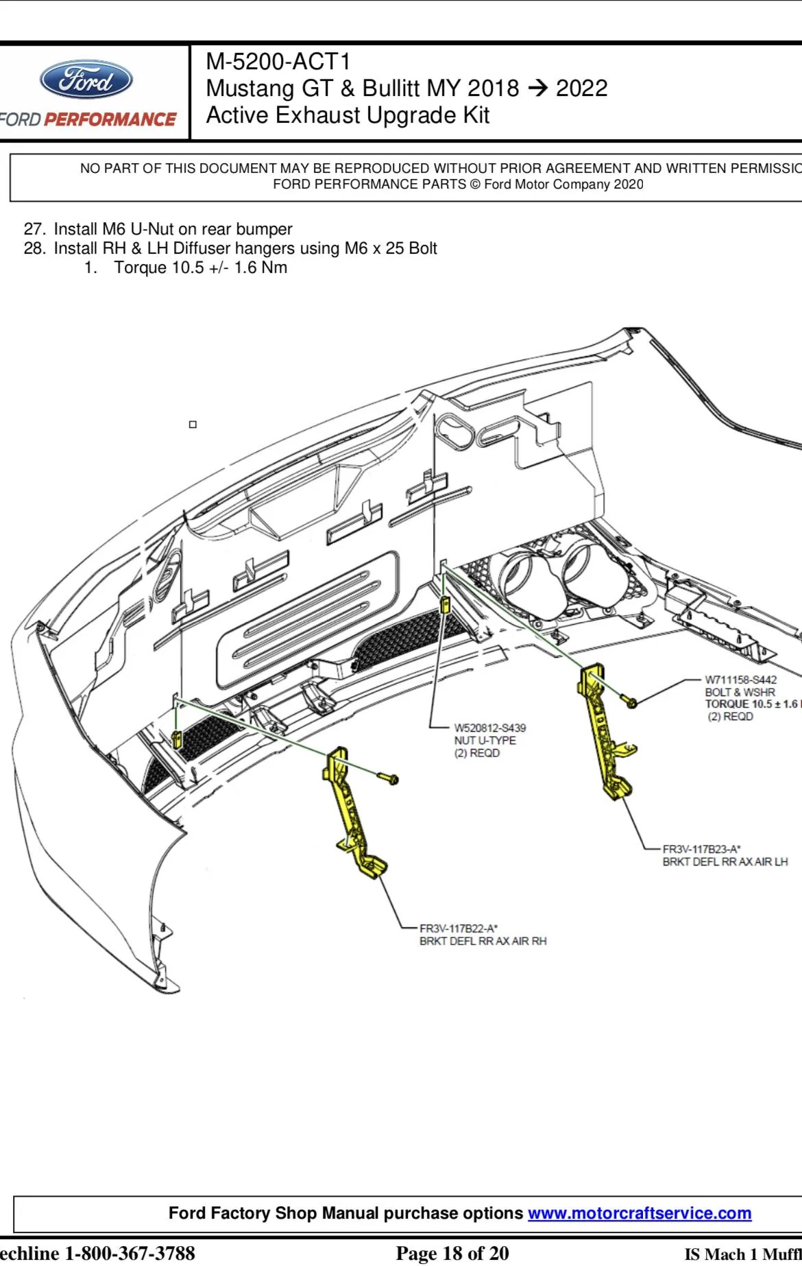

This part?
