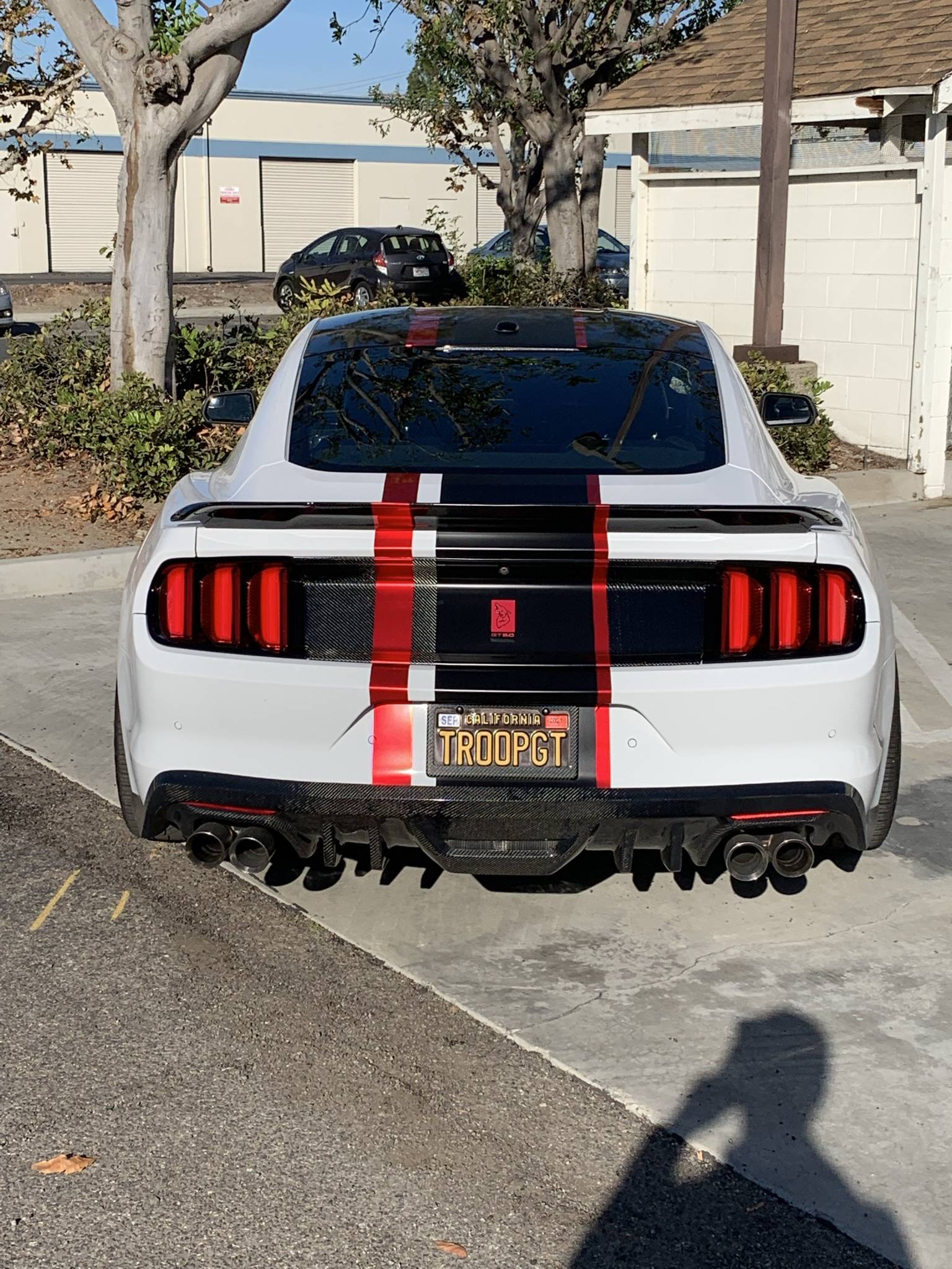

I installed a rear diffusor on my 2015 that required me to relocate the backup sensors and mod the bumper. Honesly if you want to cut the bumper just buy a back up one from ebay for Craigslist. On the quad mullfers I went with Steeda ones that are supposed to fit 2018. They sound great and look good. Here’s pics of mine.
