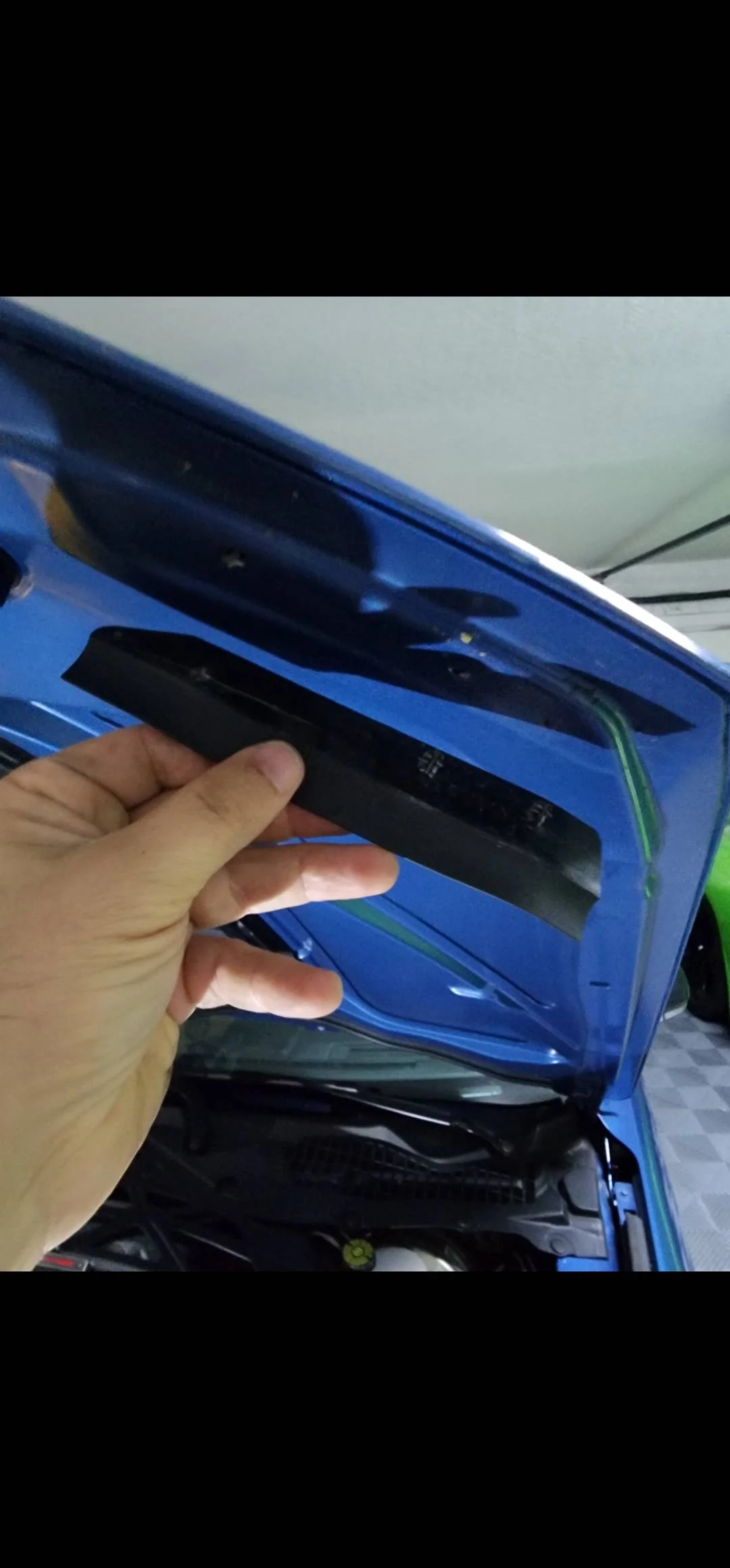

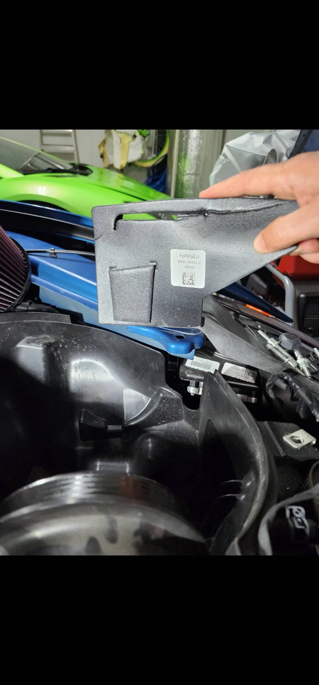

Anyone notice the foam and why it's there...I assume for emissions etc......if you remove foam you can see cold air will be available coming from the removal of the plastic trim sealing the driver side headlight.....what do you all think...
We know removal of the intake lid will allow too much hot air in and reduce performance....this may work see pictures attached

The foam piece is to seal the side of the airbox and prevent hot air from entering. The intake gets it's fresh air from the front grille. The plastic piece you pulled off the hood is to help reduce hood flutter.

I will test this out and see..... the point is cold air should enter above the headlight as car is moving and allow more flow to the K&N filter with foam removed.......and dealer wont complain about the aftermarket box.... (hood pins should prevent the "hood flutter" )

Anyway this foam removal didnt make a difference on butt dyno....in traffic IAT went from 86 to 92+
