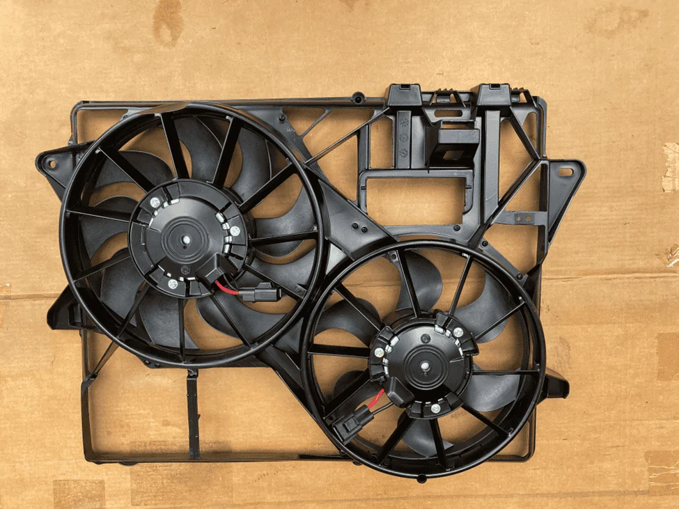

Has anyone tried to install the 20+ GT500 cooling fan on their regular Gen 3 Mustang GT / Mach 1 / GT350? It looks massive and I'm sure it would be a huge benefit for SC Mustangs and track mustangs. I like the fact that it has a ton of flaps to allow maximum airflow at highway speeds. Just based on the location of the mounting holes, it looks like it could fit our cars. Anyone have any insight?

So after doing some more research, I'm not sure if this would even work. It's about $600+ and not in stock anywhere. It's still up in the air whether or not it would even fit. I also cannot tell if this is a 2 speed fan or variable speed. The stock GT fans run either together on low speed (series connected through relays) or together on high speed (parallel through relays). I could still make this work either way, but I'm not sure how "factory" it would end up.
Have you been able to find any flow (CFM) data during your research?
