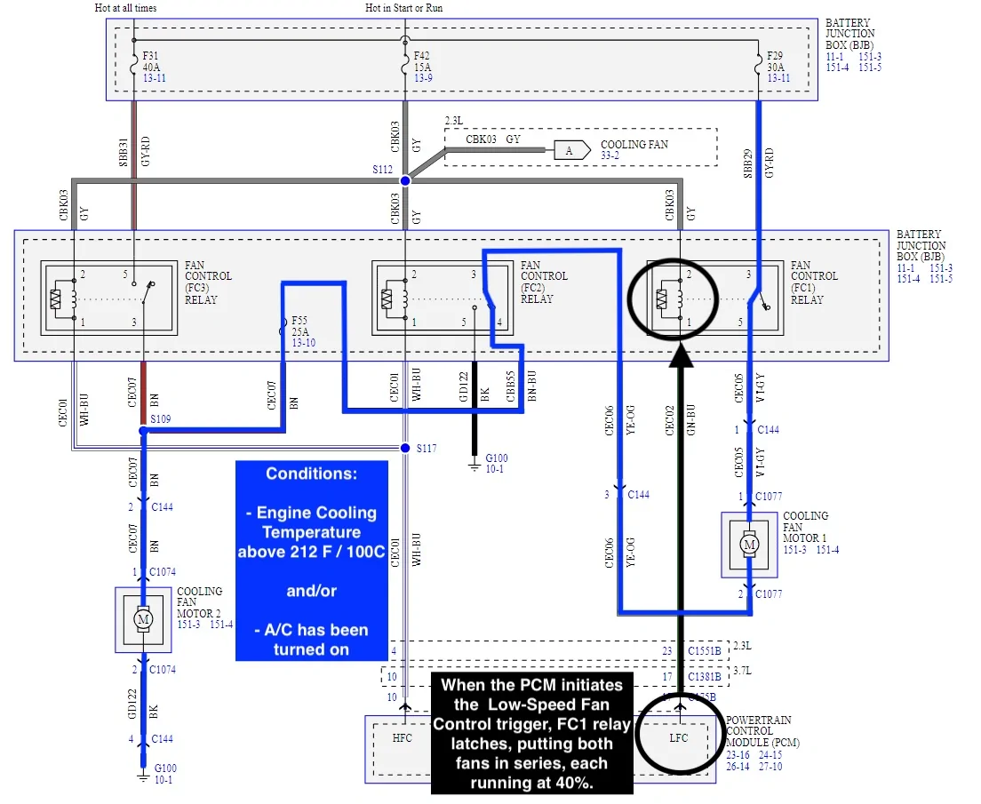

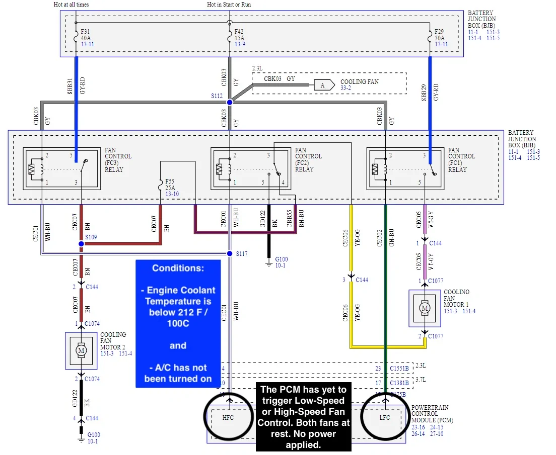

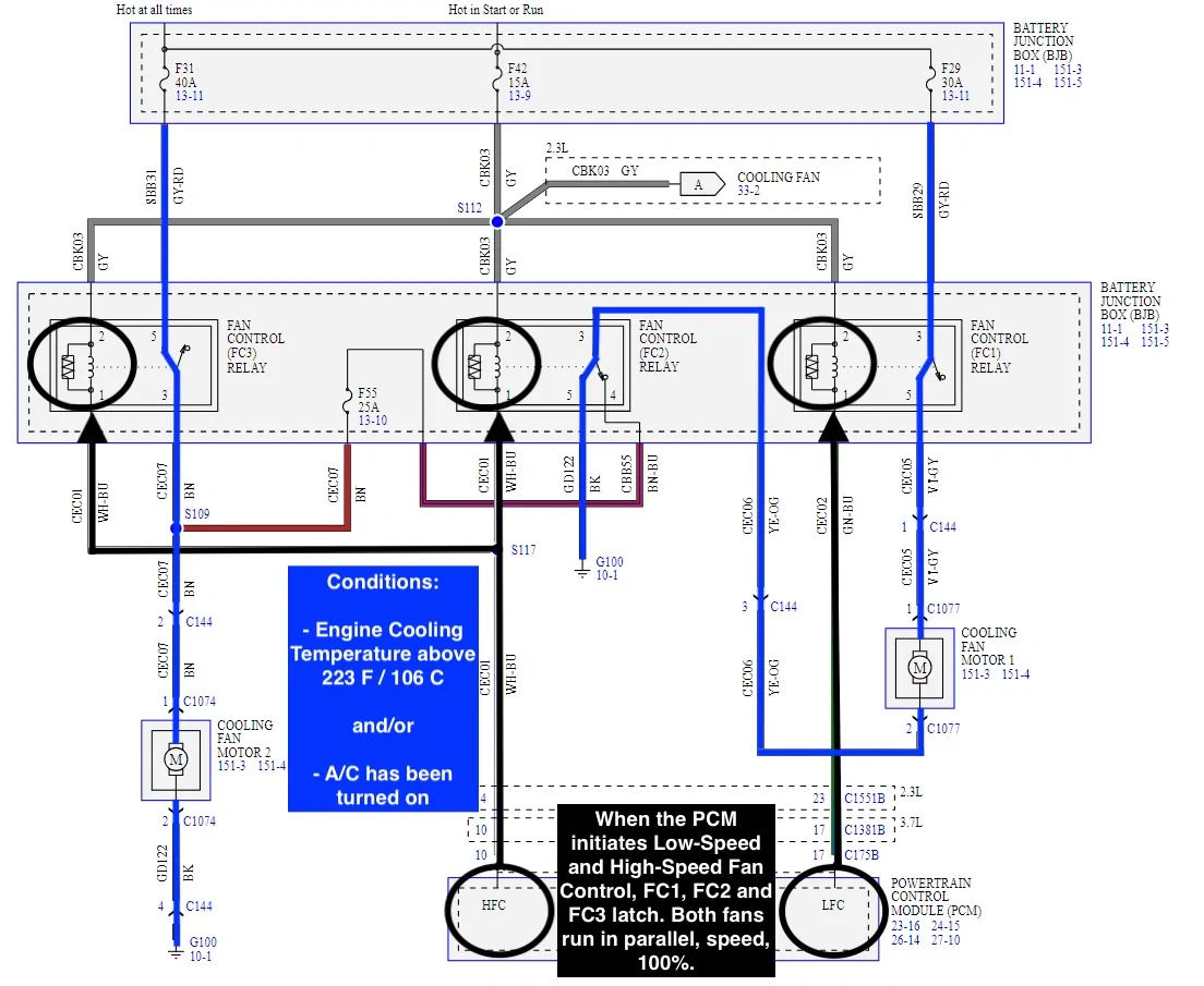

Part of the logic of the S550 is the fans will come on when the A/C is on, regardless of engine temperature. I'm attaching some schematics which help describe it.
Feeling the fans...unless they're making a noise or rattling or something, I feel it's normal. I notice when mine come on. I think most people do.
If you think the fans are cycling too often, or they are cycling in a new pattern, that could be an issue. You could have the high and low side pressures of the A/C checked to confirm the system is charged well.
If the engine temperature only (A/C is off) is engaging the fans, they should come on and stay on, until temps lower to a point.
It does make it a bit different, tying the A/C and cooling logic together. It's my understanding this is done not only for temperature control in the engine compartment, but to ensure air is flowing across the A/C condenser, especially when idling at a stop.
