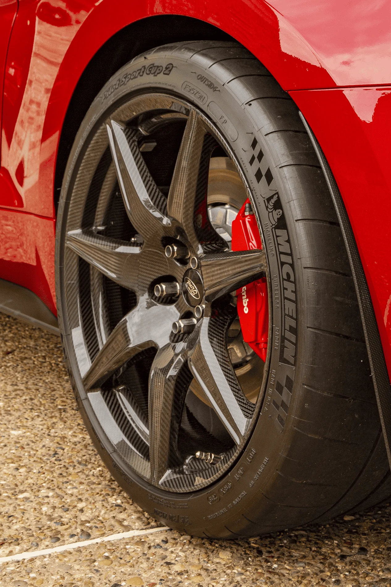

Here's a tire with probably ten applications of Perl since last Feb.

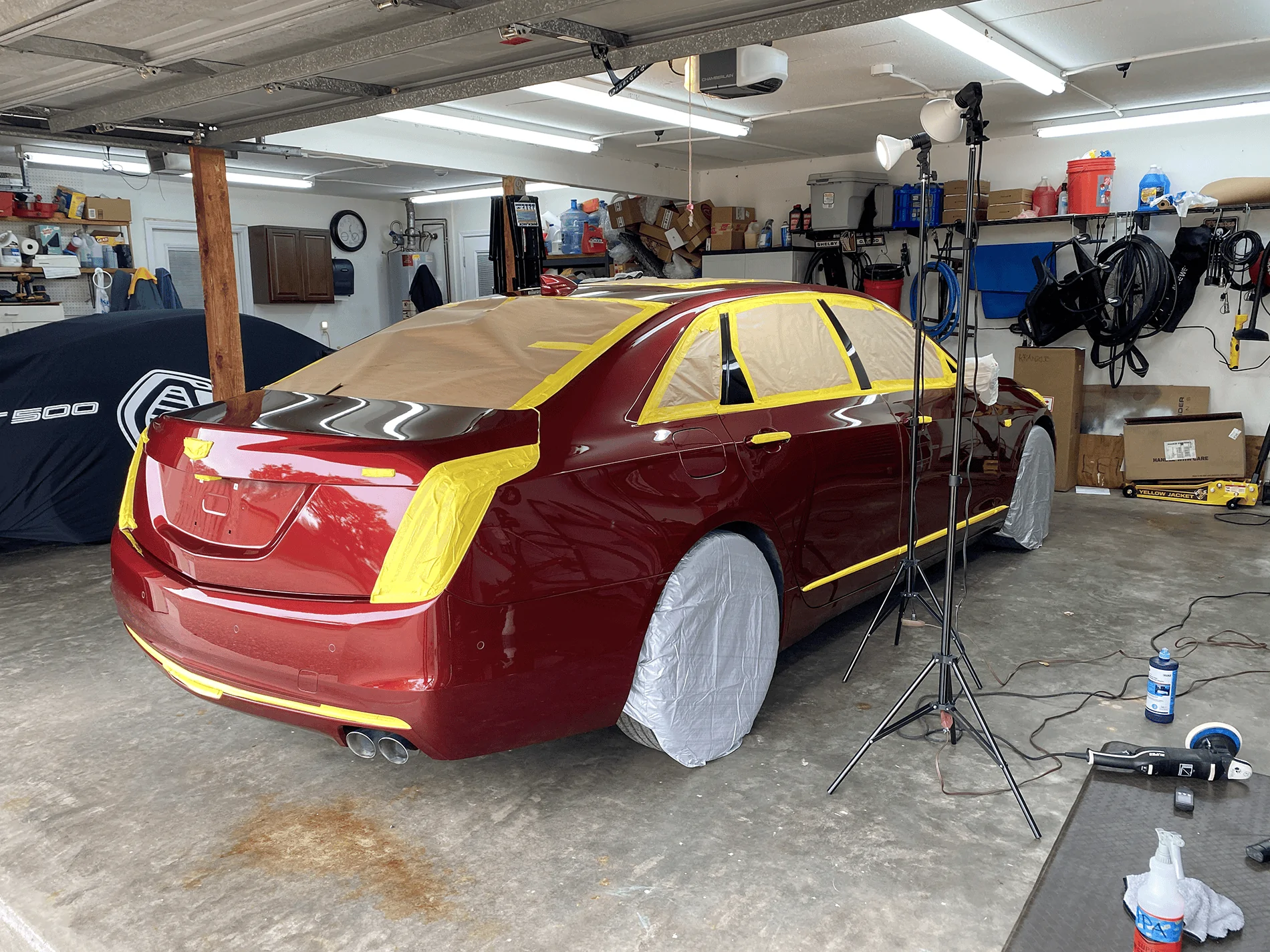

Meanwhile, for practice I'm going to ceramic coat her car first before Sarah gets hers which means mild paint correction (except for a few spots of former bird dodo and a few scratches which will need more work.) So, that's what I'm doing this week. Sarah has to go outside when the machine polishing takes place because I'm a "slinger extraordinaire" with one of those things. :-)

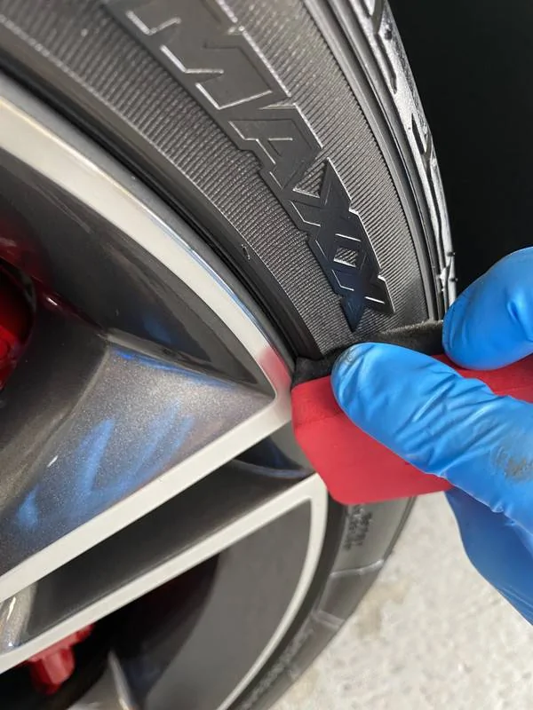

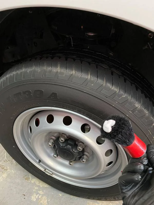

For tires, I use Perl straight from the bottle with either a brush or a foam applicator block.
Perl can be diluted for other applications but works better neat from the bottle for tires.
303 Aerospace protectant can also be used if a matte finish on tires is preferred.

I use those applicators too. I love them, just the right size.
I only use Perl occasionally for tires, preferring the Australian market NV Onyx dressing applied with a red version of that applicator sponge. Onyx is amazing stuff, giving just right amount of sheen without that slimy slick look and decent longevity considering it water based formulation. If you ever manage to find some in the US, you will not be disappointed!

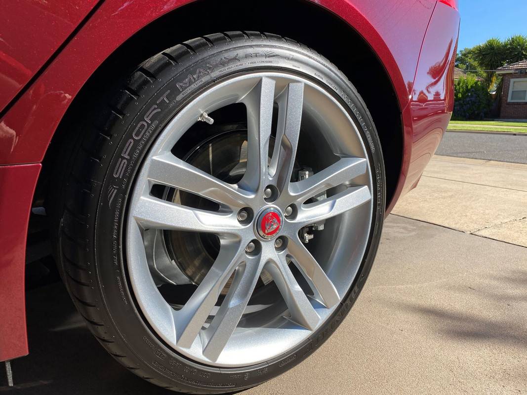

For reference, this is what 303 looks like on tires. Being water based like Perl, it won't last long. If you are anything like me, I love apply tire dressing so longevity is not an issue.

Thanks for the reference shot of 303 on rubber. Pretty darn close to Perl.

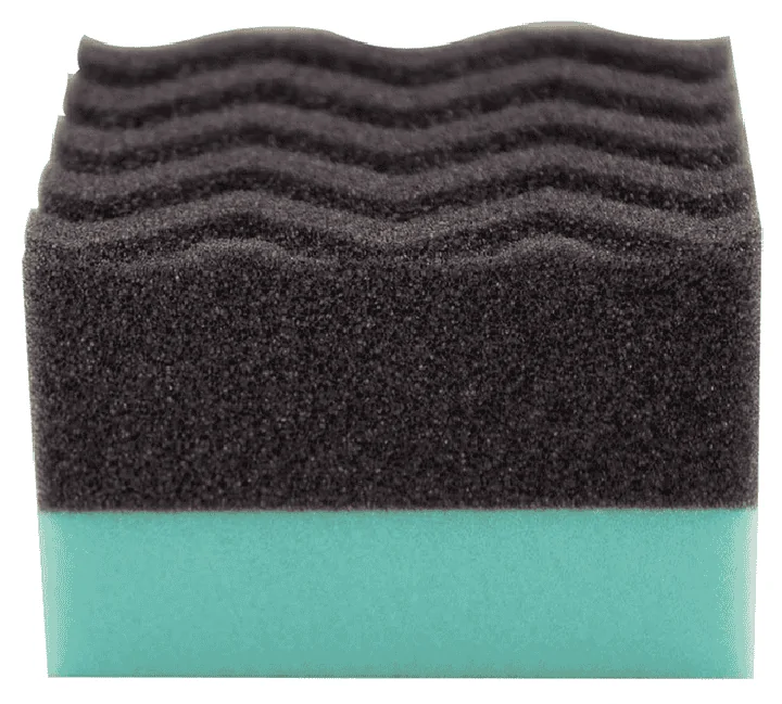

Tom: If you have a spare squeeze bottle, put the undiluted Perl in that and then cover the square foam pad to about 80 percent coverage. Work it in to the foam with your fingers and then apply. I find that using two directions of movement with the foam or even circular movement over text on the tire, can get the excess out of the nooks and crannies.
Give it twenty minutes or so in your humid air and then buff with a cheap MF. Here are the pads if you didn't look yet.
