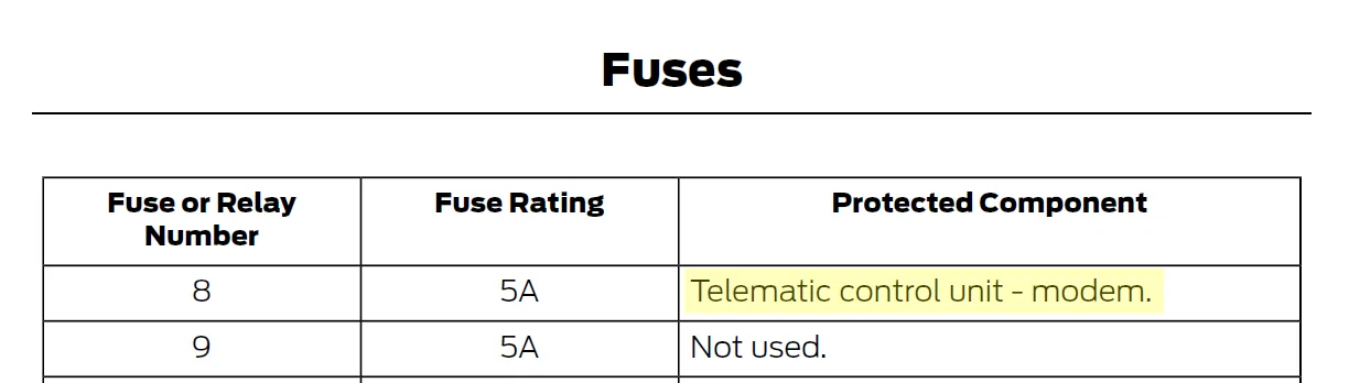

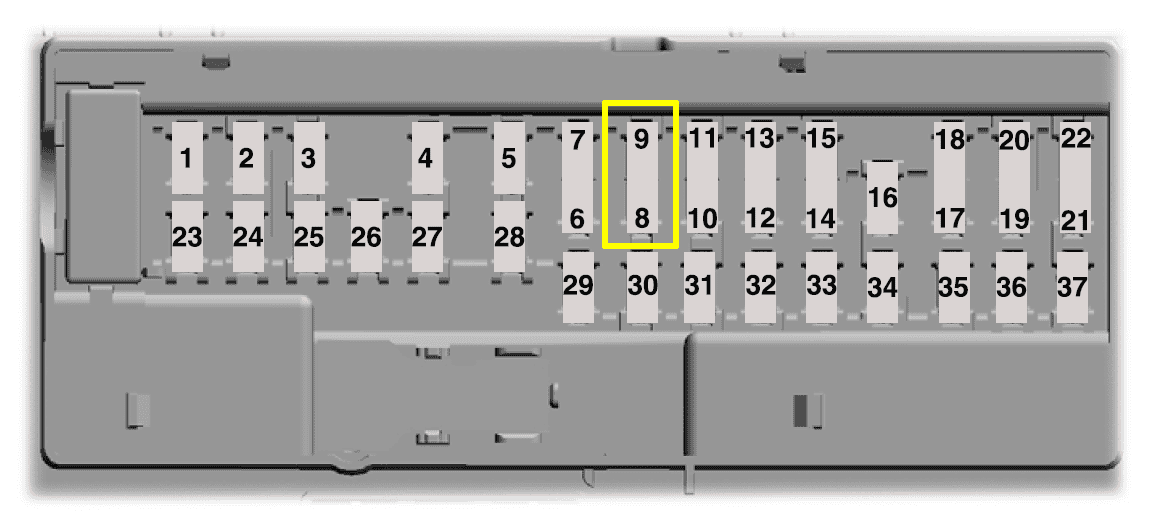

AMC: You are of course, absolutely correct There is/was a VERY long thread about FordPass and eliminating the modem's functionality in the 2020 section, to prevent the data from being sent.
There were a number of methods suggested to break the data chain with Mother Ford. I took the easiest route and pulled the fuse at position 8-9 which apparently only has one load on that circuit, the modem.
I am a fan of technology the vast majority of the time but in this case, I found that what was being sent was simply too intrusive. Others don't mind and that's cool, too. My buddy, the ASM at my store, did NOT like it, however. :-)
From Pages 230-231 in the owner's manual...

By removing this fuse, does it effect anything else on the car ?

No. The embedded modem of the telematics system is the only thing on this circuit.
So the only thing that you lose is the FordPass system. Great
