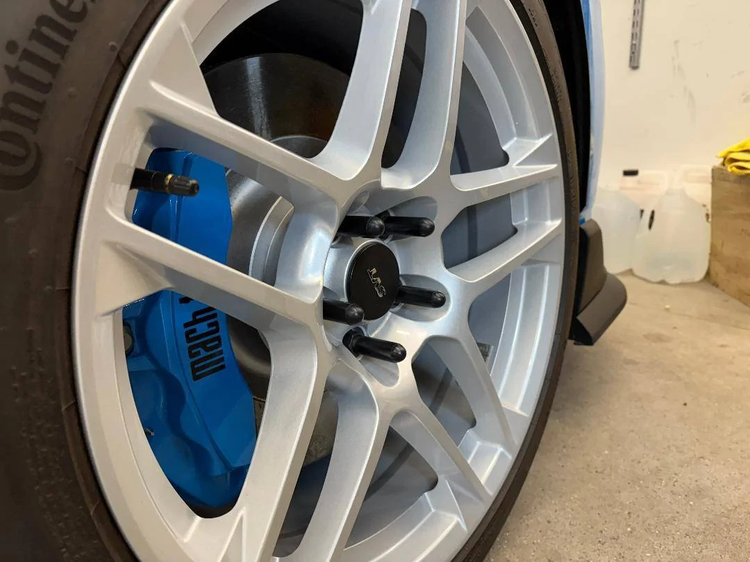

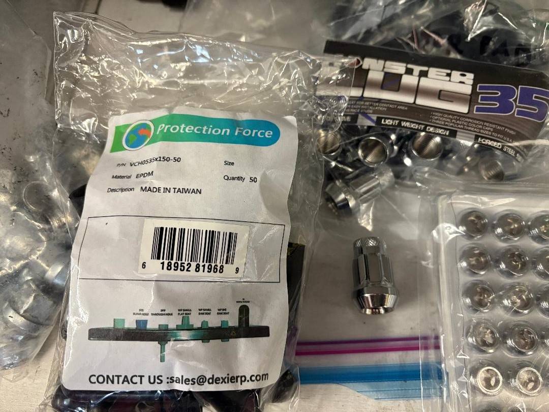

I've got square setup 11.5" wide +56 offset wheels w/35mm spacers up front for summer and 10" wide +35 wheels for winter without spacers and the extended studs on the winter wheels look ridiculous. I couldn't find long enough lug nuts to compensate for the GT4 extended studs so I tried some extended length open end spline drive lug nuts and it still looked silly. So, I just covered the exposed studs with cheap rubber caps (trimmed to length) to at least offer the exposed threads some level of shielding from the salt and road grime. I haven't figured out how I'm going to remove the caps, once they're on they're not coming off.
