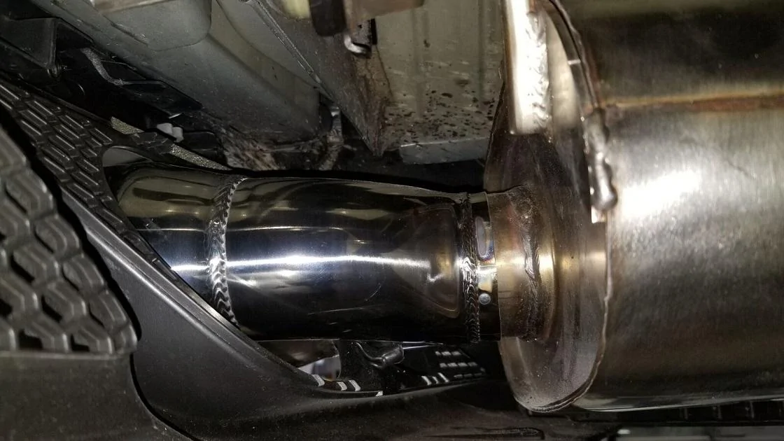

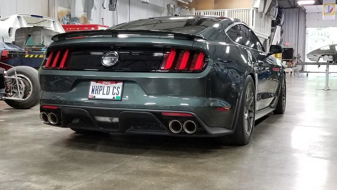

Sorry it took so long, I had a really long laundry list this winter!:D
Anyways, here is the GT350 valance with my modded 3" Borla S-Type exhaust..
Here is where the new exhaust tip slides onto the Borla muffler...

That looks amazing great job.

Thanks [MENTION=23692]cpelaez1[/MENTION] !
My exhaust seems to gurgle/crackle more now. I'm not sure if it because of the exhaust tips, or the other changes I made over the winter...

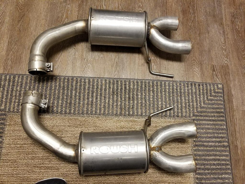

I ended up getting a deal on a full GT350 catback so I have pulled my Roush mufflers and GT350 tips to sell. Soon I'll have functional active exhaust as well
[MENTION=28465]ghst[/MENTION] here's how the mufflers looked when done. The 350 tips sit slightly higher than the stock GT so the hangers were modified a little as well
Do you have any pics of this setup? I currently have the dual tip Roush ABs paired with a SS H pipe, and I realllly don't want to give up the sound (but love how the gt350 diffuser looks). I'd appreciate it if you could post what they look like out the back!
I'm debating whether to get dedicated quad tips welded on to the end of the roush ABs or not for this setup. The valence comes with "tips" on it from ford right?:shrug:
