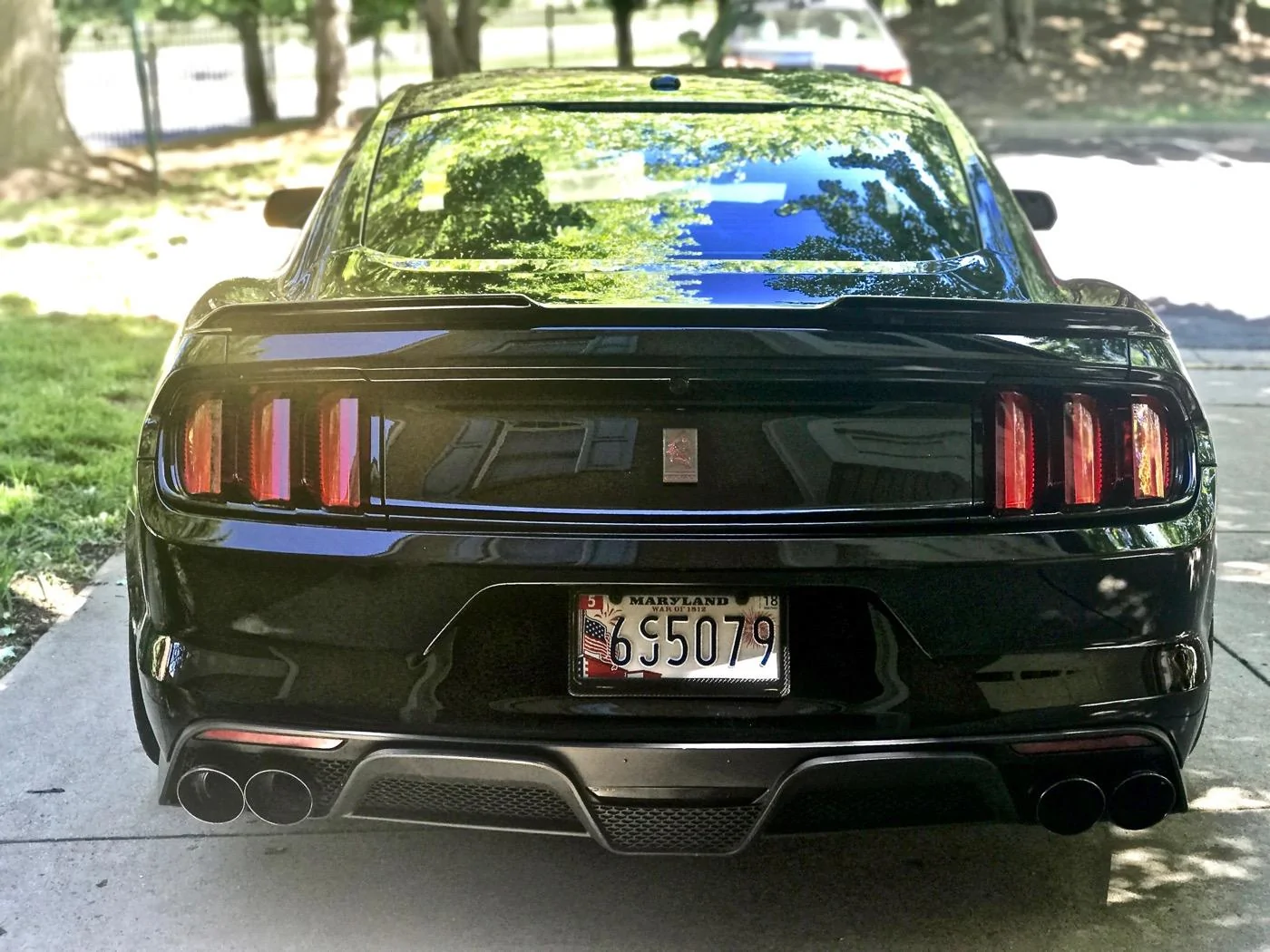

Ended up taking it to good ole time tested Dougs Muffler in Clinton Township, they hooked it up for $200 and it took an hour. So far both the body shop and exhaust shop didn't have nice things to say about the valence but it was worth it! So fn hyped that my base bumper is gone. The corsa tips stick out a few inches too far on some mad max shit but at this point I just don't give af. I'll probably have them adjusted sometime this summer. So $200 to weld and install, $330 for the tips and $300 for the valence iirc? Worth. every. penny. Sorry if the pic is too large:

Ended up taking it to good ole time tested Dougs Muffler in Clinton Township, they hooked it up for $200 and it took an hour. So far both the body shop and exhaust shop didn't have nice things to say about the valence but it was worth it! So fn hyped that my base bumper is gone. The corsa tipa stick out a few inches too far on some mad max shit but at this point I just don't give af. I'll probably have them adjusted sometime this summer. So $200 to weld and install, $330 for the tips and $300 for the valence iirc? Worth. every. penny. Sorry if the pic is too large:
Very nice man. My rear bumper is being sagged down a little and I will need to keep adjusting. The ikon fit is not that good but it was cheap. I noticed you got the two little dots above the reverse light from screwing in the reverse light. Same exact thing happened to me. Still looks good though.

Basically it was a big headache and I'm relieved it's complete lol. Your car looks phenomenal and I hope the bumper sag issue is a quick fix. I forgot I had to pay $300+ for the used premium bumper and it had scratches so it needed some work but luckily it was DIB. So yeah over $1000 to get this done right...

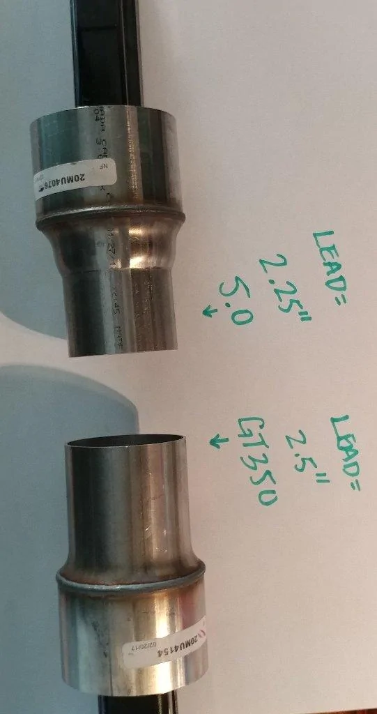

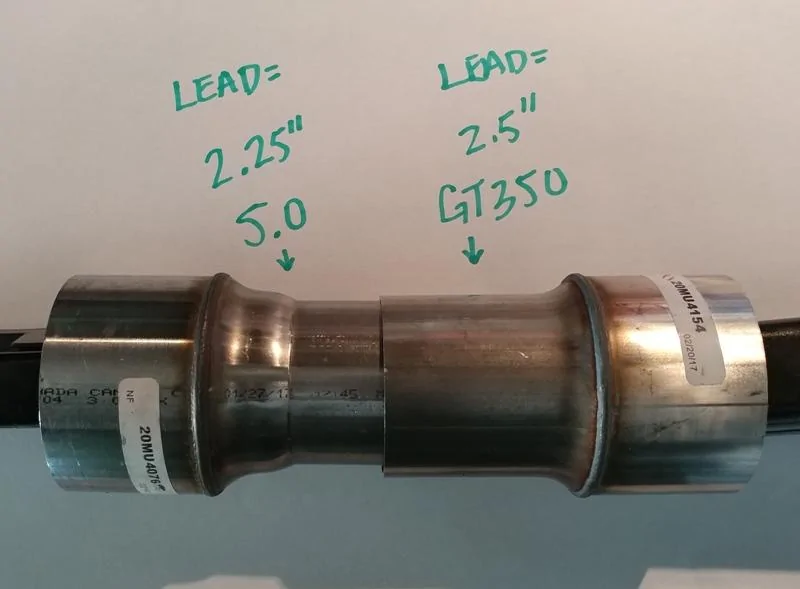

You have to change the two lead reducers, everything else bolts in.......The Corsa system for the GT350 is not active.
What two lead reducers did you use? Thinking of doing this same set up on mine

You need the lead reducers for the coyote motor because the leads that come with the GT350 system are for the Voodoo motor which is larger......

Just put a WTB add on the forum, there are a few guys who put on headers and have no use for the lead pipes. Thats how i got mine........I dont think corsa will sell them seperately, but it wont hurt to ask.
