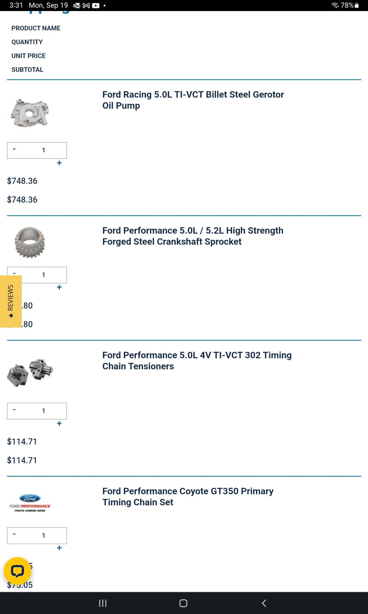

Are these an upgrade for a 2022 Mach 1? I would install these when doing OPG/CS and Boss 302 tensioners as well.

Idk about the mach 1 but on my car the gt350 chain looked exactly like my cars old chain

Hmmm. I think they are definitely an upgrade for a 2015. I wonder if they just weigh some number of grams more even though they look visually the same…?

Could be, didn't look too much into it. Just looked the same

gt350 chains have a different part number from ford. i use and recommend boss tensioners. stock tensioners don't have any real tension when you start up or at low rpm after warmed up because they don't have tension if you don't have oil pressure. using boss tensioners will prevent any low rpm rattle because they have a mechanical tensioner built in. so they can not loosen there tension even without oil pressure.

What else do I need?

Its the oem pump but with Ford billet opg.
Oh alright. I did boundary and a stock oil pump housing for wayyy cheaper. But yeah maybe an ARP crank bolt?

you don't want those tensioners. you want boss 302 tensioners
sorry i read it wrong. your good
