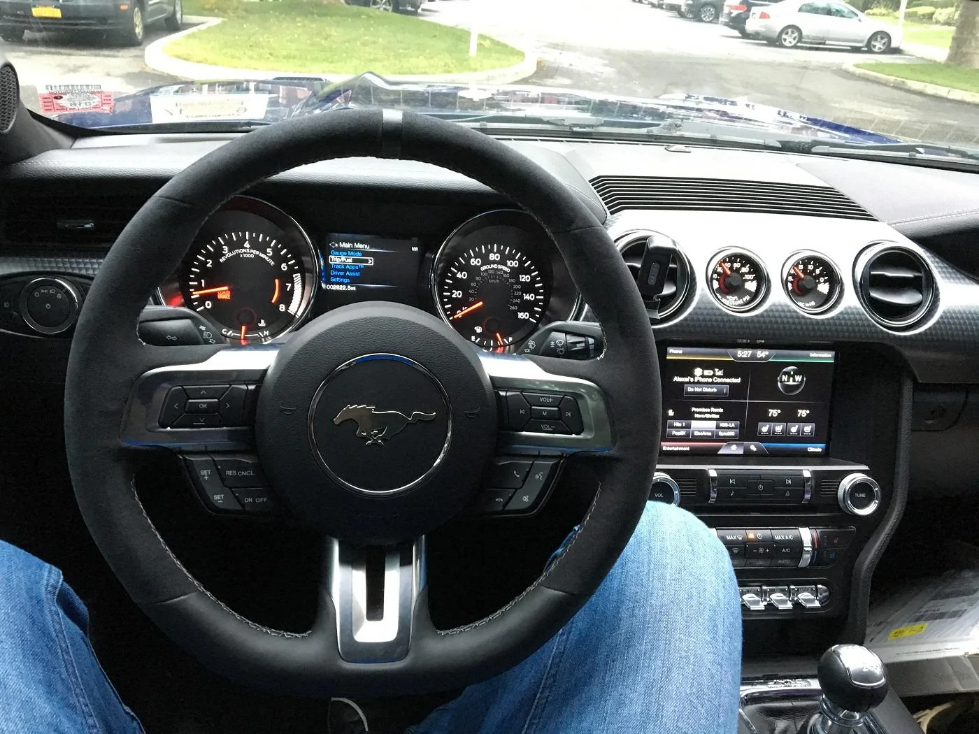

Well I finally got mine and installed it yesterday. Levittown still has the order as processing, but there it was on my doorstep on Friday :cheers:
Some notes:
-The bottom trim piece is a pain to remove from the old wheel so make sure you have some kind of trim removal tool, or just wrap some pliers in a piece of cloth to pick it up from the bottom.
-Also the main bolt that holds the wheel clearly had some red thread-lock on it and I did not see this mentioned anywhere. Only had blue on me so I figured its good enough.
-The wheel will wobble until its completely tightened, I tightened it half way it it was very wobbly to a point that I thought something got caught in the way.
Other then that a very easy process which should take well under and hour.
