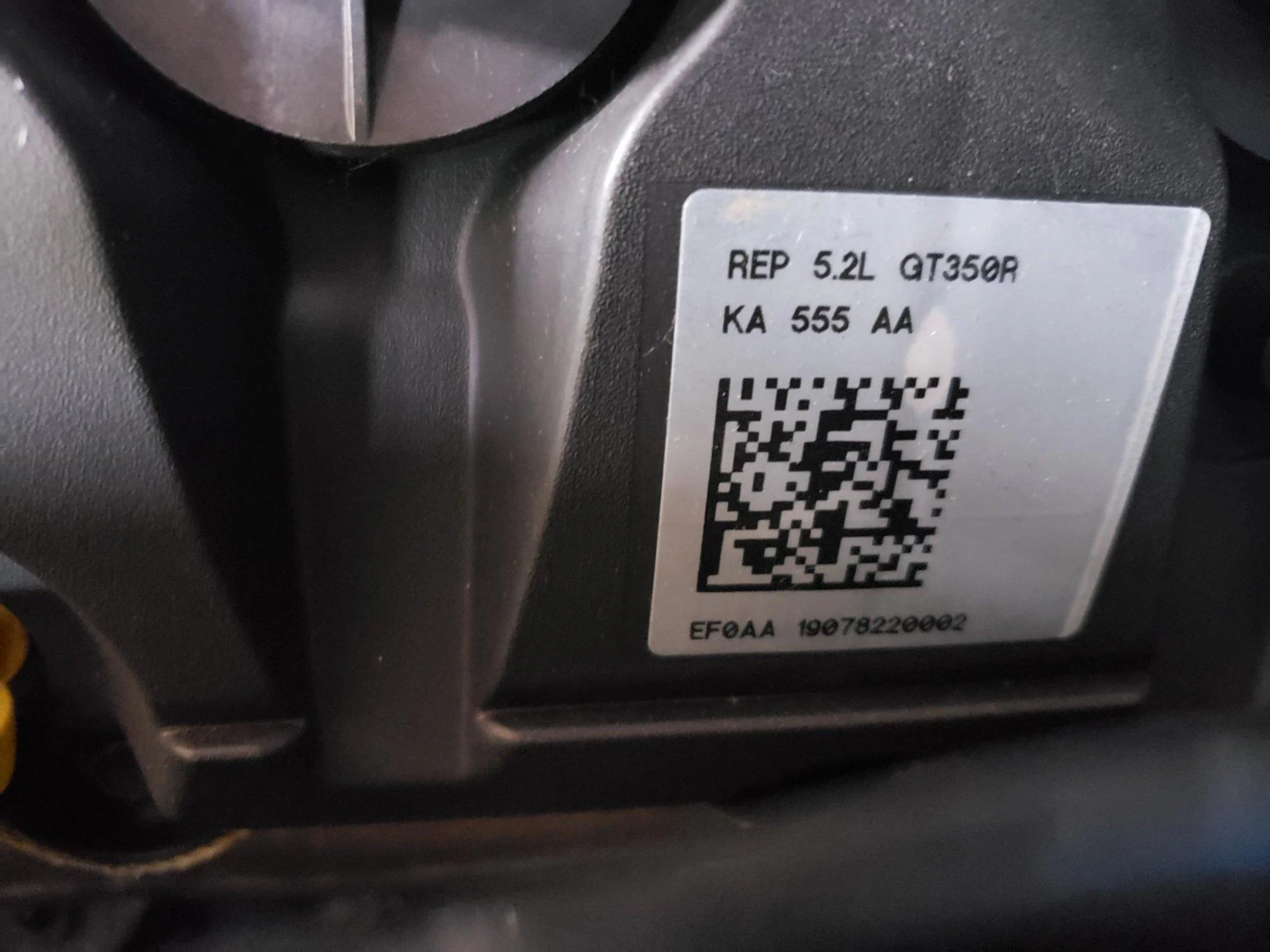

Never got the code from my 2017 engine that died at 1616 miles. Here’s the new engine I just received. Chassis H3283
JR369
Oct 22, 2018
1,312
1,280
2022 GT500 Iconic
Looks like a 19 R engine to me. Built April 10th. The 4th engine of the day. Congrats.

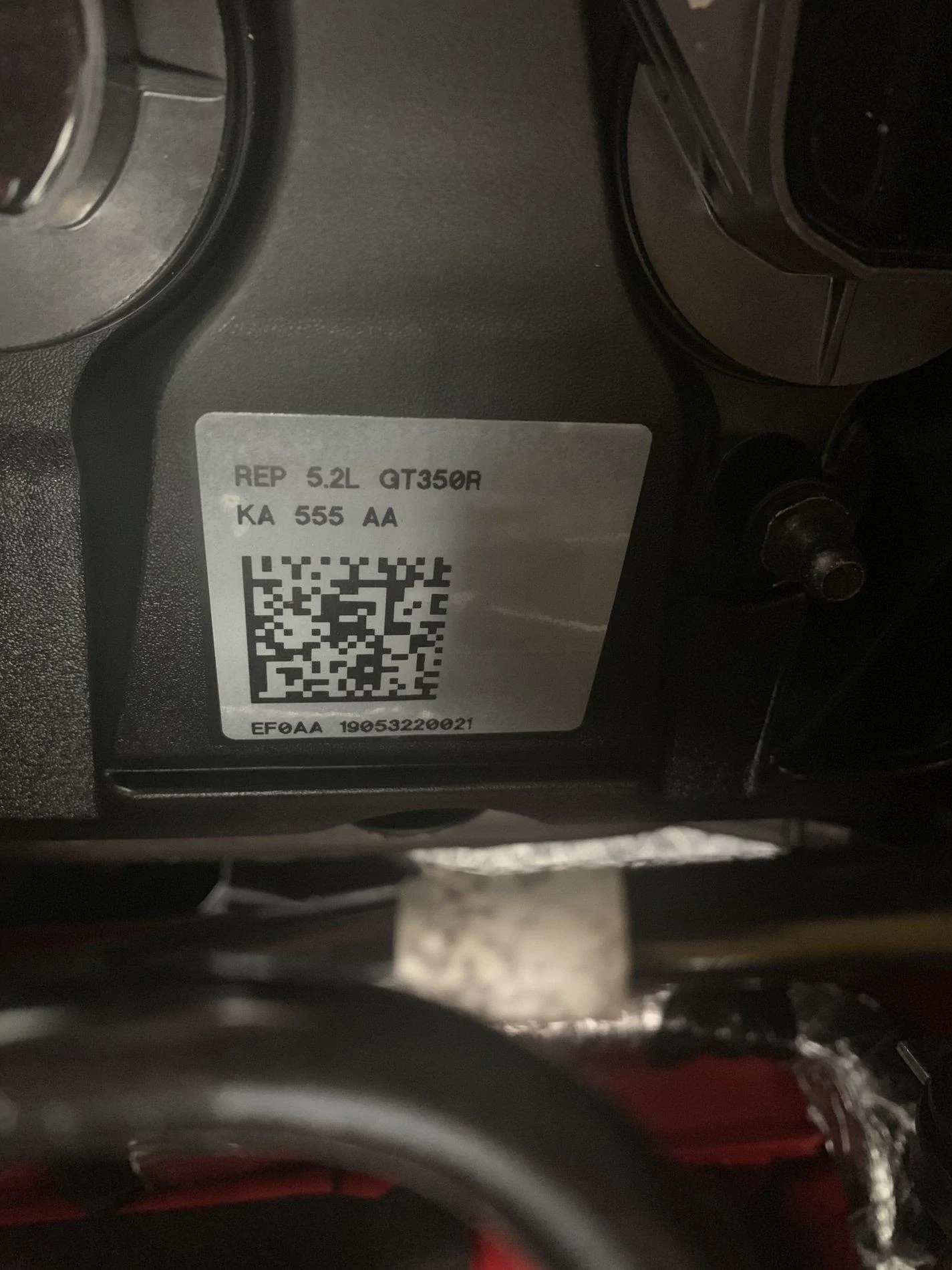

Mine says “REP 5.2L GT350R KA 555 AA” on the top and “EF0AA 19126220023” on the bottom.
The build date from the driver’s side door sticker: “1201905237315”
So it’s the 23rd(!) engine built on 5/23? It was the only thing between the builder and the long weekend. Hope the builder was focused.
sox3
Jun 2, 2019
1,205
2,049
Newark, Delaware
George
2019 GT 350 Performance Blue
If I remember correctly it was the 23 engine built on the 120th day ( May 6th). Im sure someone will correct me if Im wrong.
