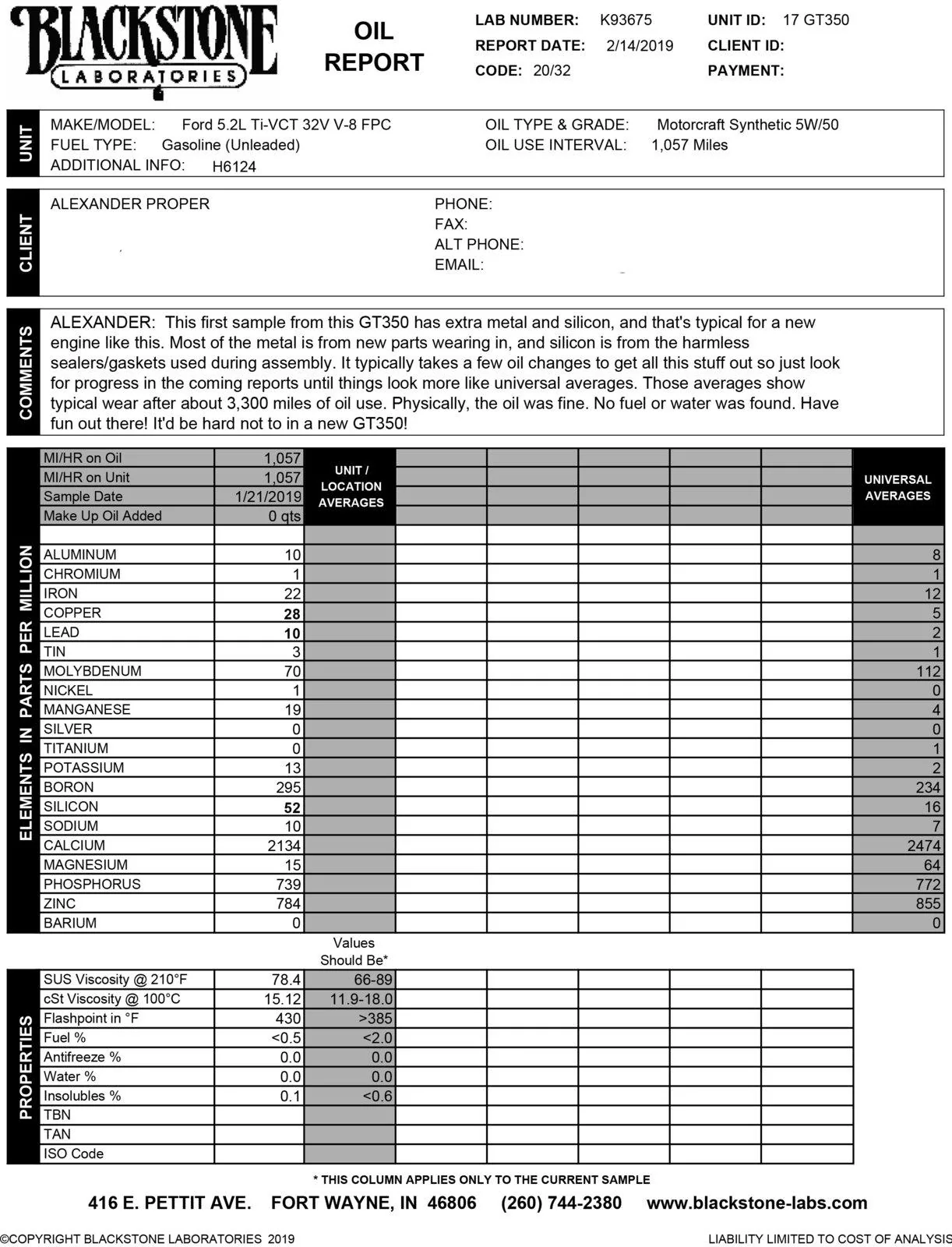

Changed my Factory Fill at 1,057 miles to AMSOIL 5w50 Signature Series with an AMSOIL Ea Filter. I plan on changing the oil at 10,000 miles and sending it in to Blackstone for a Oil Analysis + TBN to start extending the OCI.

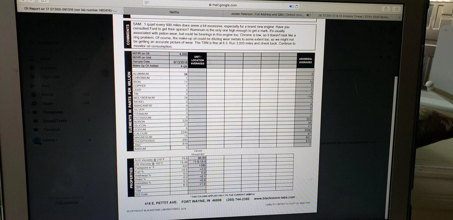

This was my analysys when the car first started using oil. Ford replaced the engine a couple months later after the car was using more than 2 quarts every fillup.

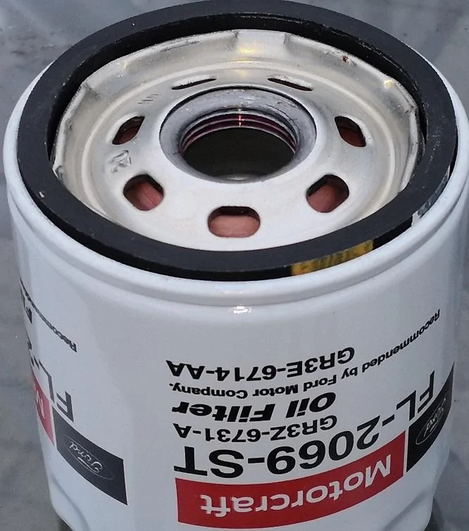

Thread locker on the oil filter or oil filter housing? I've never noticed it coming with any. Unless I'm missing something..
Look carefully at the threads in the base of the filter. They're red. That's thread locker.

Oil filter or oil filter housing threads?
I'm referring to the spin-on filter that was in production until April 2017. The threads in the center hole are red:
The red is a pre-applied thread locker. There's a company called "Vibra-Tite" that makes a compound that looks and works like the stuff in the filter, so you could probably coat your own if you wanted to use another brand.
