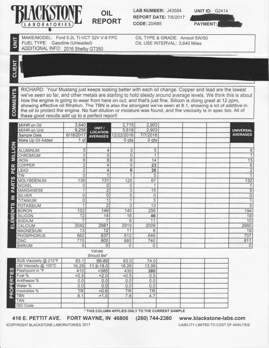

Maybe you could post your results so we can compare?
Thanks
Here ya go.
Using Amsoil since the first oil change. I did add 1 quart during the last interval. Nothing surprising or notable. My scanner needs calibrated but hope this turns out readable.
