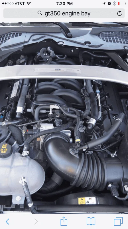

For what it's worth looking at pics of the gt350s engine bay they have the aspirator and brake booster hooked up just the same as most are installing them. The booster is hooked directly to the intake manifold on the gt350 the one port on the aspirator is capped and the T remains intact and attached to the intake tube.

One thing you would have to know to compare a GT to a GT350 is why Ford uses a different brake booster for the GT than they did for a GT350. Both boosters show a check valve at the booster so you will likely not see much of a difference by using the 2nd port and connecting the brake booster line directly to it but the stock GT was not setup that way. In theory the aspirator will supply a more consistent vac signal than a connection directly to the manifold as a vac source.
The T connection is not the important part of the vac system, the GT350 cold air intake only has the drivers side port and that is why the two return vac lines are T connected to that single port, the GT has two ports, you can leave them T connected and plug the other port or split them into two connections. It really does not matter just do what you think looks better as the two setups will function the same.
Without knowing what is different I just prefer to see the GT vac system to remain as close to the original way it was designed as possible. Now if someone does some testing and can show that there may be a benefit to using the 2nd port as the brake boost vac source I am willing to make the change. Since my car is a dedicated road course track car brakes are very important to me.

3) 09JSW's installation is totally fine for vacuum routing. Dozier, your installation also works but is not the same installation as intended by Ford on the GT350 so I would promote that with a level of caution. It might be great, but not the same as on the GT350. Meaning, the GT350 pulls brake boost from the manifold plenum not the aspirator.
The benefit you might achieve is possibly more consistent brake vacuum, at the expense of possibly some of the vacuum created by the aspirator being "used" by the brakes which could slow your CMCV response time - probably not a big deal, but there is a tradeoff that you are making that Ford did not intend.
