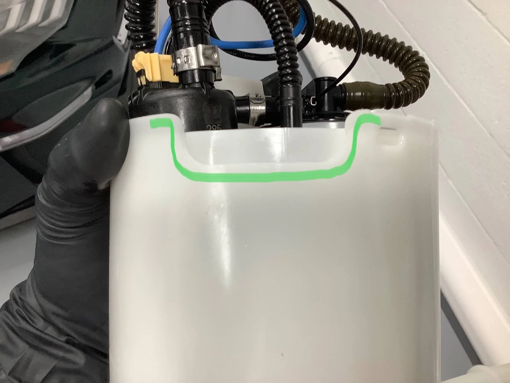

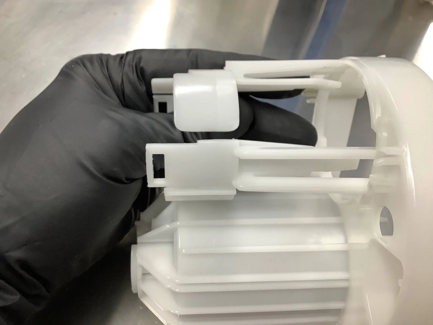

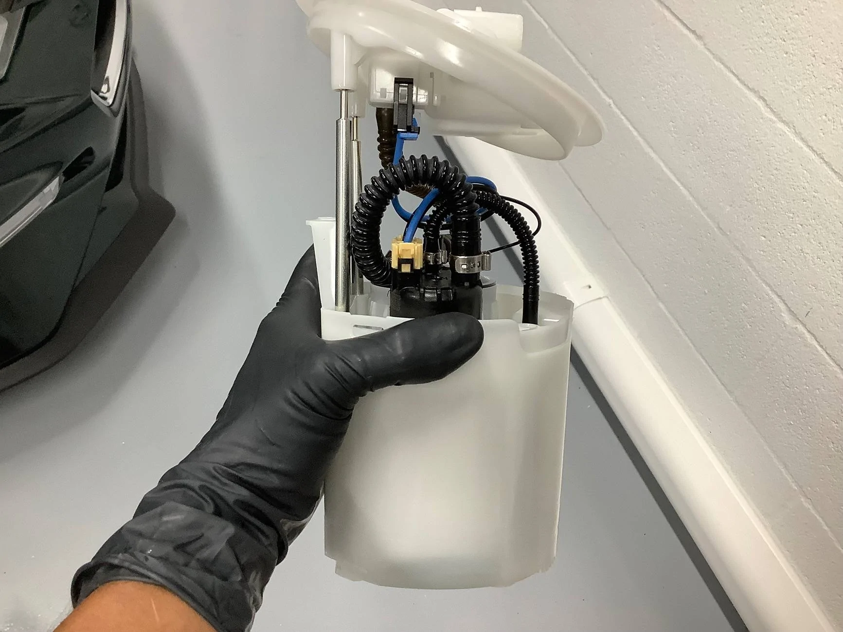

Was it a pain in the ass? Guessing I’m going to have to trim some of the basket for the larger pumps. Wonder if the stock pump modules would work?
NGOT8R
Jul 19, 2020
154
9,323
7,822
Adrian
2019 Bullitt
No it wasn’t. It was fairly simple and I was very analytical about it I even modified my basket (see green highlighted area) to clear my ear clamp pliers which are used to clamp the lines onto the fittings.
In the first pic you can see where I cut the pump holder and rounded the corners. I did some other trimming as well using a Dremel. Not hard at all. Once you start, you’ll see exactly where you need to take away material to make the pump fit properly. All of the rounding of corners and basket modification probably were t necessary, but my OCD made me do it that way, lol.
