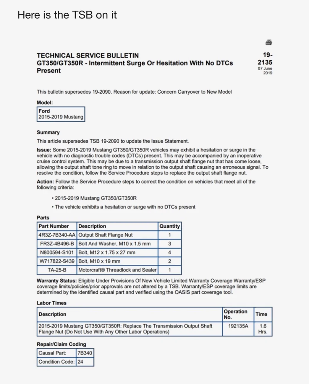

Update to this turns out one of my fuel pumps was indeed dead. But I had more than one issue going on. After replacing the pump fuel pressure was good and the car was happy but still jerking bad. Really bad! Also weirdly my cruise control didn’t work. After doing some research into this I discovered a TSB about the output flange nut loosening slightly allowing the output shaft tone ring to move in relation to the output shaft causing an erroneous signal without triggering any DTCs. The fix for this is to replace the output shaft flange nut along with the driveshaft bolts.

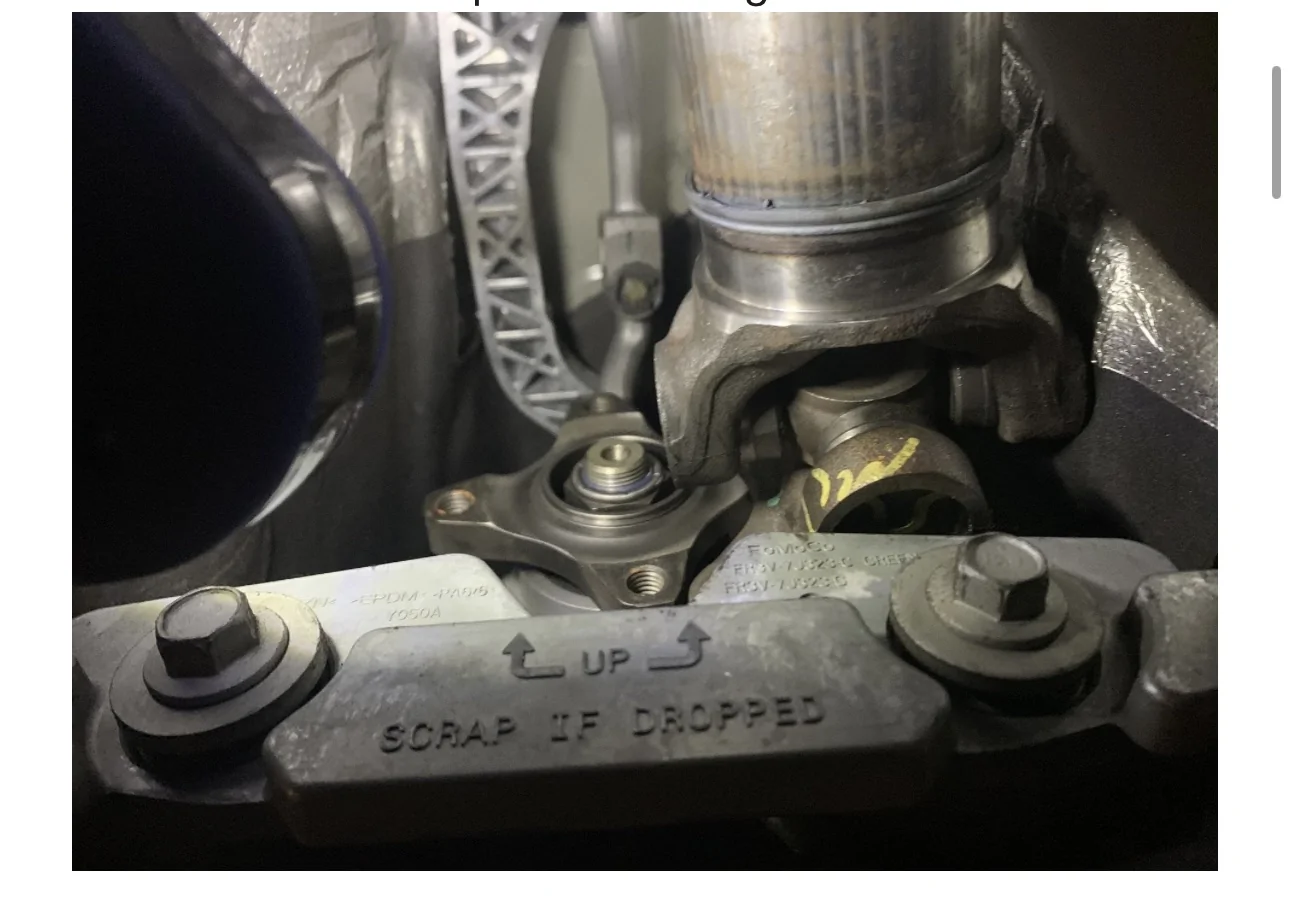

It was fairly simple I didn’t have to remove the exhaust and the driveshaft only has to be removed on the transmission side. It helps to loosen up the center support on the driveshaft to allow more movement so you can push it up and out of the way. I chose to reuse the nut and bolts instead of replacing and just used red loctite during reassembly. It worked! Runs like a clock and no more jerking.
Torque specs: flange nut 105 ft/lb 32mm socket
Drive shaft flange bolts: (12mm 12 point socket)
I tightened in two increments 45 ft/lb then 75 ft/lb in an X pattern.
hopefully this helps someone.
