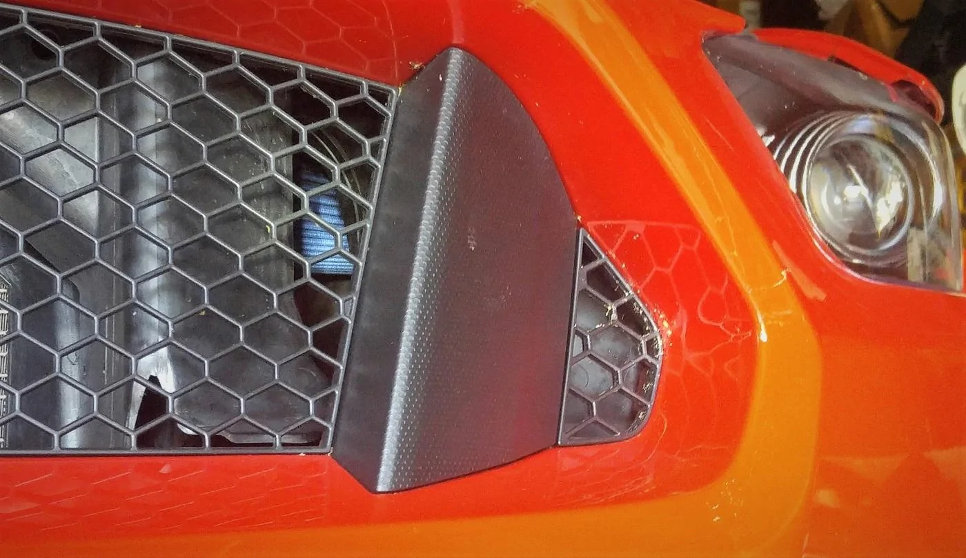

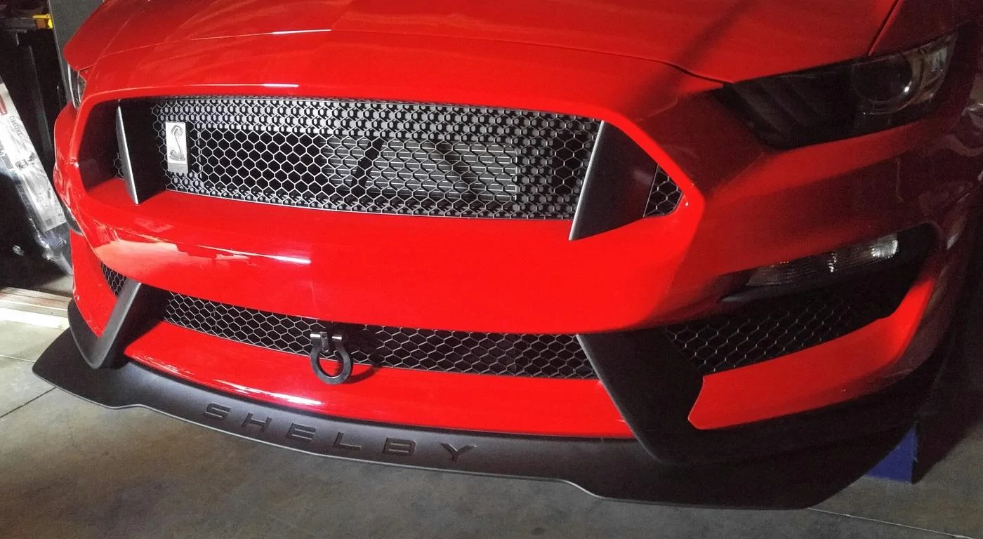

I'm also wondering if anyone looked into how to possibly open the front up a bit to let in more air than just that tiny vent to the right of the grill. It seems pretty small, not sure if letting more in will help intake temps any though.

People have tried drilling some holes in the front for the intake, but Ford performance did a significant amount of research on the front end grill design so I'm not about to take to it with a drill. Remember the R intentionally had a smaller grill inlet vs the 2016-2018 GT350's specifically for aero. More grill opening isn't always better.

Make sure you take a close look at the air tunnel to the CAI filter that it is seated properly where the hard plastic meets the flexible rubber boot. Ours was not seated during assembly line & it did remove some area for air flow. HTH
