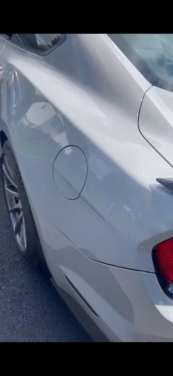

Hi all, I have a deposit down on an Avalanche gray GT350 ~11k miles on the car. It has some bumper sag from a video I got from the owner. Is this something I can fix by taking the rear light out, and placing two screws into the black plastic underneath? Seems like a crude fix, but I’m seeing positive reports from doing so.

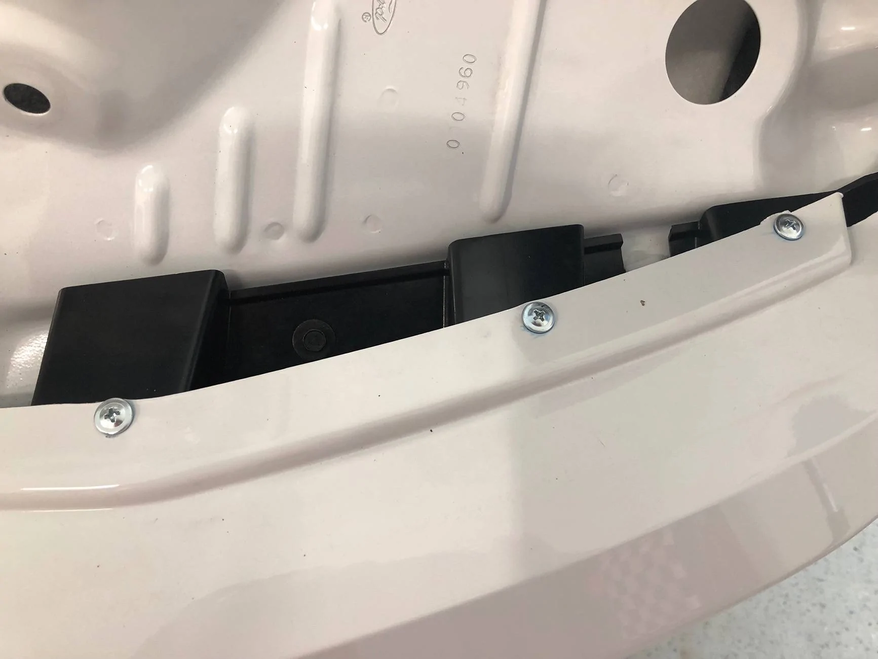

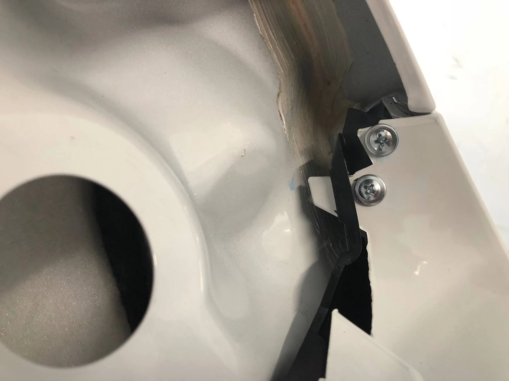

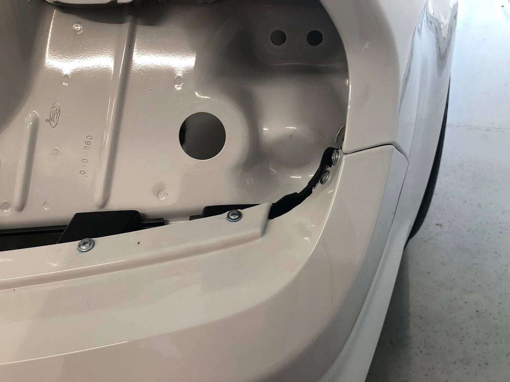

I used a floor jack to hold the bumper/skin back firmly in place and then drove the screws in at such an angle it pulled upwards on the skin once tight.

37,000 miles (and the BiRds from ArcheType) and going strong. Works like a champ. Zero regrets.
Great! Your post was what inspired my thoughts on doing it. Probably be one of the first “mods” I’ll do to the car. Unfortunately white/avalanche show this Ford defect really easily. Glad to hear it is holding up well.
Those two screws on the outside don’t show when you place the rear light back in I’d assume?

Galaxy’s tech screws work well. The one thing I would add(literally did this in my shop for decades with bumper covers) is use either the inexpensive speaker screw clips that come with every set or the better oem style on the back side. It will never move if its done this way. You can actually clamp it to tight with this method if your not carefull.
