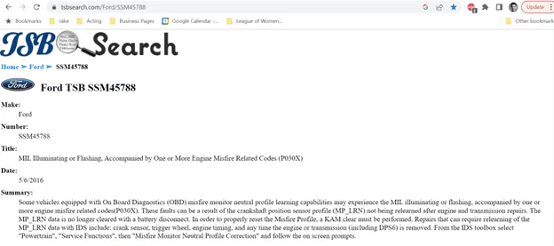

Bottom line: super easy fix, just have to know about the “misfire monitor neutral profile correction” process and send them this doc/insist that your mechanic hook his scanner up and run it, even if he’s understandably skeptical because he’s never heard of it.

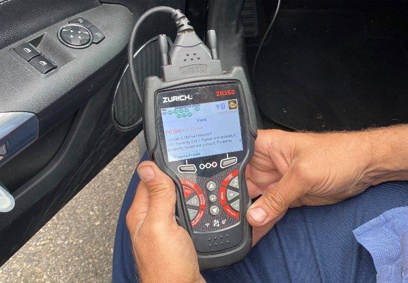

Went to mechanic. Hooked up scanner #1 (Zurich ZR15S)
I took a picture of the code: P0304 (meaning cylinder misfire in 4th cylinder) to look up later even though mechanic told me not to worry about it.
I looked it up and seemed like it was potentially pretty dangerous

See official ford technical service bulletin (TSB) outlining the problem:

Been 2k+ miles and running like a top now, no check engine light has come back, and the car is running great. Note: for a few hundred miles (about 500 or so) after clutch and flywheel replacement, there was slight shudder (nowhere even near what it was like when I first brought it in) in shifting out of first and reverse. However, have read others experienced the same break in period post clutch and flywheel replacement, and shudder went away completely by 1k miles.
Turns out then whenever transmission is removed from engine, the computers inside the car need to be recalibrated.
