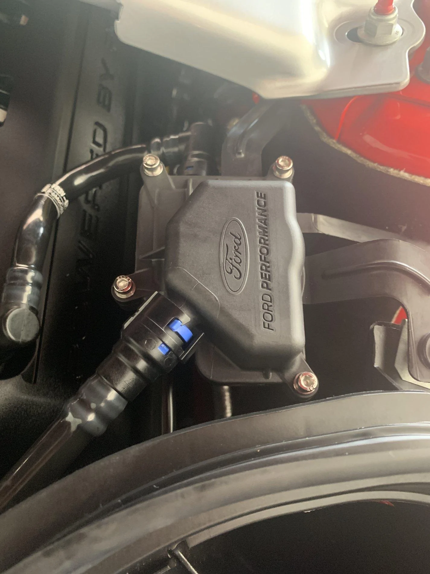

I have the passenger side FP separator and it does collect oil. Not a ton, but enough that I think it is worthwhile and doing it's job.

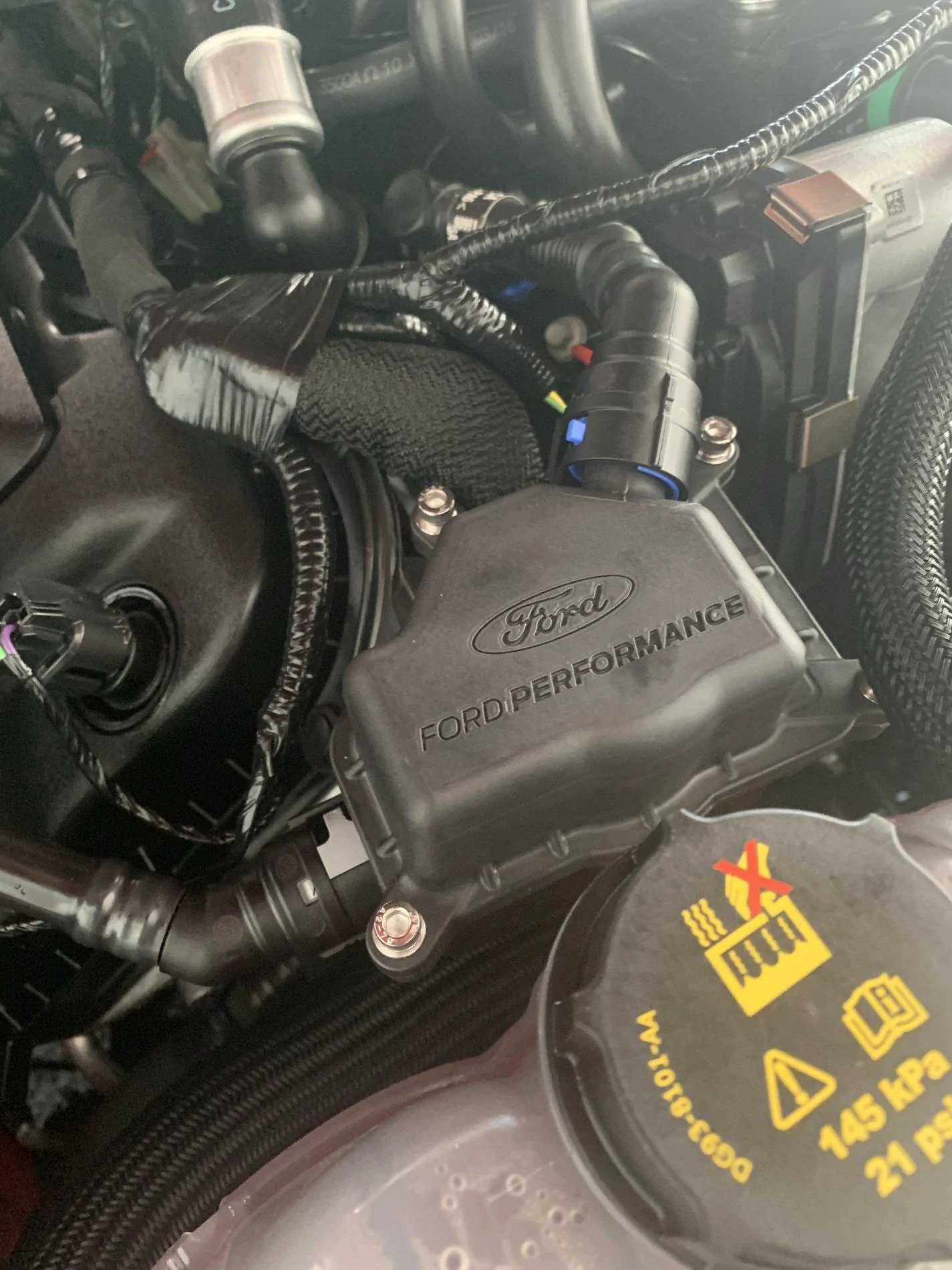

I have it on both sides, mainly because it’s recommended in the owners manual if you track the car.
THANK YOU. Awesome pictures. very helpful.
