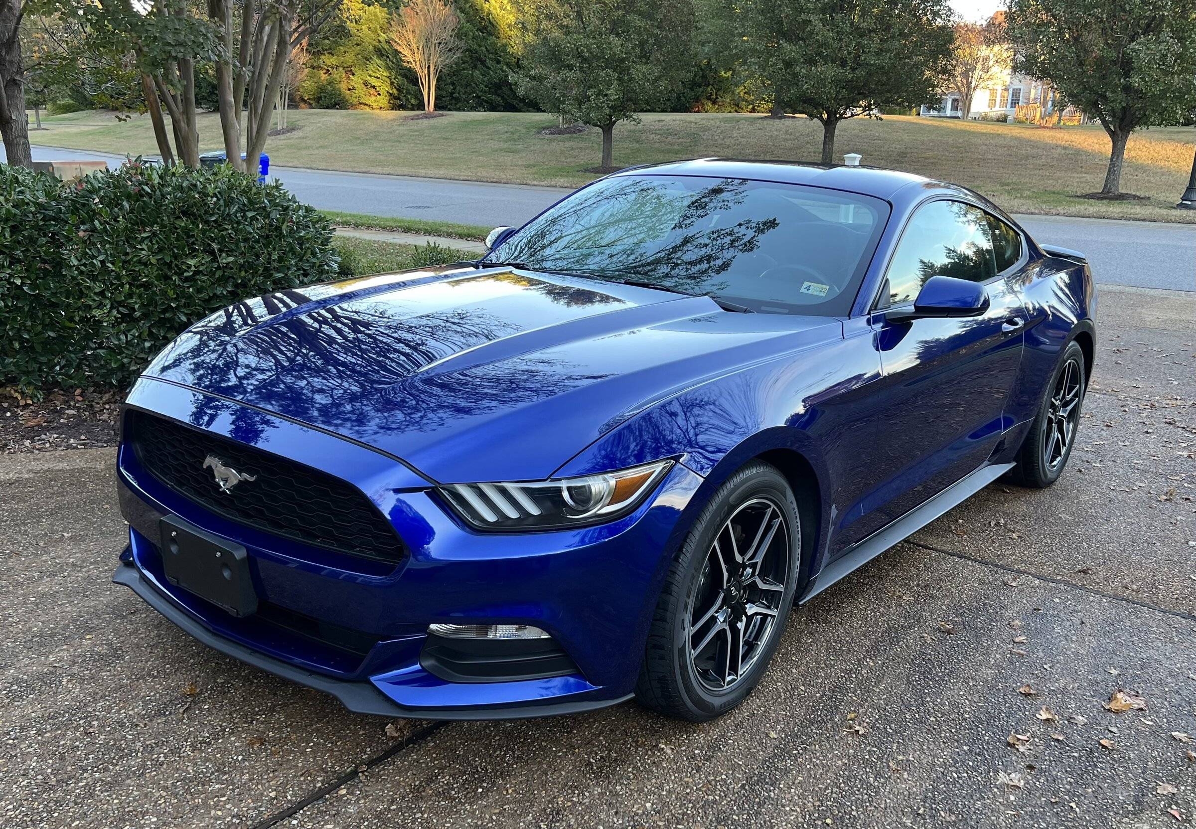

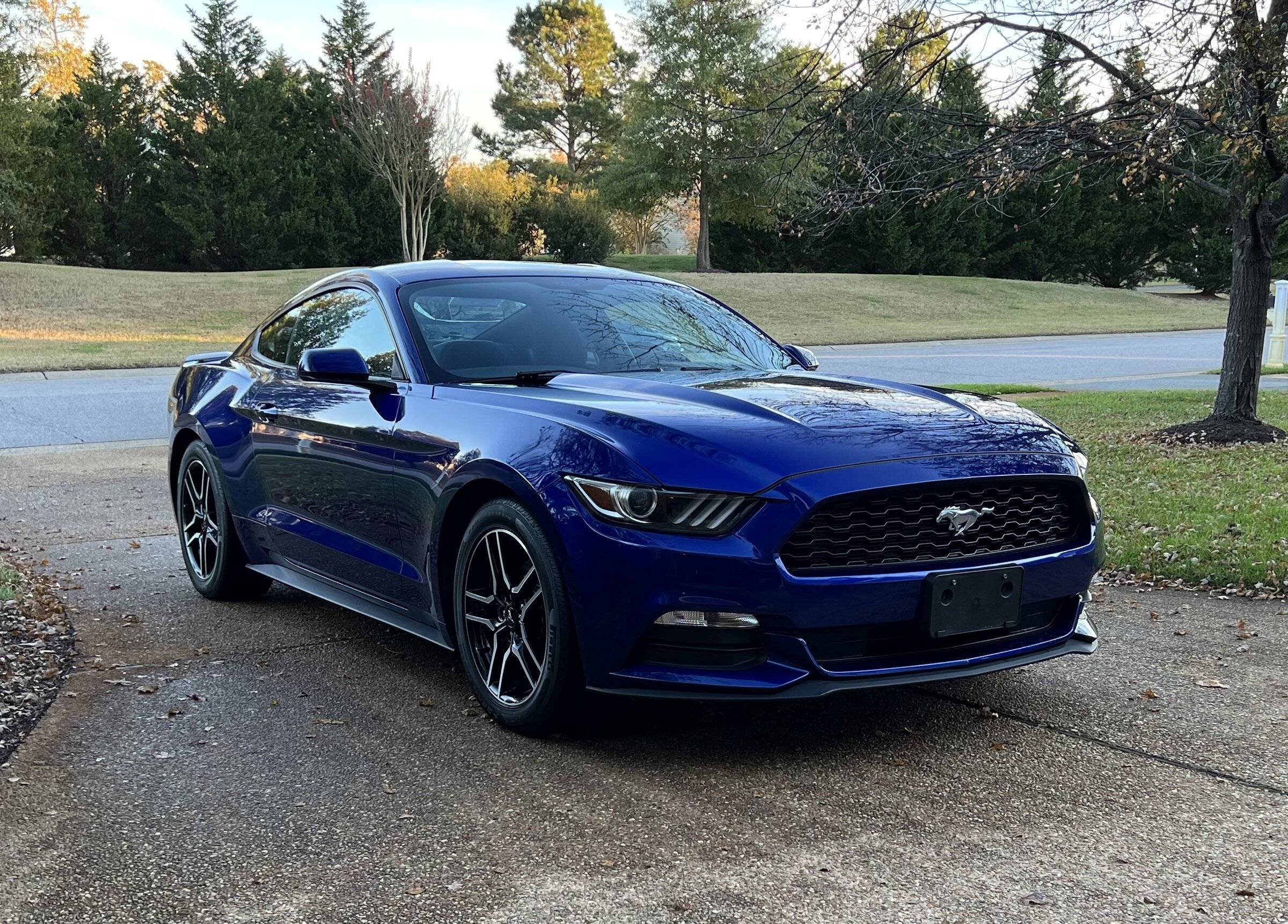

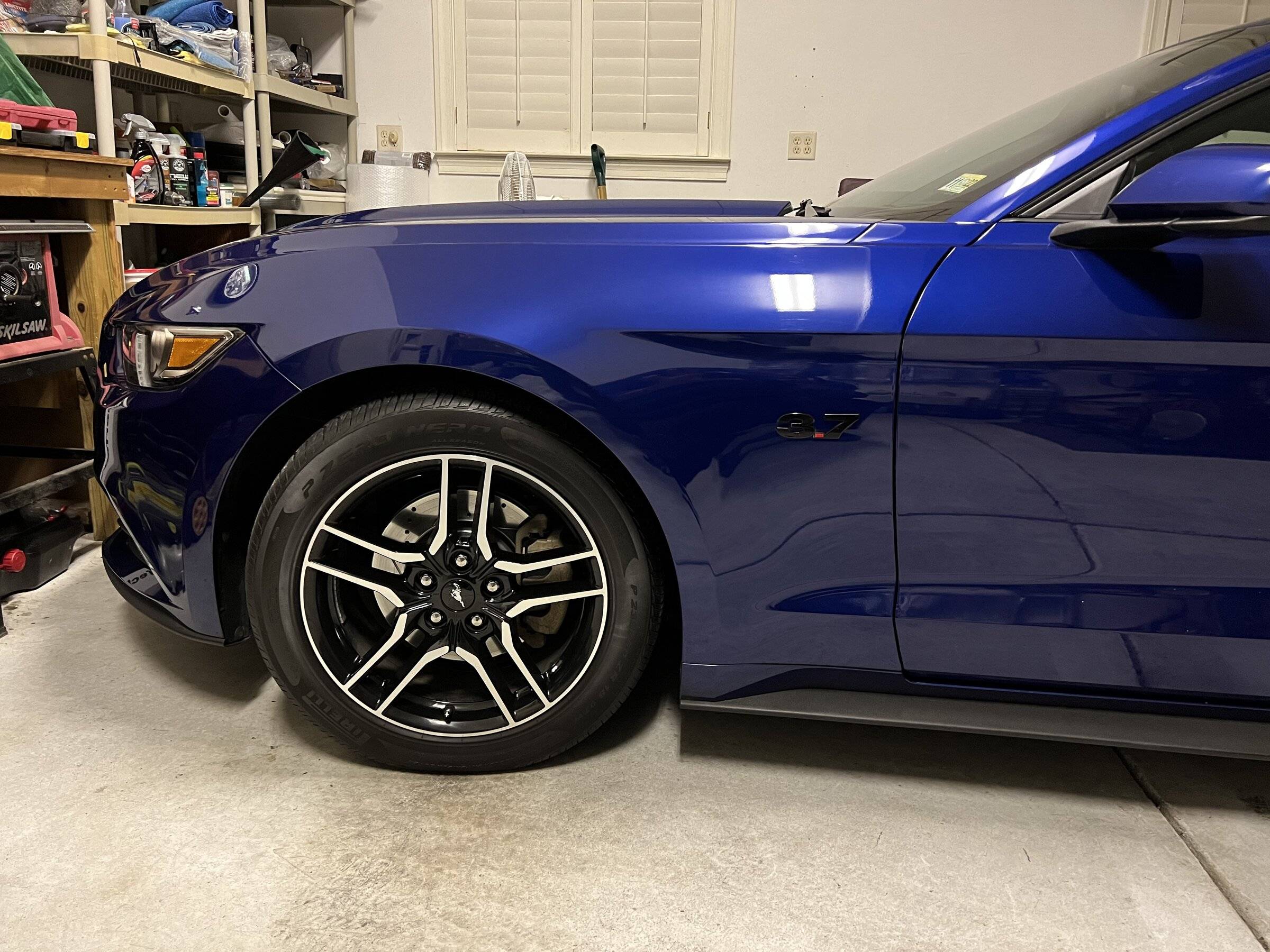

I bought new axle nuts and torqued them to spec and added blue locktite. The wheels are new 18" base wheels from a 2020 car so I don't think they are rubbing but I will check. I'm running out of things to replace. There is nothing special about the car (pictures below) other than I got from Copart salvage auction so I'm wondering if the salvage yard forklifts did any damage. I haven't had this problem before, this is my 3rd car (2nd Mustang) from the auction.
