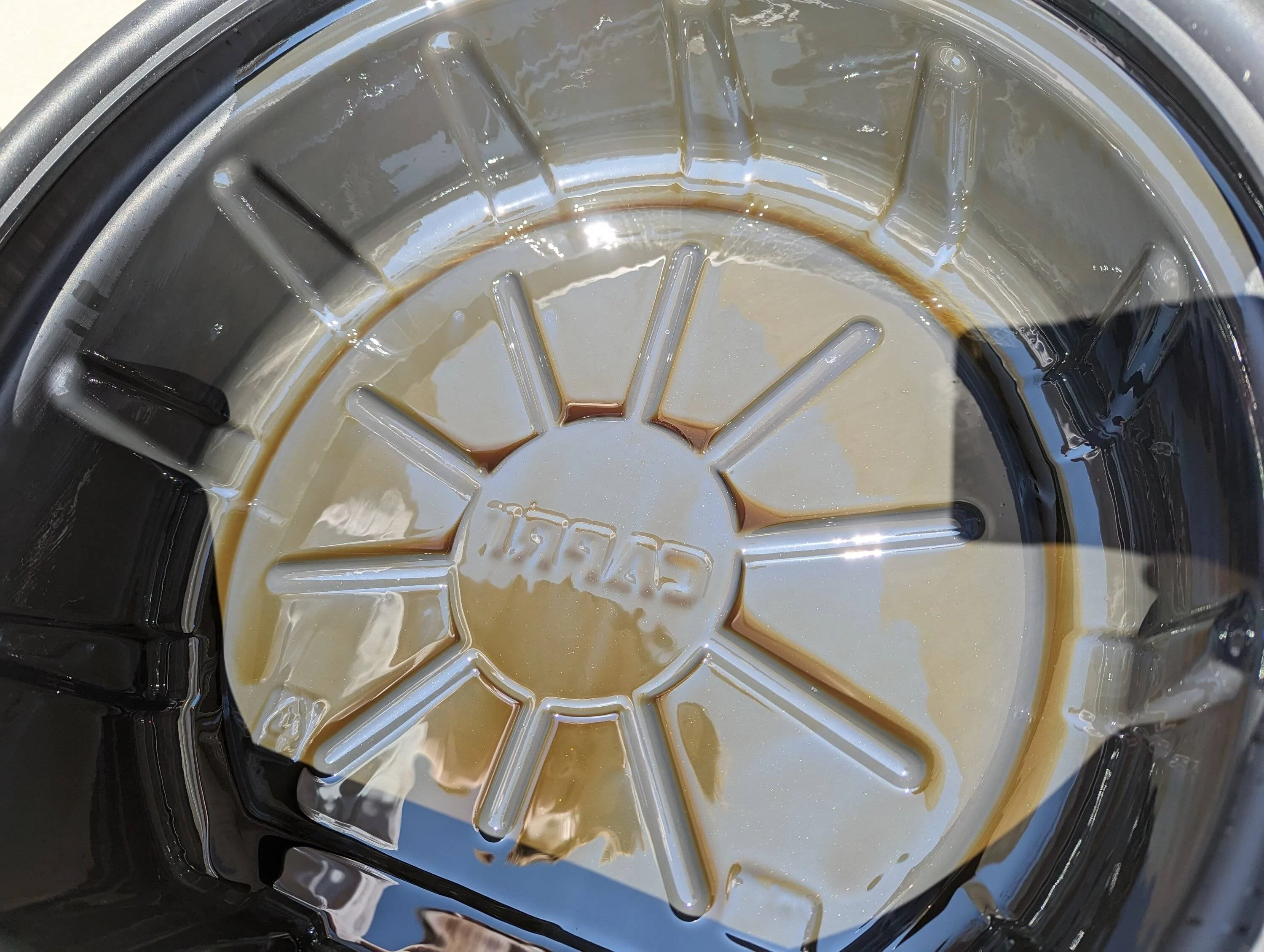

Hi,
I have a 2021 GT and I did my second oil change a couple weeks ago and saw some tiny gold sparkles in the bottom of my oil drain pan. The car has 5,000 miles on it and was parked all winter. I did the oil change in the garage before starting the car.
I put a picture of the sparkling oil below, you can see some sparkles near the center of the drain pan. I could only see the sparkles in the sunlight. Are these sparkles normal for a relatively new engine? Or could it be something separating out of the oil because it sat for 5 months over the winter?
I'm just trying to figure out if this is something I should worry about.
Thanks,
Ashton

Thats not glitter, that looks like metal. Definitely not normal. I would be taking that in to get diagnosed.
Can you take a close picture of it?

Mine had the same metallic material at my first oil change at 220 miles. I was so shocked that I did another change at 600 miles and all was good. I think it must have been break in material from the plasma transfer lining process. Anyway, 16K on the motor, no ticking or oil consumption, and a nice clean FP catch can in place.

Honestly I wouldn't worry about it. There is a good bit of wear in material what will show up n your first and maybe second oil change. This is normal and expected. Now if by your third oil change or you start to burn oil then I would bring it in. Just take pictures and document this just in case something develops.
This is why I changed my oil at 1000 miles and again at 5000.

When people say it is normal to see some metal flakes in the first oil change it’s a just a pinch that was missed after cleaning the block after milling, and it’s in the oil filter.
That is an alarming amount of material in your oil. Something is wrong. Send a sample to black stone labs and find out what it is. I would be preparing for a warranty claim.

No that's actually pretty normal, especially since his model year coyote has the plasma treated cylinder walls. This is supposed to wear down to help seat the piston rings together. I would begin to be worried if this happens again on the third oil change. Again, check the filter for larger pieces, if this occurs I would get worried.

You’re okay. Low mileage cars have that in the first couple oil changes. Usually break in period oil changes show a lot more.

I wonder if the car sitting for five months over the winter let all the particles settle to the bottom and made it look worse than it would have if I had drained the oil when I was driving it more regularly.
I'm thinking I'll look into getting the Blackstone Labs analysis
