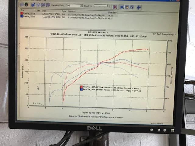

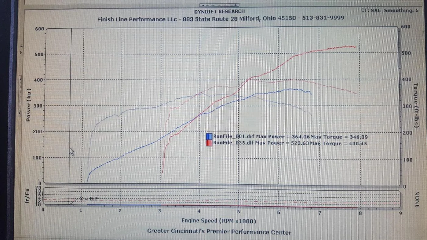

I have comparisons of stock vs. CJ and 430whp vs CJ.... What shows losses and gains... maybe this will help you guys.....

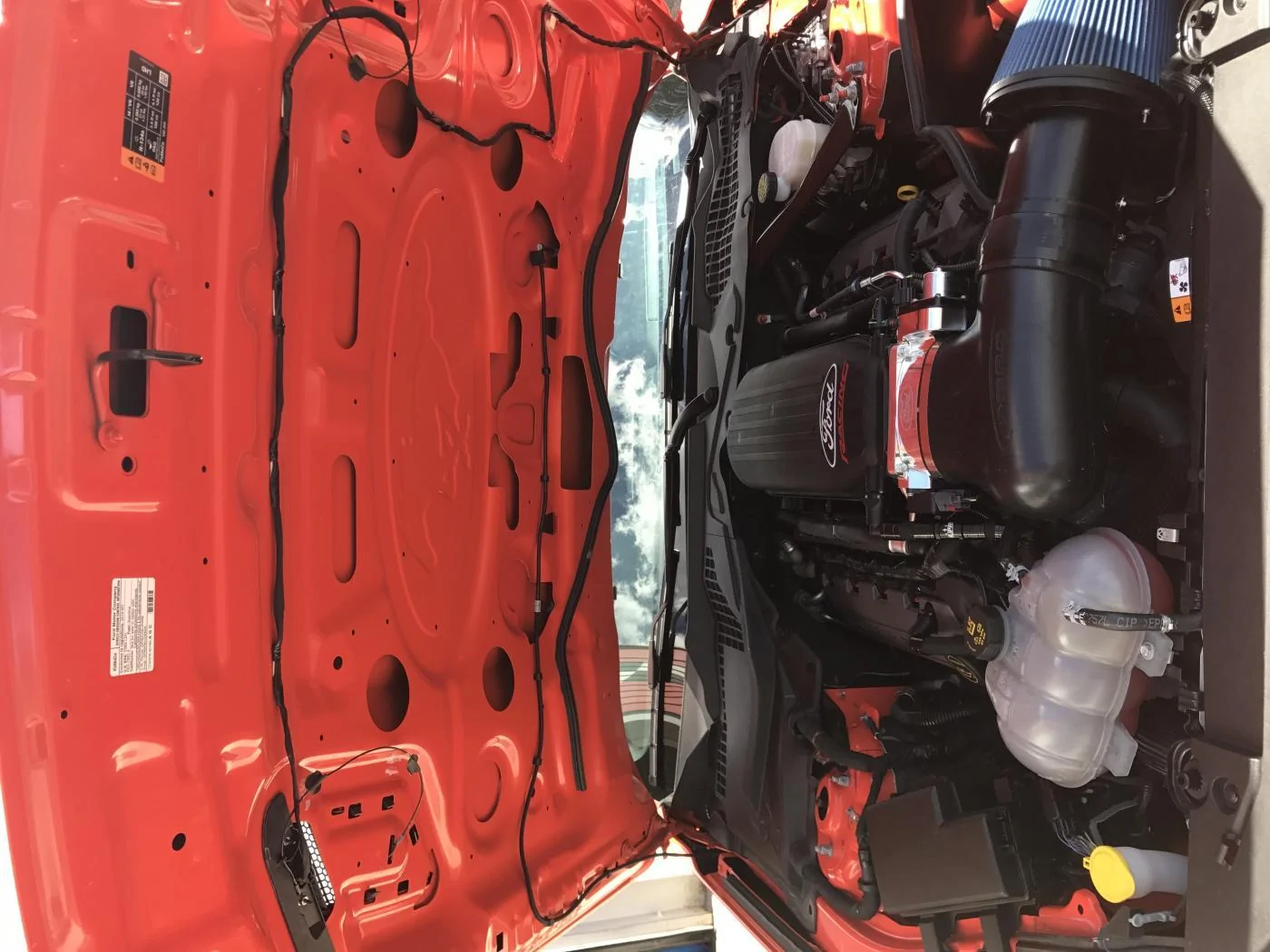

This is a picture of the hood "modification"
I really like how that looks. Out of curiosity, are you keeping the hood liner off because it doesn't fit or you don't want to put it back on? With the exception of the Ford Racing logos and the hood line, you can almost say that looks factory. Damn fine job sir.

I was told it wouldn't fit.....
