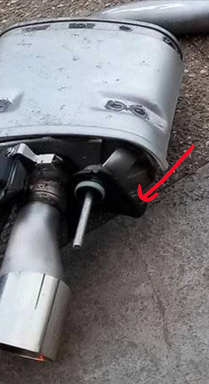

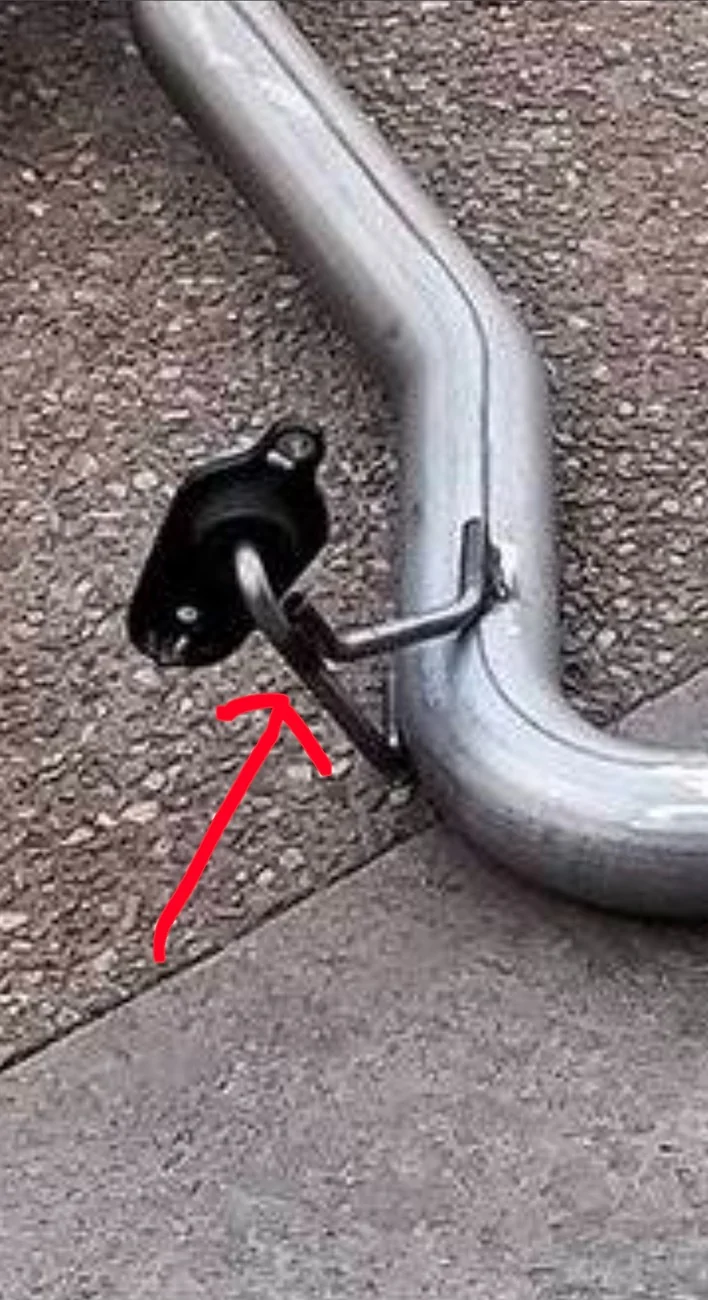

But it's prob, the welds that hold all the hangers onto the muffler pipes. I've also had one of those crack. Specifically the one by the rear differential. It's hard to even see unless you get it on a lift and remove the rear plastic pan. Then you have to really get in there and push on the exhaust to see the crack open, or start it with eyes on it.
Here's a Pic of where mine cracked. It would make a really bad noise on start up and while revving, not not at idle. I re-welded it and it was all good.

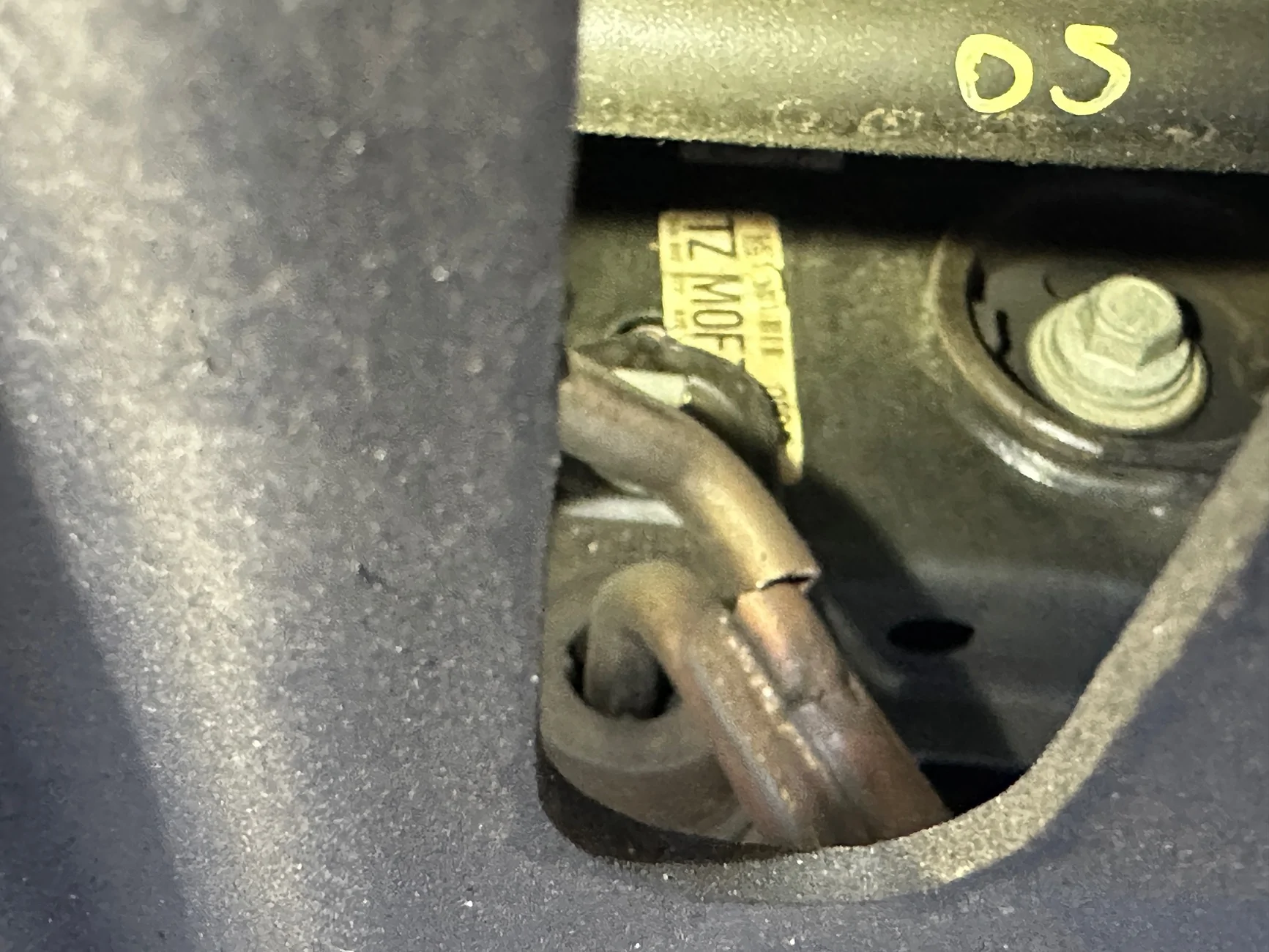

Well, that didn’t take long. Put her up on the 4 post and located rattle with a rubber mallet. Looks like the same place as your second pic @TonyNJ. This is a brace tube about as thin as a Coors can that connects left and right exhausts just fwd of the rear sway bar at the hanger. This is looking fwd just right of centerline thru rear tray.
I just bent it up about an eighth for the near term.
Welding Coors cans together above my pay grade. May just leave it but guessing it’ll find the next weak point and break there. Got a buddy who can knock it out.
Thanks again for the help.

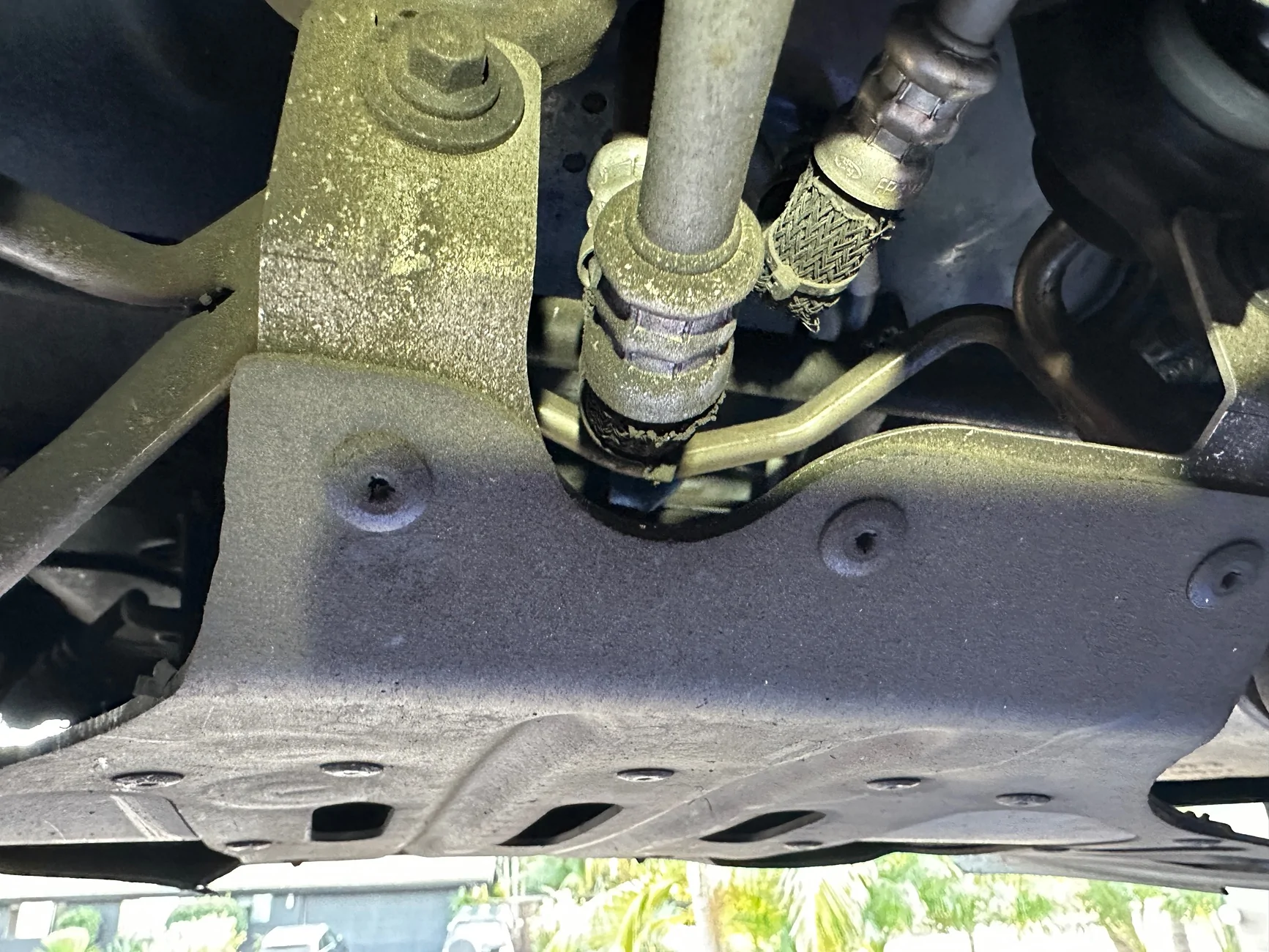

Looking aft and you can see the tubing that connects l/r side. Crack is behind hanger on left side of the pic.

Yup. That's exactly where mine broke. I think it happened from the exhaust bottoming out on a steep driveway exit over a crest. Heard it scrape. Days later heard the noise.
FYI, before I welded mine, I temporarily jammed a piece of rubber heat resistant tubing between the crack to stop the noise. Worked like a charm until the weld repair.
