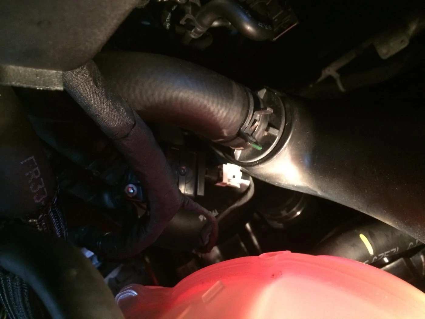

Thanks for reminding me of this, checked mine today; I had installed it back in January just under 6k miles ago. It was dry, but still sliding smoothly in the bore. But did notice the electrical connector was AGAIN rubbing on the intake pipe (see pic below); which I had loosened all the clamps and re-positioned back when I installed it.
This time I put it up on ramps and took the lower panel off so I could check tightness of the intercooler clamps thinking maybe messing the right lower clamp would help re-position better. Right side was a little loose and hose was slipped back about an 1/8" on Mishimoto intercooler pipe, so it needed to be done anyway.
Need to order a set of TUNE+ Constant Tension hose clamps !!
