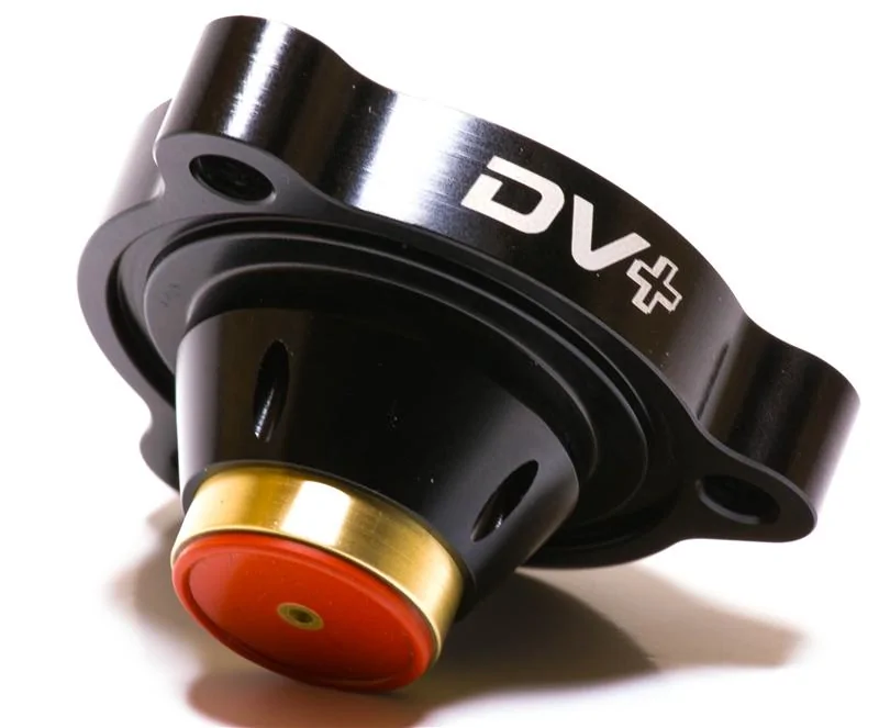

Sorry if this has been posted, but search has found nothing.
Anyone have any experience/reviews on this? It looks to be a nice upgrade to the stock stuff w/o breaking the bank. GFB made some good stuff back in my MKIV/V VW days.
GFB DV+

Never heard of it, looks like the route I'd wanna take though.

This is very interesting to me. I may order one just to see what's up with it. I'd definitely like some more info on it.

I have one installed and really can't tell any difference in power.

Honestly, I don't think that these type of upgrades add any power, they just recover potential lost power. Especially if you're pushing beyond the boundaries and capabilities of the factory components. These little things do add up though. It's about covering all the bases.

That is because you are not changing the operation in any way - still controlled directly by the ECU.
Its a "noise maker"
Did you even click the link? This is not a "noise maker". It is a diverter valve, not a blow off valve.

I wouldn't expect any difference in power unless your factory diverter is not operating smoothly and correctly. I've logged my boost and it holds well. This one just changes the operation to not be reliant on the rubber diaphram and making the piston independent. Definitely an interesting idea. Since the air is diverted in the normal manner, it isn't a noise maker, no VTA.

Nothing beats an electronically controlled BPV on these fast spooling turbos. Mechanical / vacuum operations are a thing of the olden days. What this DV+ adapter does is ensure a positive seal at any boost level, and depending on whether or not one uses the main piston spring, faster boost recovery. I have one of these installed after running the HKS SSQV for about 3 months, and I can't say that there's a noticeable difference in spool up / recovery under daily driving conditions. I do, however, enjoy the quietness aspect of this arrangement.

I've currently got a Boomba Full Recirc Bypass Valve kit on my 2016 EB so I have my stock diverter valve out.
Looking at it and the video on how to disassemble, mine looks a bit different and I don't see how it comes apart, at least ways not how they show it. Don't want to break the thing as I'm sure it is not cheap to replace.
jrock ... your car is a '16 too, so I'd guess if you got yours apart then mine should be the same. Any trick to get stock diverter valve apart that is different from video ??
Not too pleased to find this much cheaper option after buying & installing the Boomba, that is ...
* simpler to install
* simpler to return to stock
* boost assists in holding it shut (same)
* quicker performance due to it being direct acting (vs. Boomba vacuum open & boost closed via a 3-way solenoid)

Looks like a solid option to just make sure the levels requested are precise and do not waiver from an OEM plastic DV. I used this company for my VW valves as well
