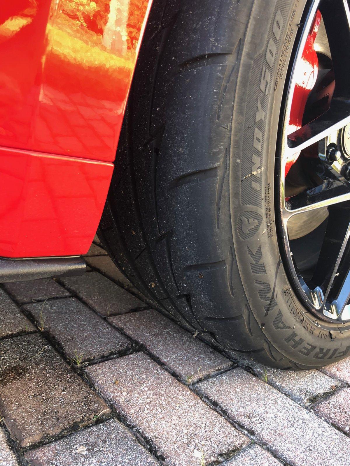

what tires do you run? i need to upgrade mines..

Once you add any power, even the 255 Pirelli's won't lay any power down. I know my Firehawk Indy 500's are damn good tires for the money. I wanted a square setup and I think 275 were the biggest I could go all the way around. I wanted to rotate my tires and didn't want any under steer from a staggered setup. A 40 series sidewall coupled with much lighter lighter wheels was also a big improvement. The stock PP wheels could be used to anchor a cruise ship.
Improved traction out of the hole can feel like a big power upgrade.
