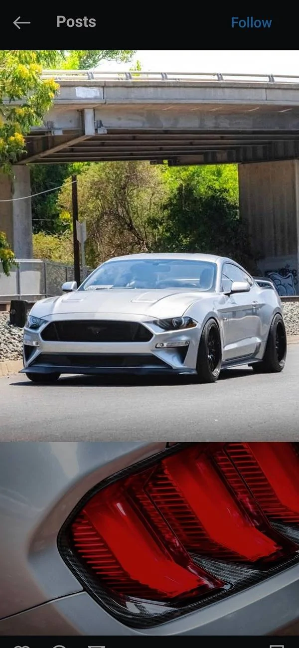

I've got a 20 pp1 iconic silver that's lowered.
It's wrapped at the moment. Photos provided
I am looking at getting 18s or 19s for my next set of wheels. I'm still on stock pp1s
Looking at anovia elders.
I want to run a square 265 set up on 18rx10.5 offset 22 black for a little stretch
They don't make that size in black so I would have to settle for a
19rx10.5 offset 22 black
Or
18rx10.5 offset 35 brushed silver.
Would the brushed silver match the silver of the car underneath the wrap? Or should I just spend the extra money and heavier wheels to get the 19s like the pp1?

I've considered removing material from the top of the brake to fit 18s, with the elders there would be approximately 1.66"(42.1mm) poke up front and 1.68"(42.7mm) poke in the rear. From the pp1s
My car already has camber to accommodate the width. It would sit a bit further than flush.
I would like to go with a flush set up or slight poke(14mm) half inch.

I'm looking at different wheel set up now, maybe 18r 10.5 +(33to35)
I want a 10.5 rim to run a square 265 set up for a little bit of stretch.

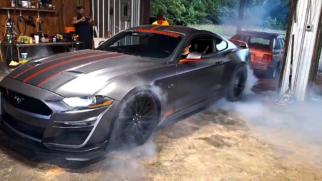

LOL. I have two separate sets of 18"x11" and they do fit just fine.

These are 265 in the rear of that bottom pic?

What offset are those? The +22 is a bit aggressive for my liking
Both sets are ET 52mm, square setup.
Both sets of wheels are Apex - SM 10 and EC-7.
Btw, taking material off brake caliper to fit aftermarket wheels is dumb.

why so narrow?
Yes it is but to get a lighter and cheaper wheel that I like it is something I am considering.
