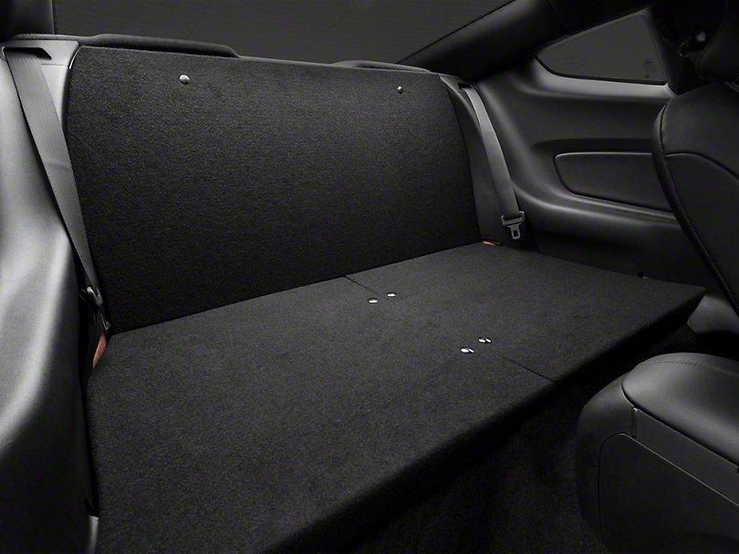

You probably want to do something like this:
https://www.americanmuscle.com/rear-seat-delete-kit-2015.html

With the seat bottoms out, the seat backs will lay flat.
To remove them run your finger along the front side and you will feel a small divot in the middle of each seat. Push in that clip and pull up, the seat will come out. It's incredibly easy.
As pointed out, because of the opening into the trunk your dog may go flying into the trunk while your driving. I would go with the rear seat delete kit shown above, or make something to cover the opening.
