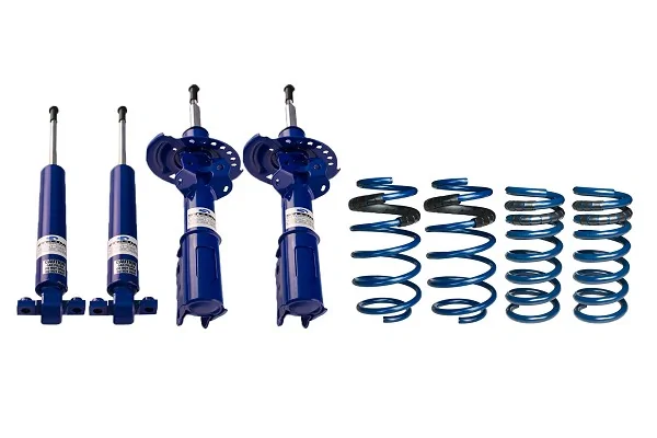

We have tested several Mono Tube Dampers and Twin Tube Dampers and found that the Mono Tube traditionally are firmer because of the high pressure design.
I would recommend our Steeda Progressive springs and our new "PUR" polyurethane foam jounce bump stops which provides a more gentle transition.This alone with our fixed valve dampers soften the ride quality considerably. The final would be our Pro-Active Dampers.
https://www.steeda.com/Steeda-S550-Mustang-Comfort-Suspension-Package-15-17-555-2422
Steeda S550 Mustang Comfort Suspension Package (2015-2020)
