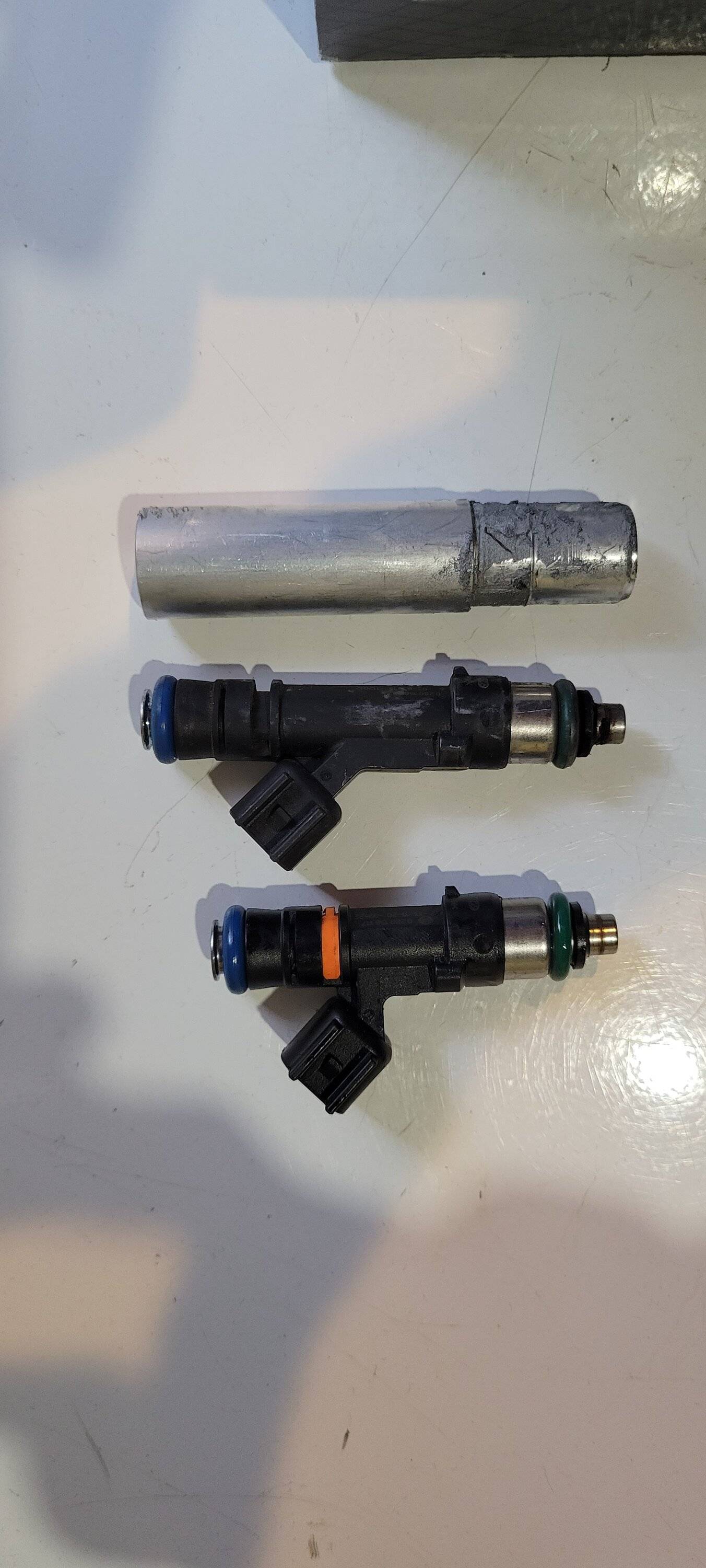

Here is a pic of my stock 2015 injectors and the ones that came with my Paxton kit. That spacer on the right is the stock one (the shorter one is on my car now).
See if there is a big size difference in yours. Also they might have given you a spacer for the actual injectors themselves to make them as tall as the stock ones, but I haven't seen that yet from them
If the new injectors are the same size (and if they are in fact the correct injectors you are supposed to get with the kit) then you can keep the stock spacers

Thanks so much. Oh god I definitely don't remember seeing anything like those. I do hope the lu47 injectors are perhaps the same size hence their omission from the kit. I've emailed beefcake see if they can confirm. 😟
