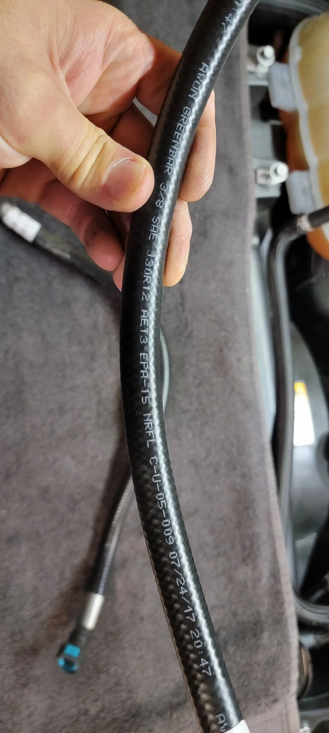

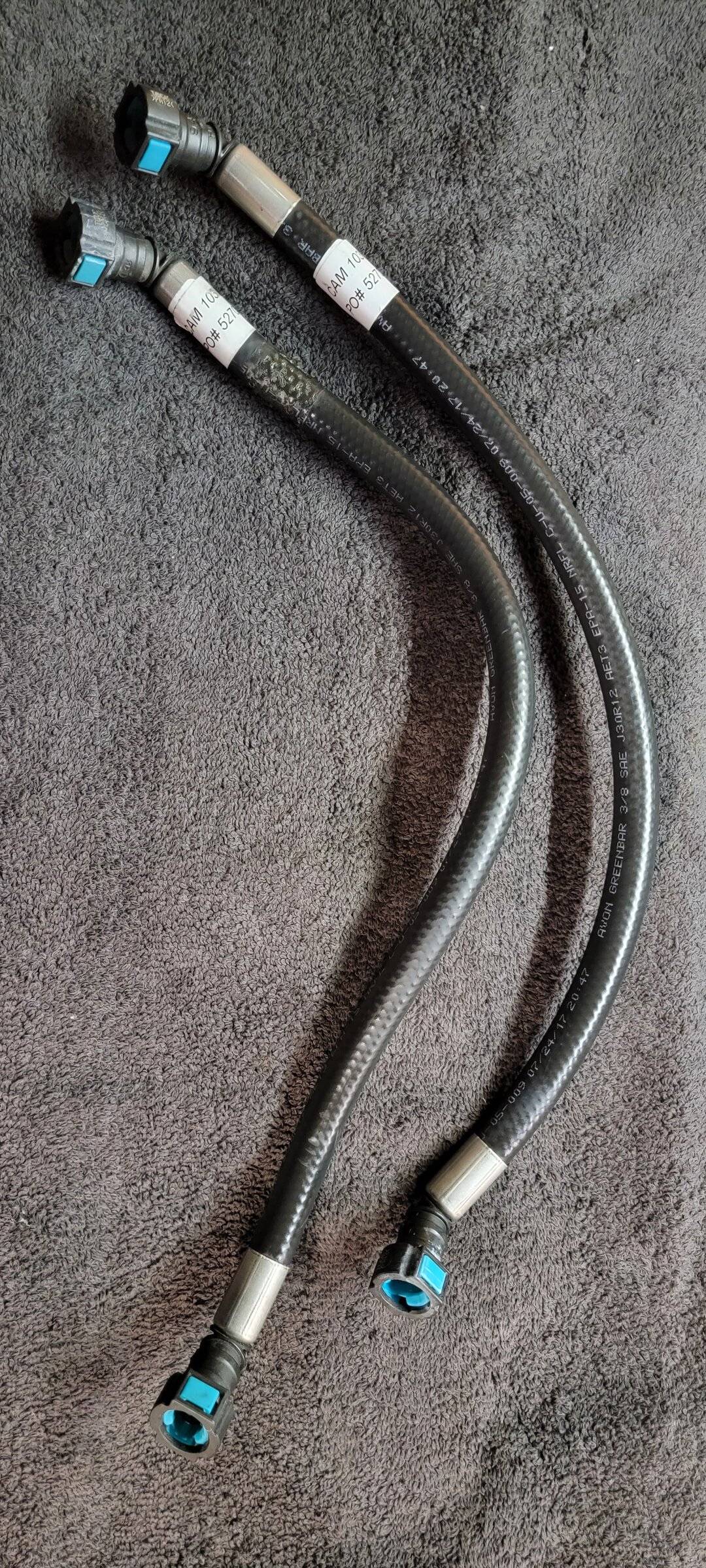

I'm currently getting the car setup to run E85, and was going to replace the rubber cross over hoses that link the Whipple fuel rails, however it looks like I will have to do some feed/inlet rearranging to use the PTFE line/fittings I wanted to originally, which got me thinking, if the existing cross over lines are compatible why replace them?
I haven't been able to find out much as of yet, but looking at the information on the hose, it appears the hose is Avon Greenbar, SAE J30R12.
I can't seem to find much on if this is going to be OK with intermittent E85 use, or not. I am awaiting a reply from Whipple, but figured i'd see if anyone has ran into this in the mean time.

Received word this morning from Whipple that the hoses are E85 rated and good to go.
Thank you @Whipple SC for awesome customer support as usual.
