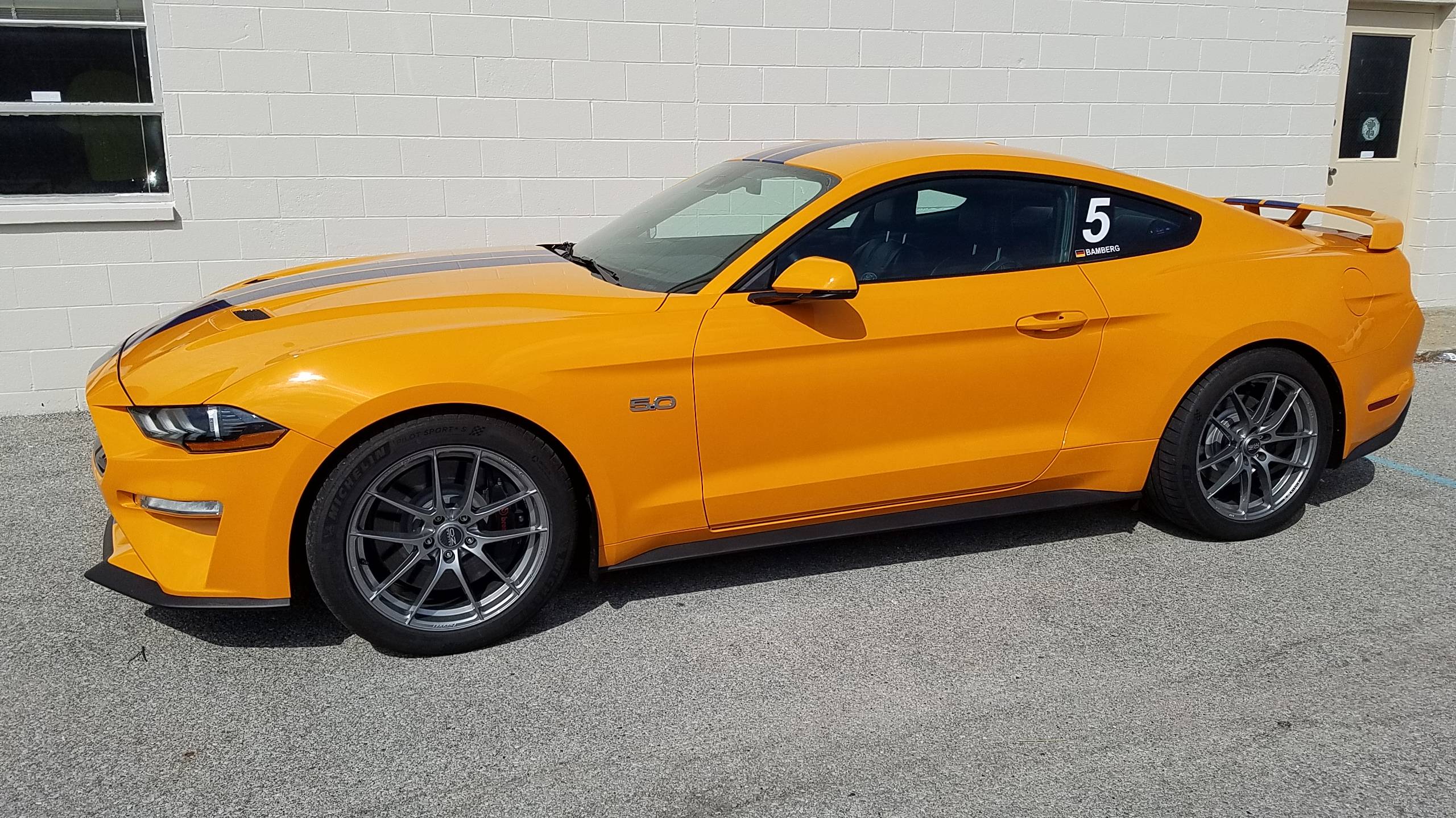

My car with another set of wheels. Enkei TY-5 in Pearl Black. (Mirror cut faces, then tinted clear topcoat.)
