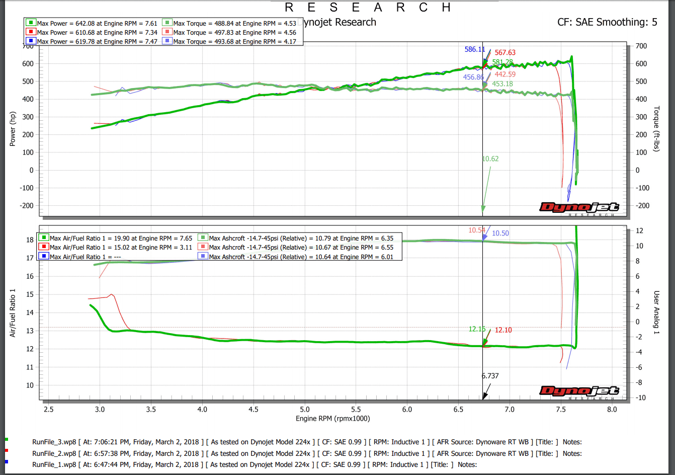

I finally went and dynoed my stage 1 gen 2 whipple. 3.75 pulley stock lower. 92 octane pump gas. Stock Cats. 4th gear pulls. Whipple's calibration. No numbers from when it was NA.
https://datazap.me/u/markmurfe/log-1520066146?log=0&data=1-5
Track should be opening soon after being closed for over two years so I don't have numbers and trap speed.

Nice numbers for 92 Oct and having cats.Not bad at all.for a stage one.

Nice! Thanks for sharing. Nice to see stage 1 numbers....

you help so many people, Nice to see your ride putting in some work. Sounds great.
Will you ever run boosters or E-blends at the track?

Not sure if you saw the data log. I was nearly at the max timing the Whipple tune gives. not sure if better octane would get much more out of it.
Ethanol would require a fuel system and me to ship it in. That's expensive. I wish I had pump E85 near me. I think I could get some sunoco race gas products locally, if I needed it. I don't have torco or boostane locally. I have tried experiments with VP octanium and Lucas 3x boosters and didn't notice much difference in knock sensor activity. Not sure if I want to waste any money shipping Torco or Boostane after those experiments.
I think of the 20 or so tanks of fuel I have run since installing my whipple, I saw one that had different knock sensor activity from what I normally see. It was only at a certain point too. 2000RPMs and .6-.7 load. Next tank it was gone. pump gas problems.

I run Boostane in almost everything, makes a large difference on our 15 Auto, Camaro DI, Hellcat....

I'm sure better octane will help, but can the calibration get me more than 22* advance?
