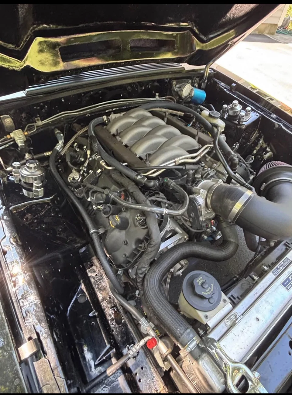

I have read plenty of information in regardes to older Gen 3 coyotes coming with heat range 7 plugs from the factory then Ford changing to heat range 6 plugs after 2021 and making it a backwards to 2018 recommendation
So what’s the consensus? Use the heat range 6 SP-589 or the heat range 7 sp-548?

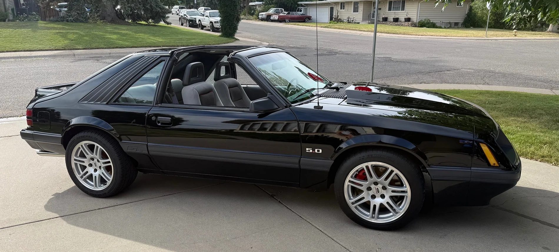

For context I purchased an 85 Mustang GT Gen 3 coyote swapped car with a CAI, IMRC lockouts, and BBK long tubes. It wasn’t tuned very well if at all. I got it tuned and just want to change the plugs for peace of mind after running the car on that crappy tune.
Obligatory pics
