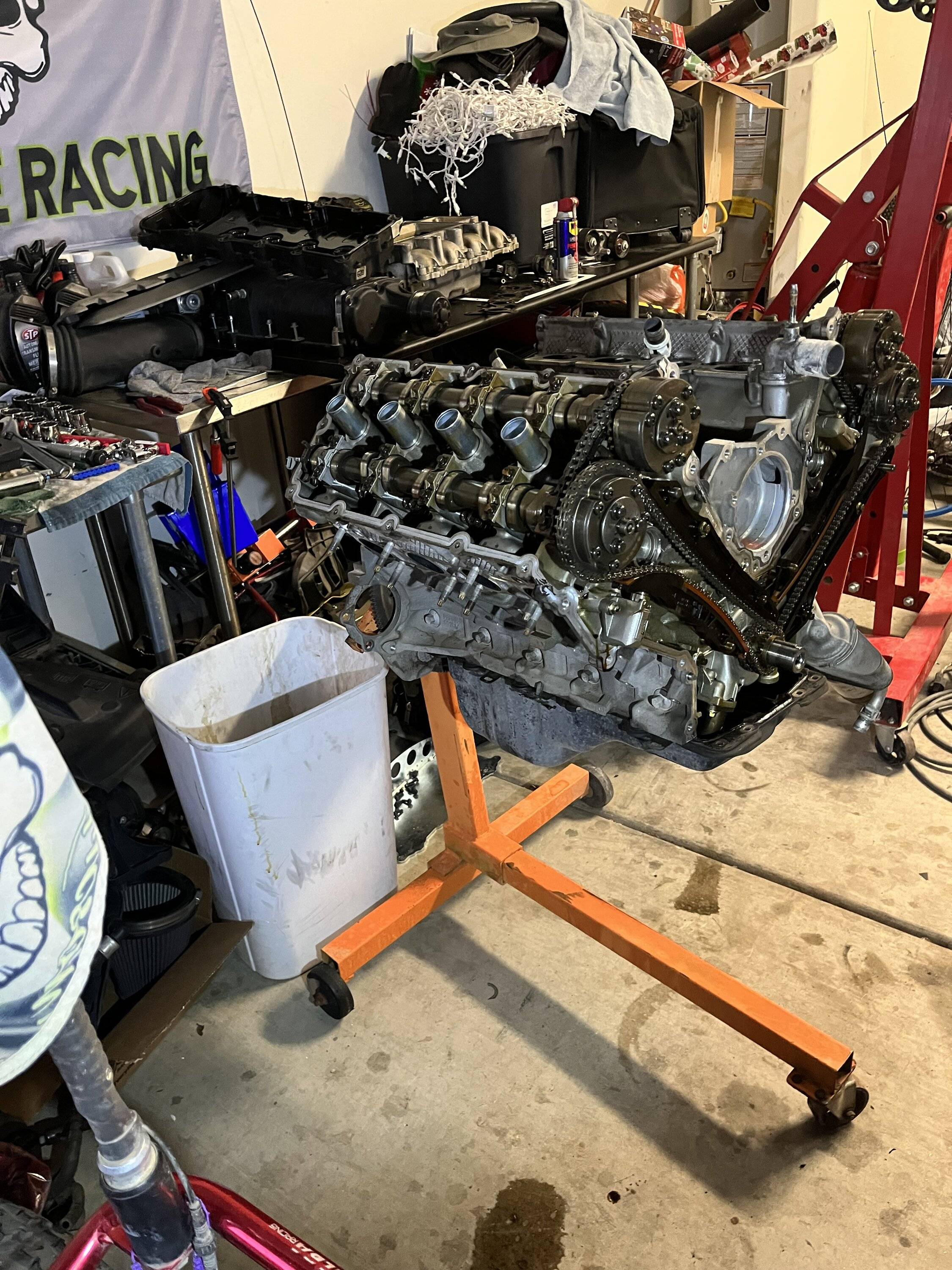

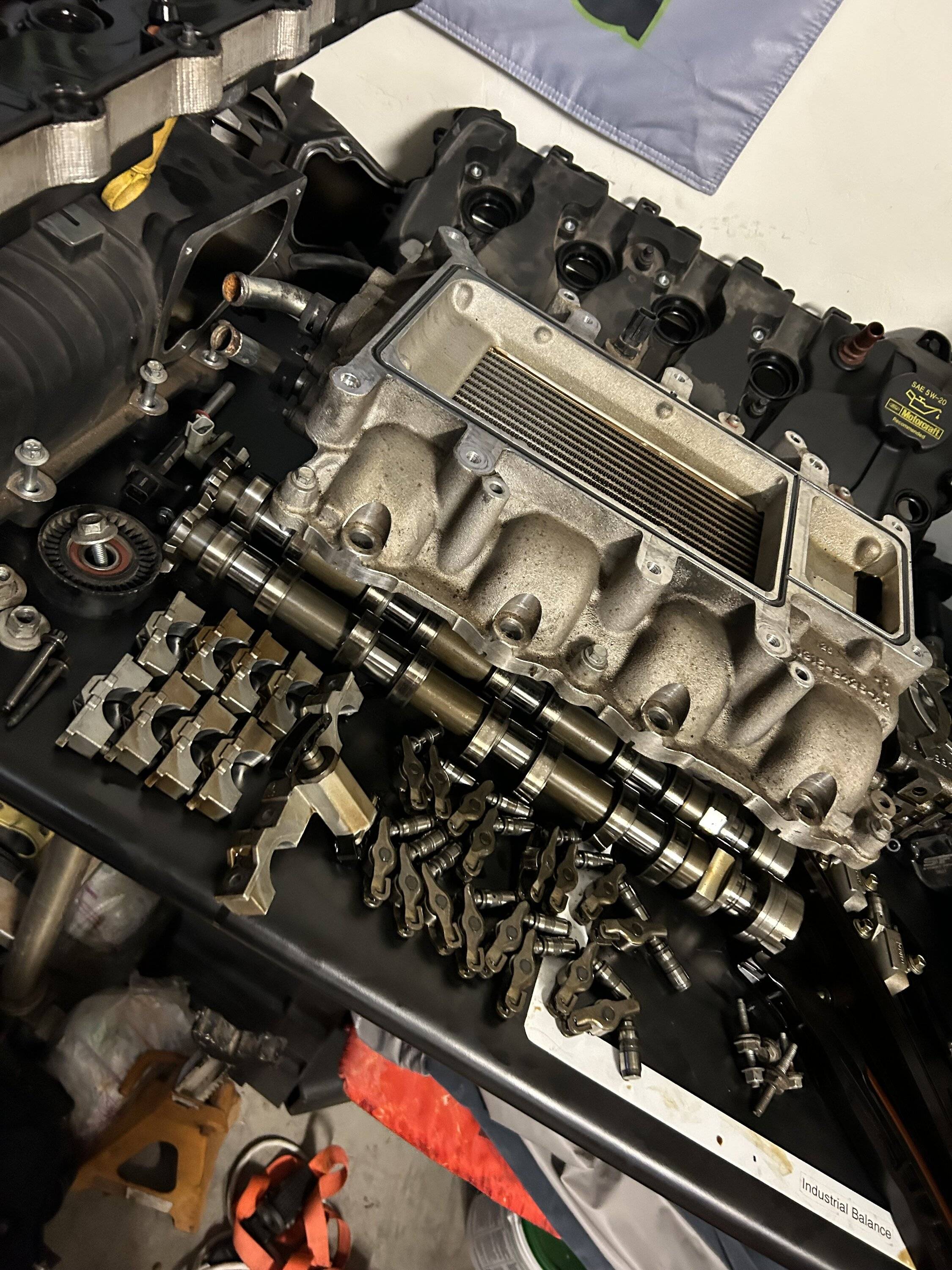

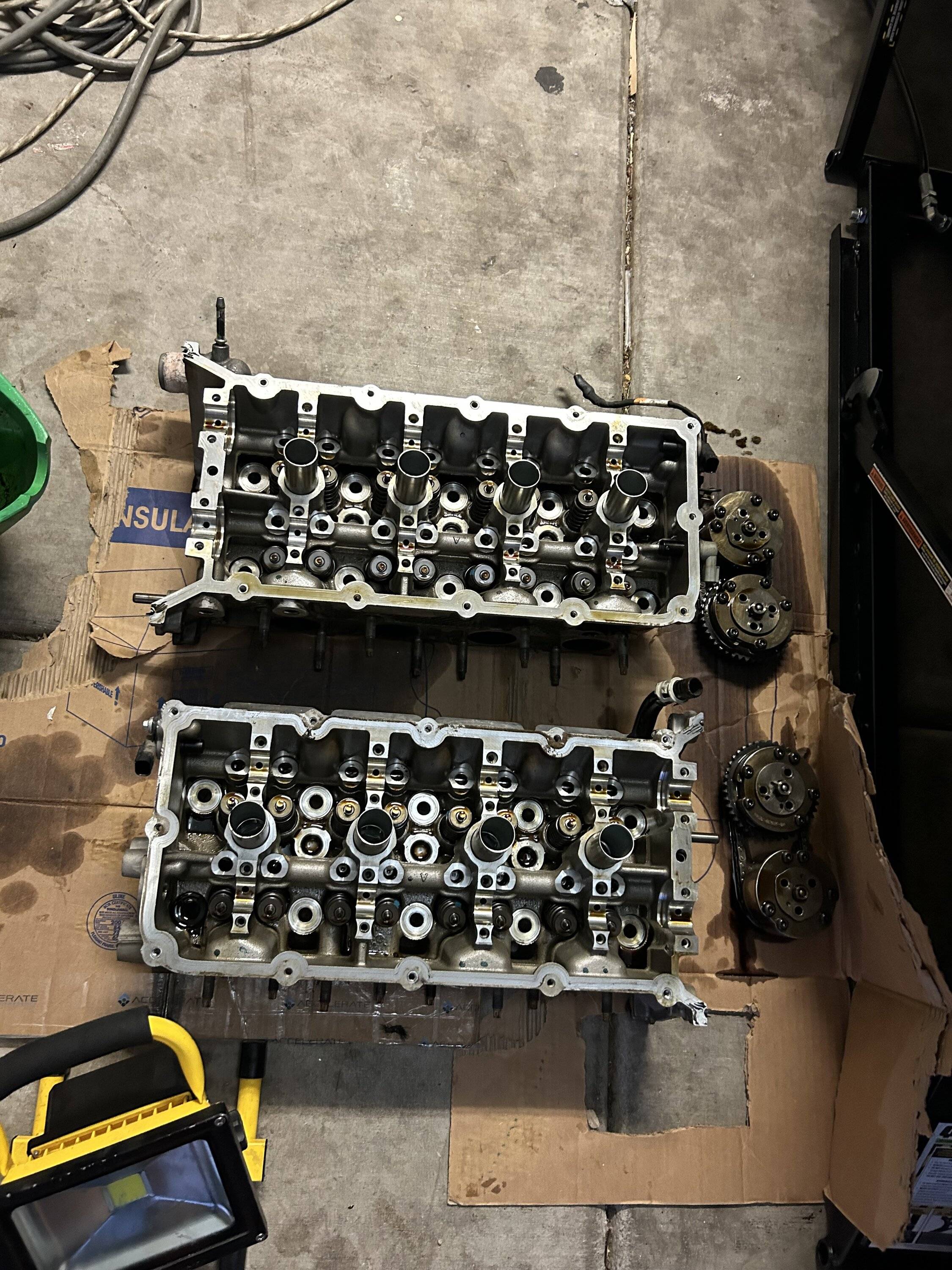

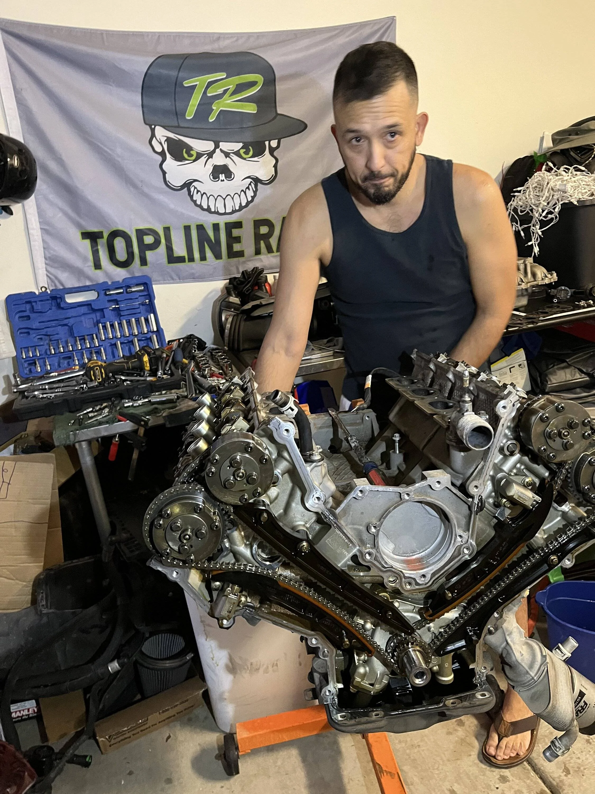

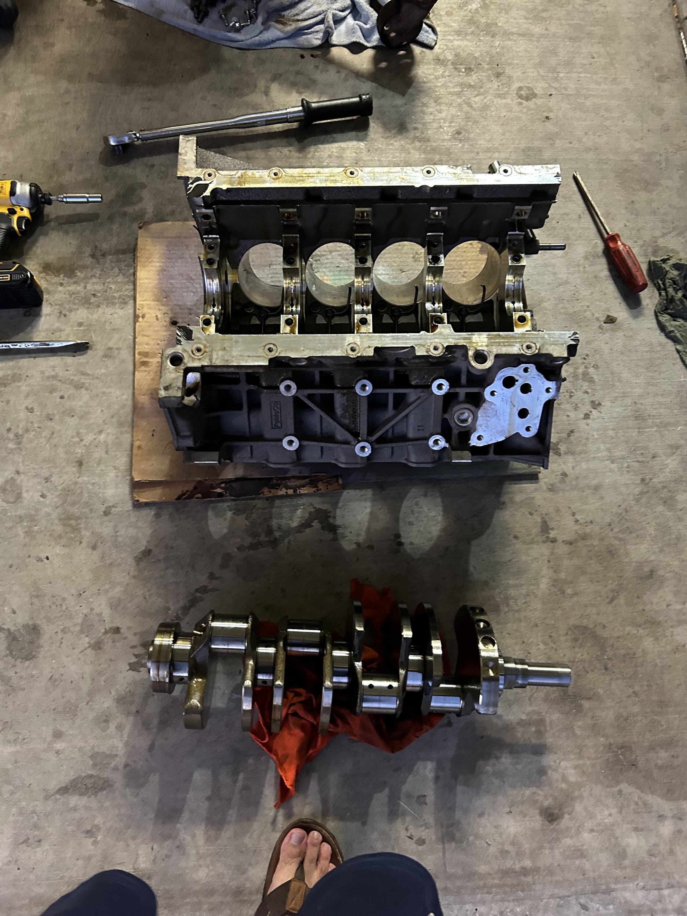

So I always had trust issue with mechanics, and not being able to do things, right. I’ve been working on vehicles with my dad since I was about eight. So I bought the car off my brother-in-law and about two months later check engine light came on low compression cylinder five. About the build
1. ARP everything
2. Cometic head gaskets
3. Manly rods.
4. Mahle Pistons.
5. boundary racing oil pump gear.
6. boundary racing crankshaft timing sprocket
7. Hi Tech, cam chains.

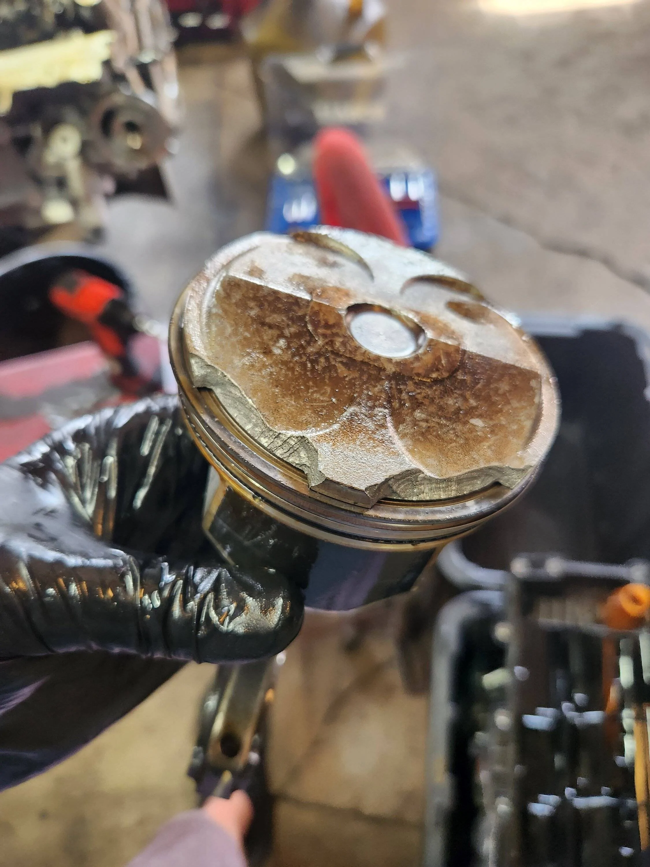

It's not the pistons so much, it's the ring gap. I would gap the top 2 rings more than the factory spec of .009 even if going to stay NA. Just for piece of mind.

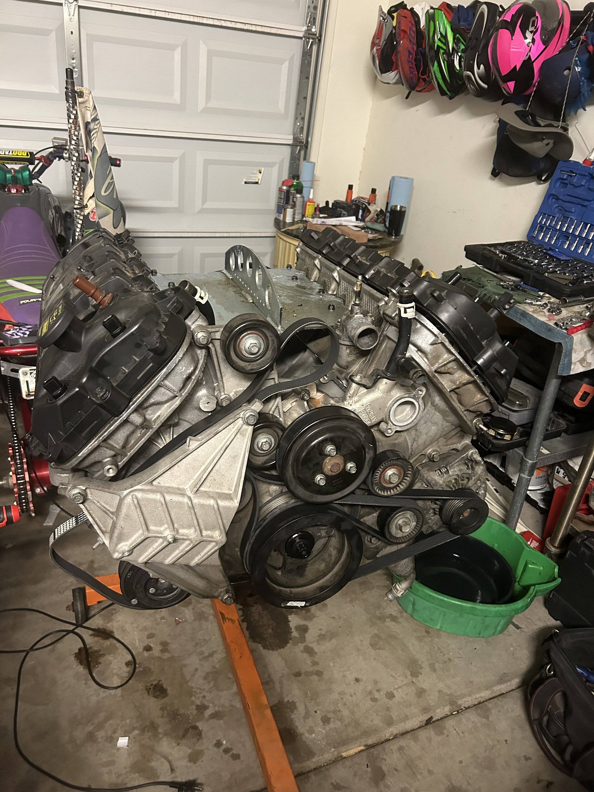

It was completed the end of December 😁

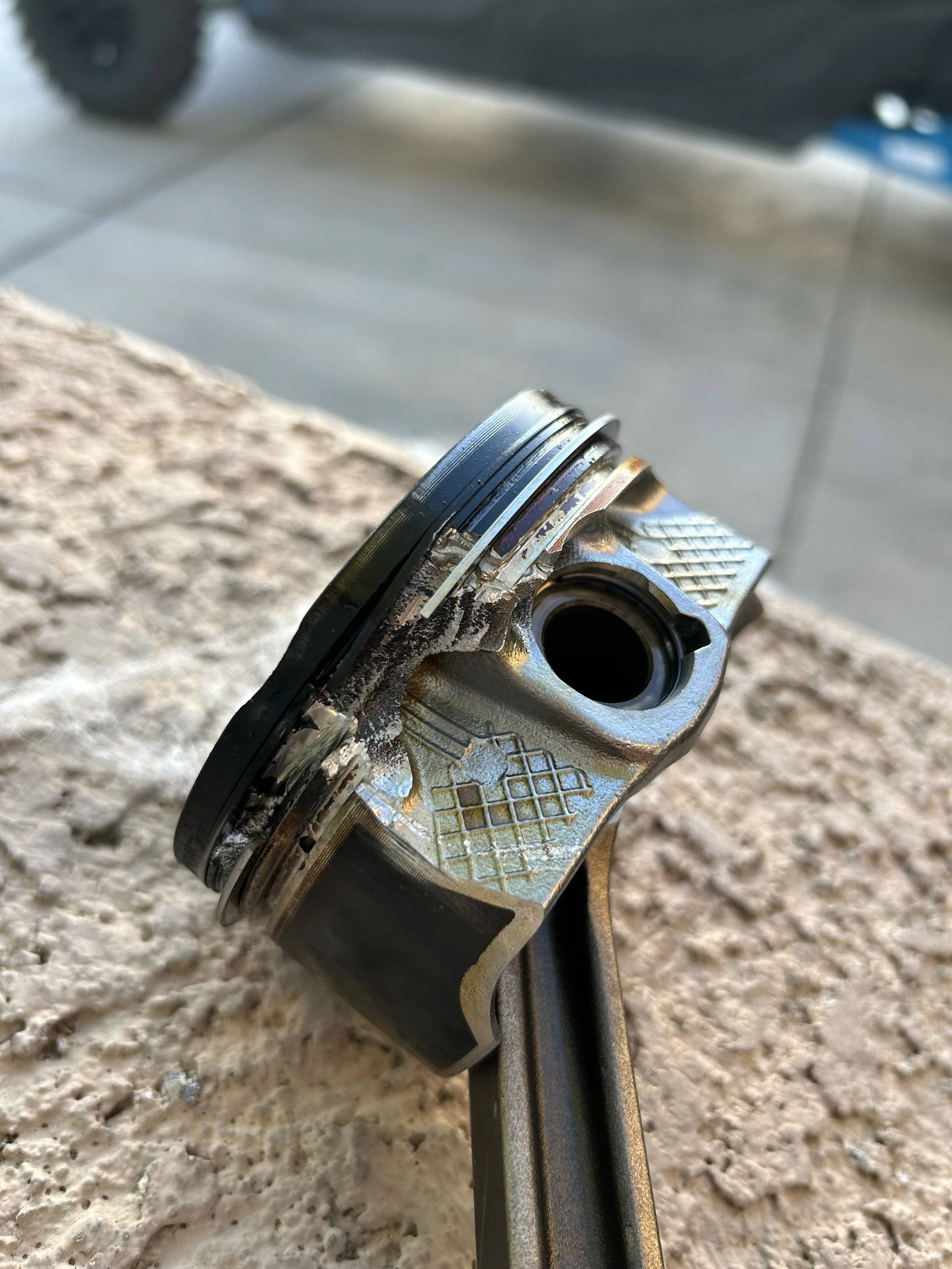

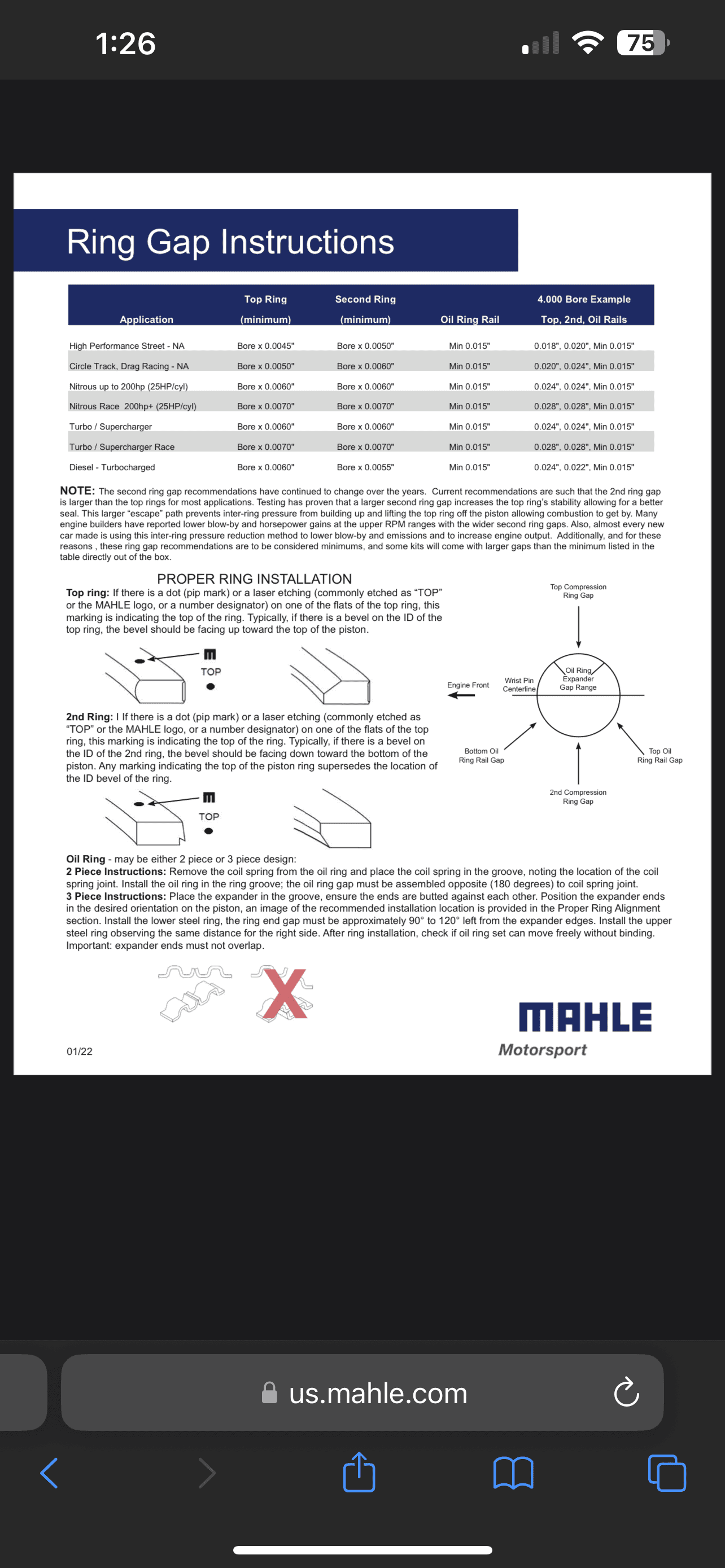

I followed mahles specs on the gap

That's piston to wall clearance. Was was their commended ring gap?
HKusp
Jul 22, 2021
39
2,284
2,916
Hampton, Md.
Jason
2018 Mustang GT

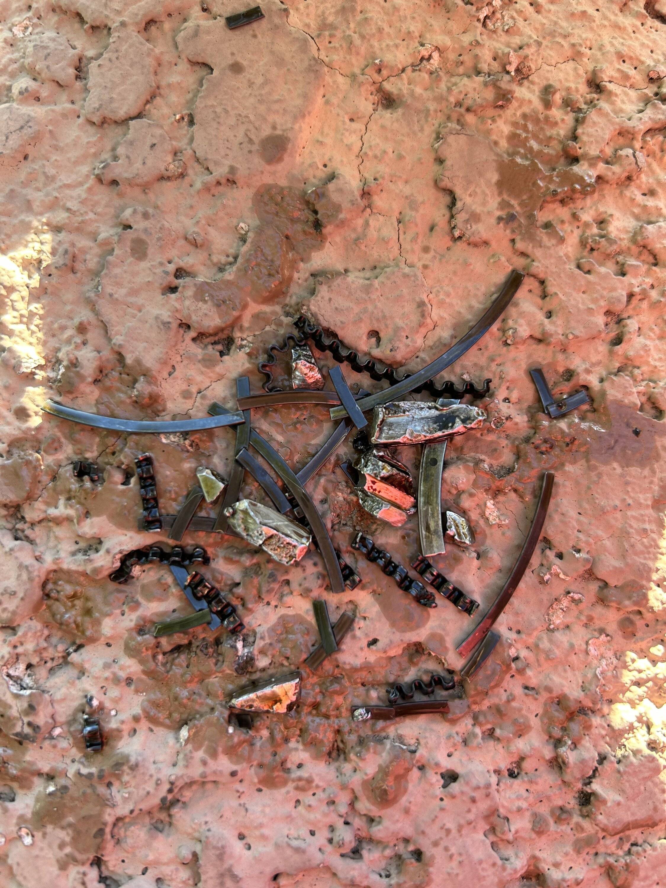

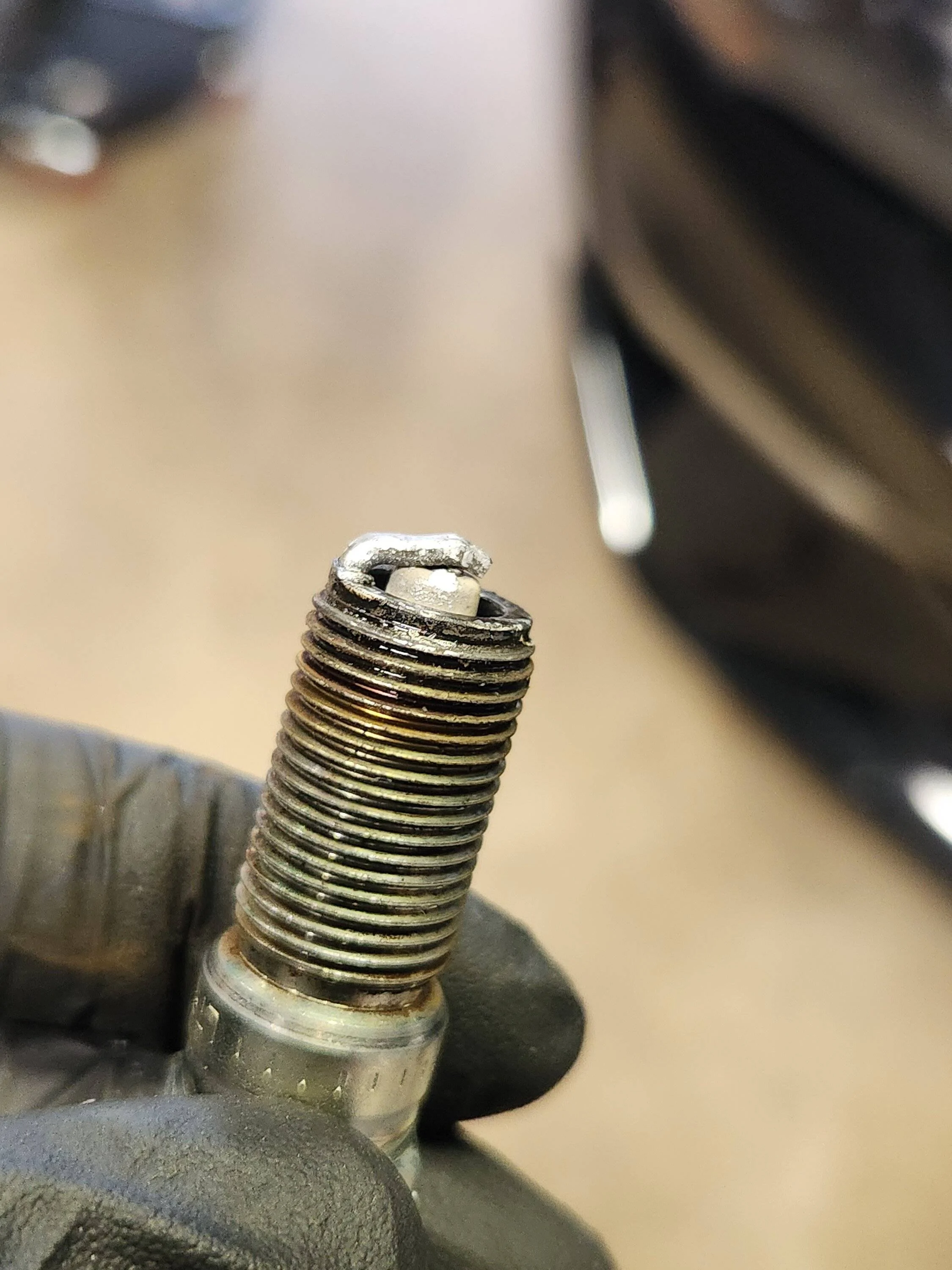

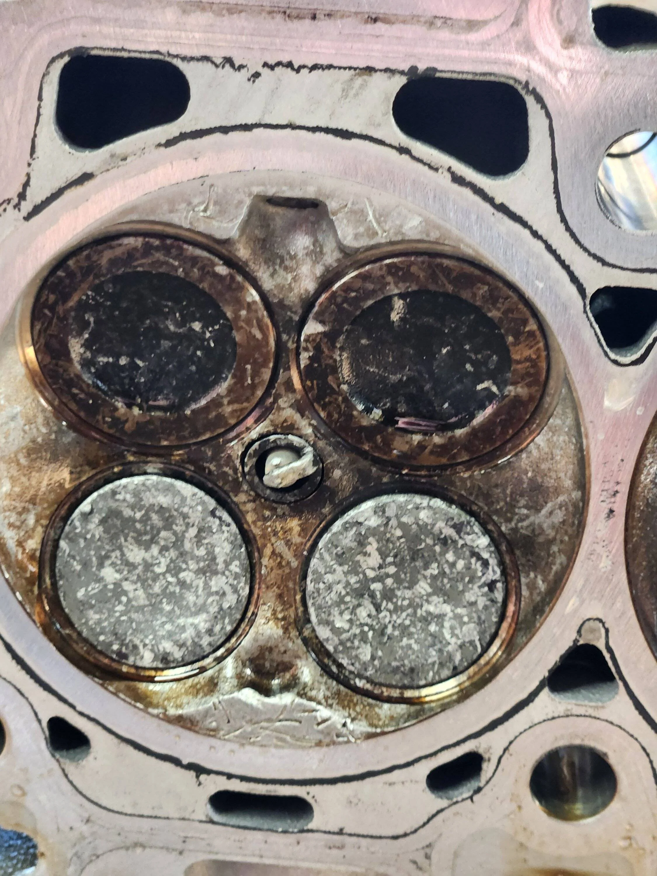

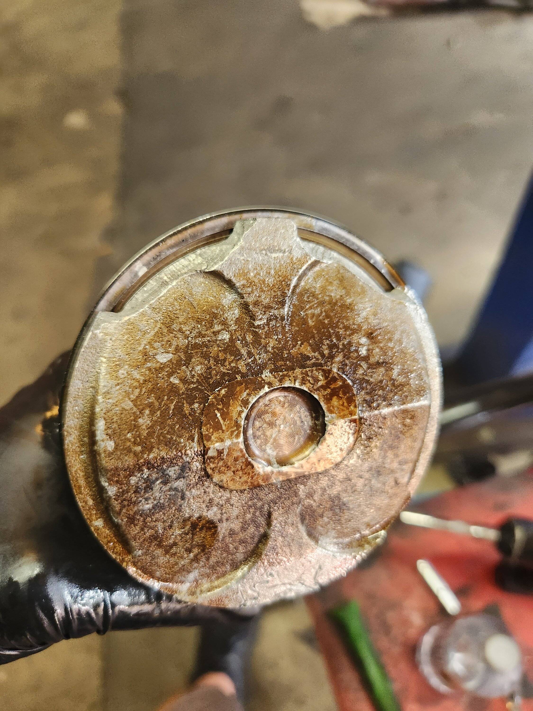

I stand corrected. In my opinion, (taken for what it's worth-which is very little) is waaay too tight. The factory ring gap is .009 and that's why there are so many ring land failures. On my build, I went .025 top gap and .026 (if memory serves) which will net about a 1-2% loss of compression, but will never get in a situation where THIS happens again:
