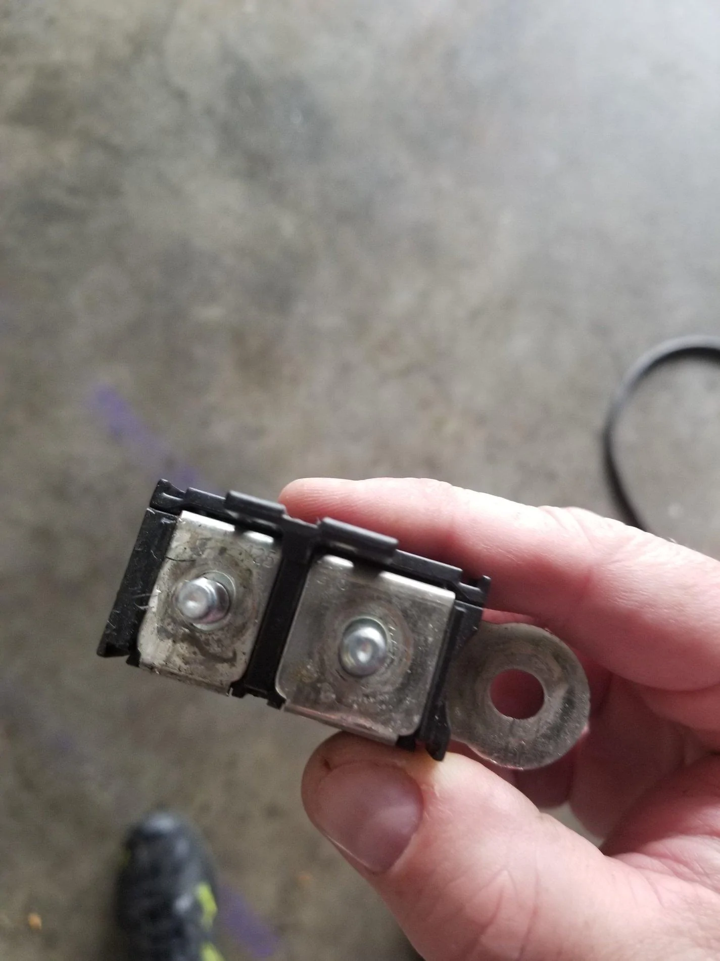

I got the new fuse. You basically remove all three power cables, then use a screwdriver to release the clip and it pops out.

The car is finally fixed. Thanks for all the help.
I think I fried this too. Is that part # FU5Z-14526-A ?

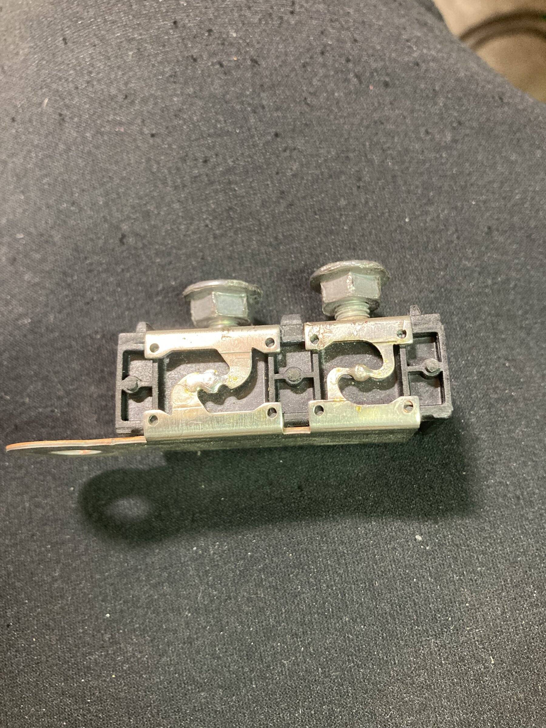

how did the back of this look? I’m having similar issues but mine looks like this
