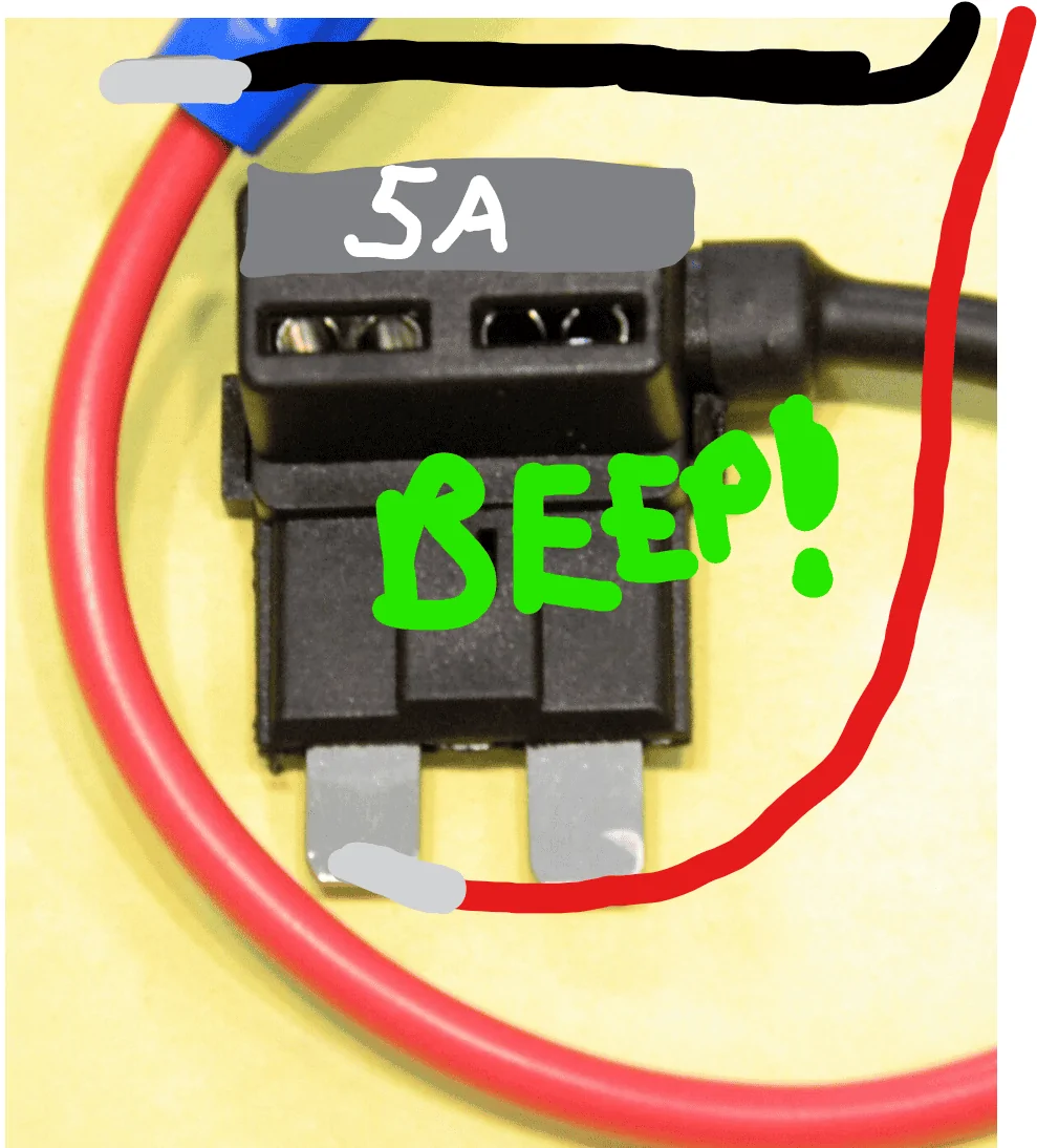

To check which part of the fuse tab is how connected:
Black to the wire of the tap.
Red to the fuse box connector of the tab.
This setup should beep or show 0 Ω
Black or red to ground does not matter until you want to measure polarity.

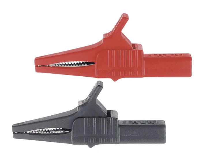

Something link this is also helpful in some case, we call them "flylegs" for obvious reason:
Some of these help to keep ground with no hand, maybe different measuring wires with connector are needed for it.
