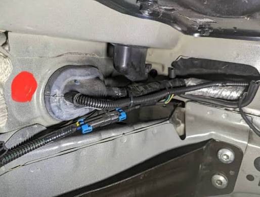

Thanks, just ordered something similar. Was it hard to get the wire into the cabin? I heard there is a grommet somewhere back there to feed the wire through, but not exactly sure where it is.
Not hard at all. You need to slice the nipple (which is designed specifically for routing wires into the cabin btw). There are two (one in each wheel well). Here’s a pic I found on a random search. Look at the wire loom going through the grommet. They’ve already cut off the nipple on it.

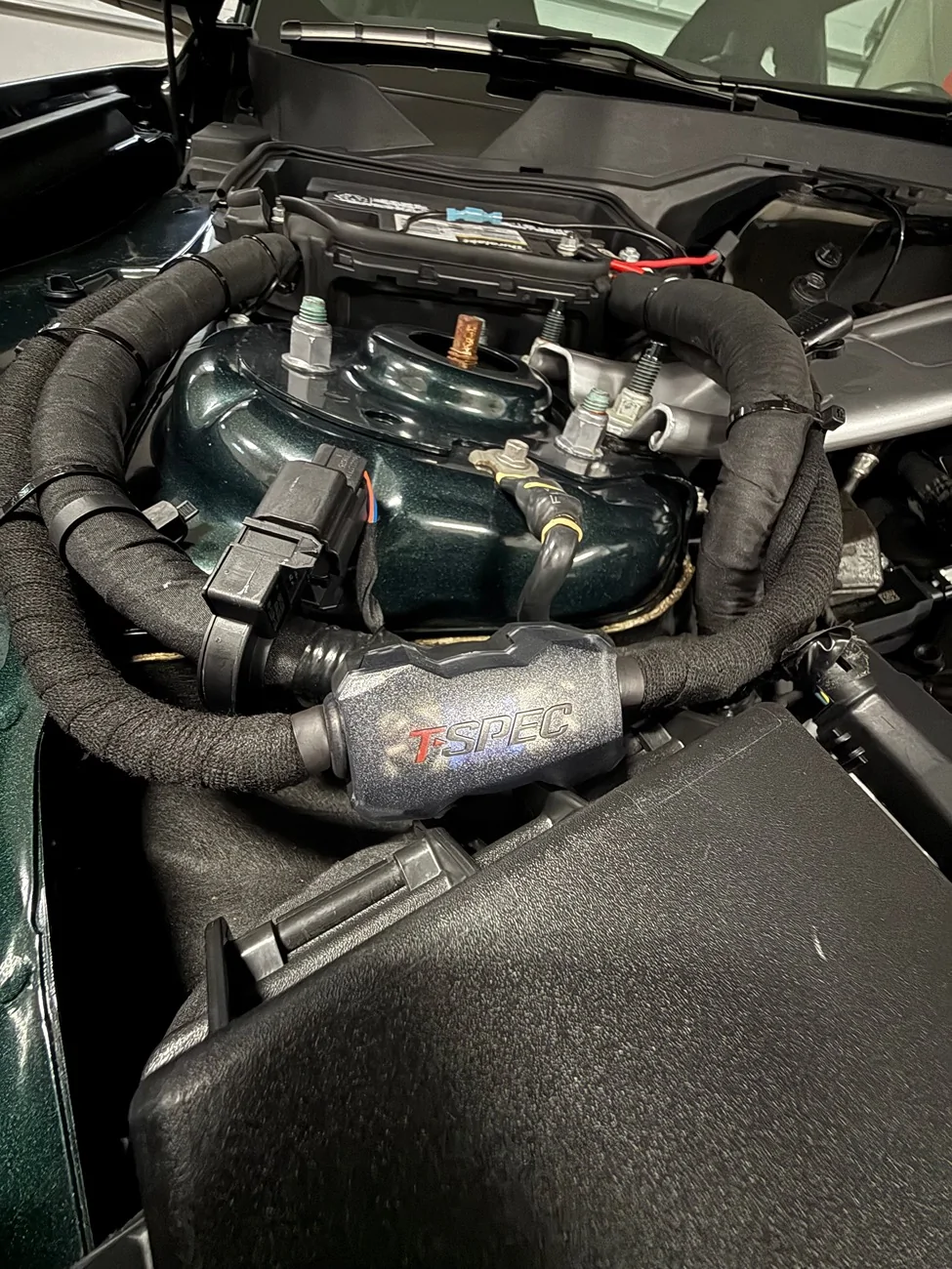

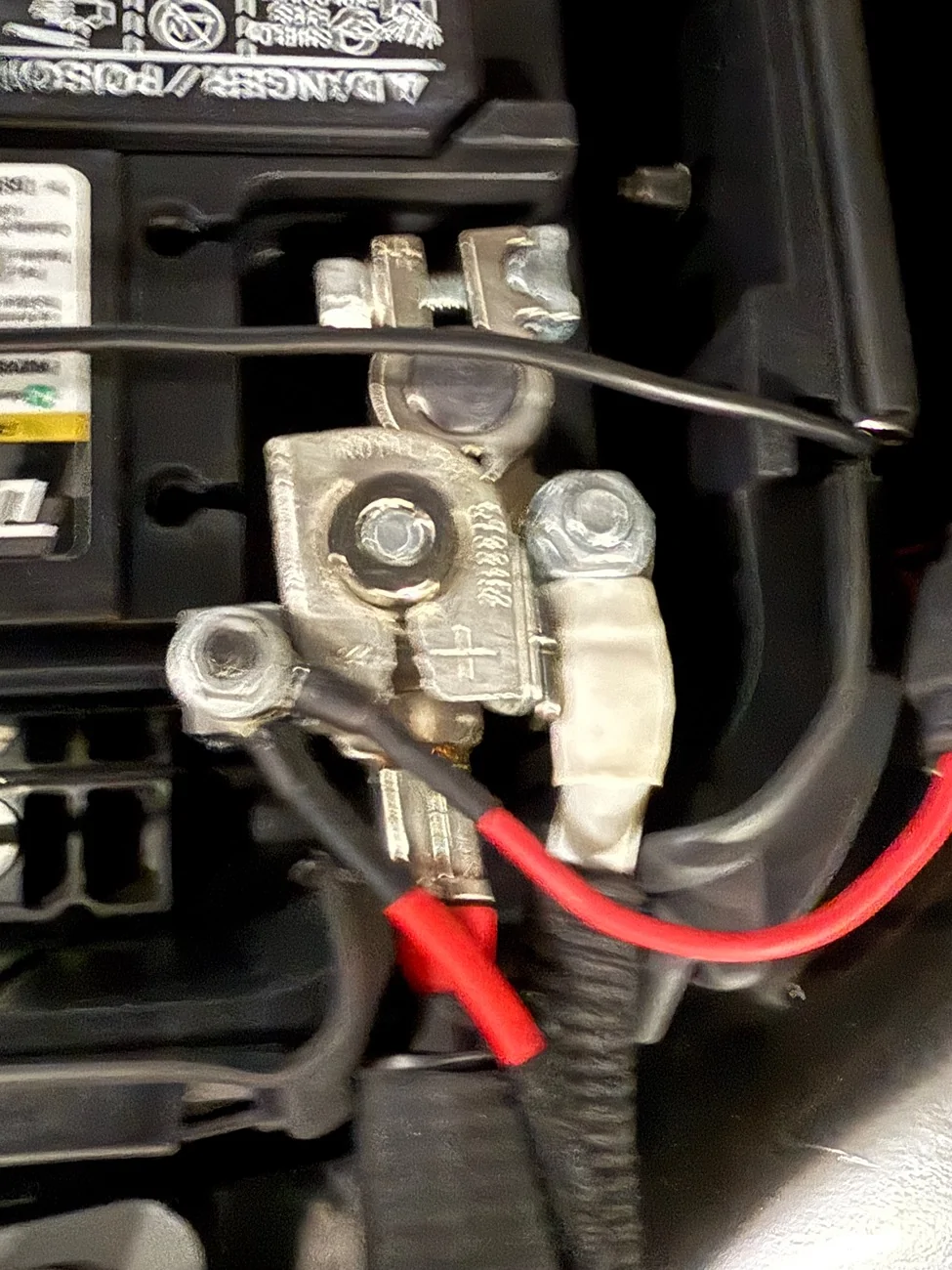

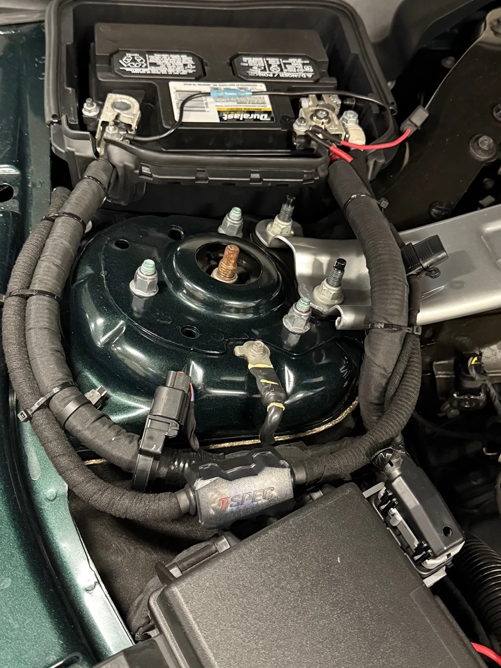

I mounted my fuse holder just under the k-brace just outside of the battery box. I also used a 5/16" lug and connected my power to the tightening bolt on the positive terminal.
