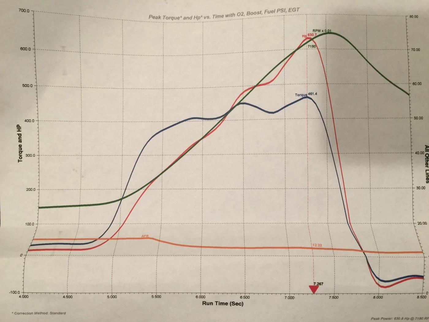

Funky Dyno sheet from today

This look weird or is it just me?

It looks weird mostly because they are using time on the bottom instead of RPM which most people are used to seeing. Where the HP and TQ cross should be 5250 RPM if that gives you any frame of reference.

Was it this shops first time running their dyno?

Now I see, it is the time that looks odd. I was also thinking the way the torque kinda waves a little bit. Thanks for the input guys

I know all dynos are different; however, I made a little over 20 rwtq more than you, but 10 less rwhp. Was the pull done with the nannies turned off?

Nannies were off John

They started the pull at almost 5k rpm
They started it at 2,500 rpm. (pretty normal)
And looks like HP and TQ move around together. (normal, for the car adding and removing timing, or moving the cams)
Looks like a very very normal dyno graph to me.
