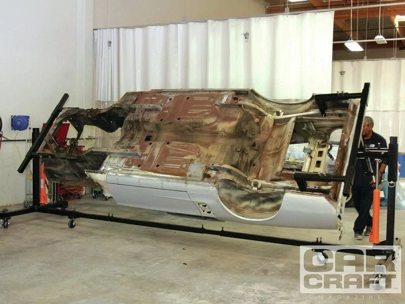

Lifting the passenger side should slosh some fuel over. I am having difficulty remembering the exact shape of the s550 tank since I haven’t spent a lot of time under mine, but I don’t think jacking it will help much unless you jack it to extremes.
Need one of these fuel-draining fixtures
