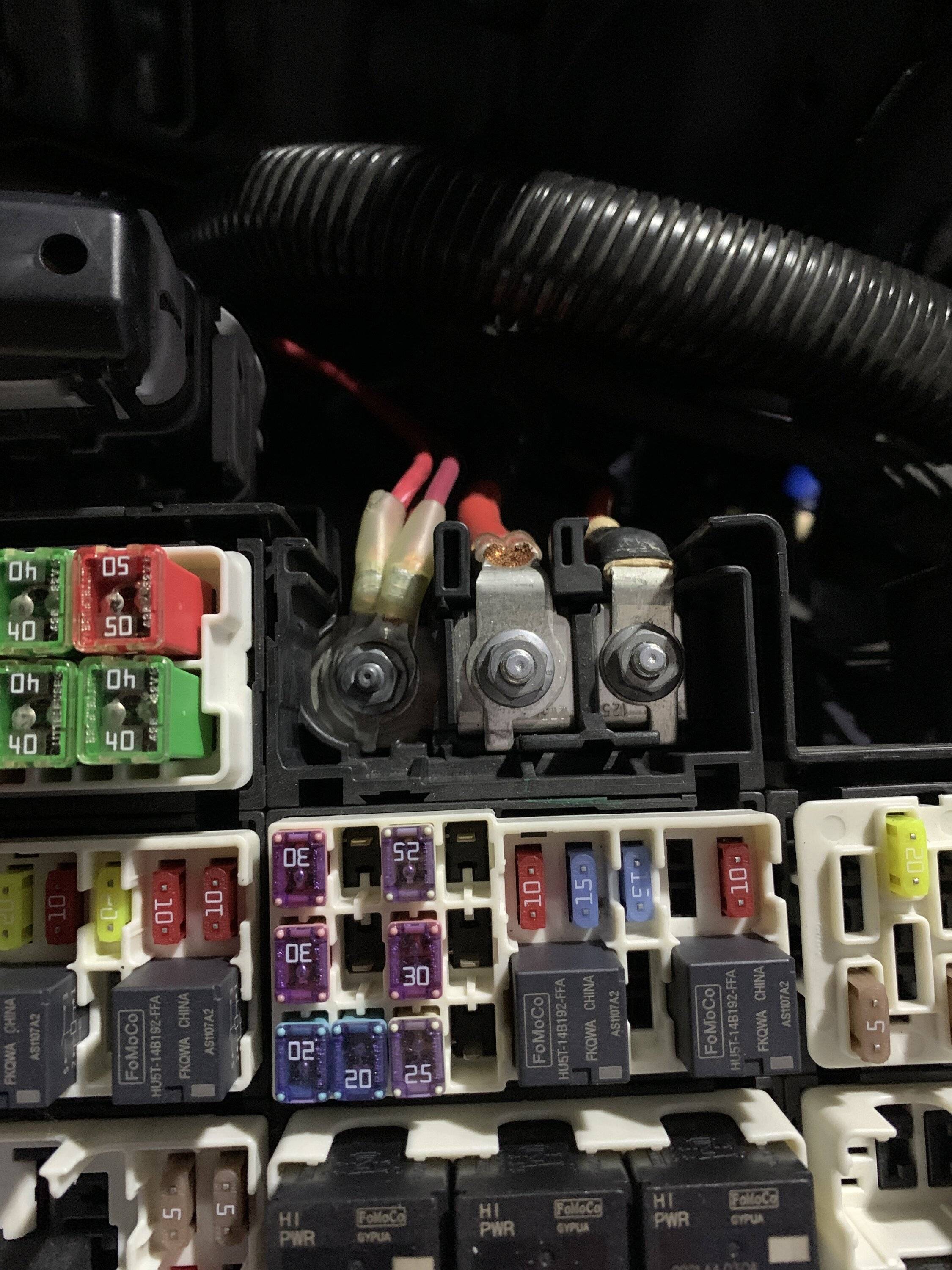

So I am sitting in my garage, my car has been stationary for 24 hours, no entry no exit, and the fuel system just randomly primes as if I had opened the drivers door.
I do have a fuel system installed in the car and have a battery tender on the car at all times when not driving. The battery tender is connected directly to the battery and the fuel system is powered via the posts in the under hood fuse box.
My pumps came with a connector that plugged into the OEM plug near the fuel tank for OEM like priming. I’m baffled…..
Any idea what may have caused the fuel system to randomly prime?
Photo below shows the fuel pump power wires on the far left fuse box prong. My fuel pump ground is to the rear seat anchor as guided.
