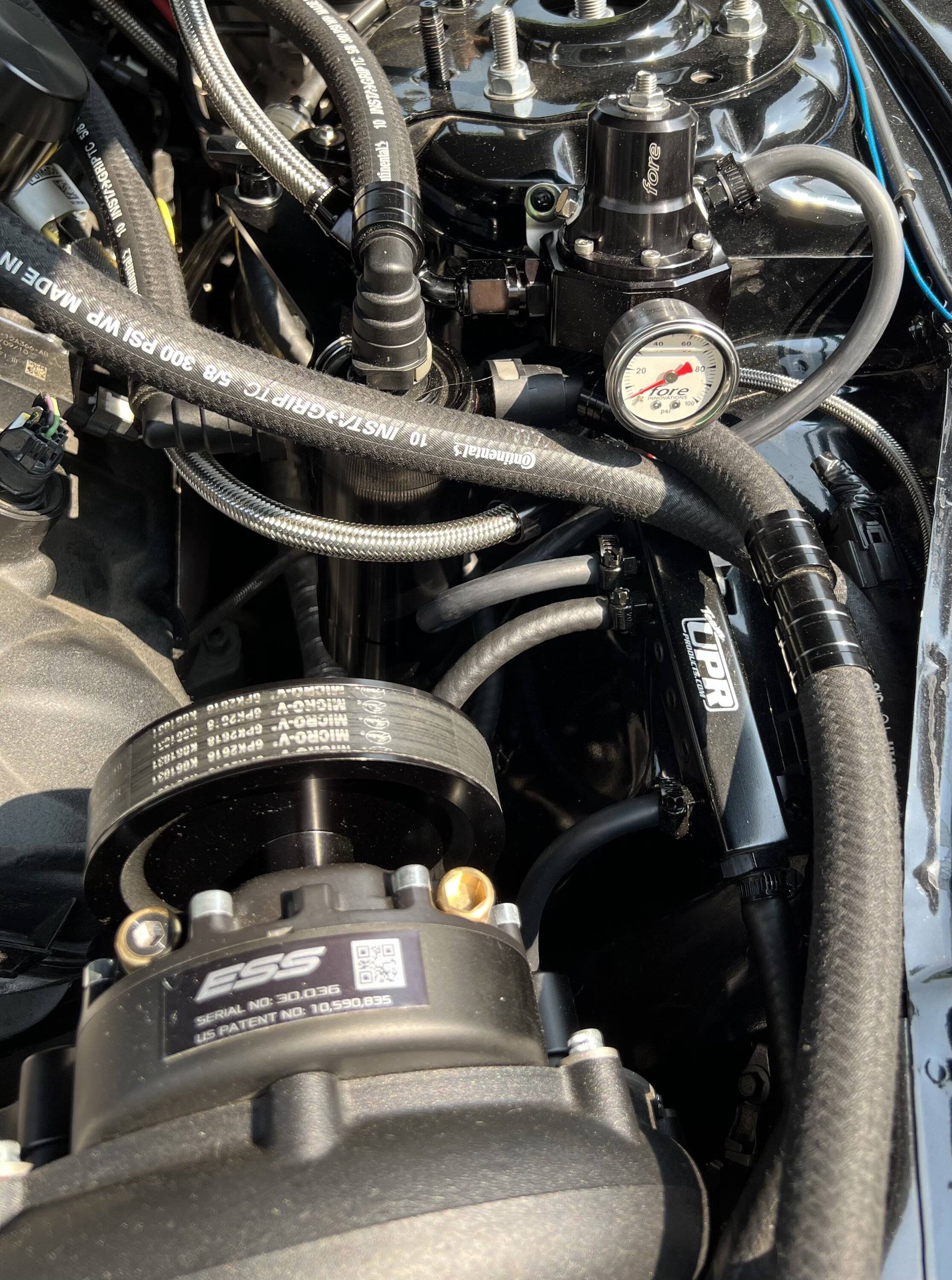

Another question you might have an answer to since I got you in here, this is how I have mine setup.. so do I just set it to 54psi how it is, or should I remove the vacuum line and cap it off and then set it to 54psi?
Set with vacuum source off and then put it back on after.

I set my base pressure to 55psi @ idle with vacuum applied to the regulator for both gasoline and Ethanol. Twin Ti274’s in a Radium basket setup.

I set it to 54psi without vacuum and then hooked up the vacuum again and it was at about 51psi. I’m just going to leave it until Monday when I hear back from my tuner.

I set mine to 55psi but I did it with the Key On and Engine Off. I just bypassed the FPDM with a jumper wire so the pumps would run constant with Key On. I thought it was easier that way and the gauge needle is rock steady when Engine is not running.

When I had his tune he sent me a new revision for the fuel system so yes you need to log every revision to make sure it's calibrated properly.
Also he got me to set my pressure to 55PSI with Vac hose off.

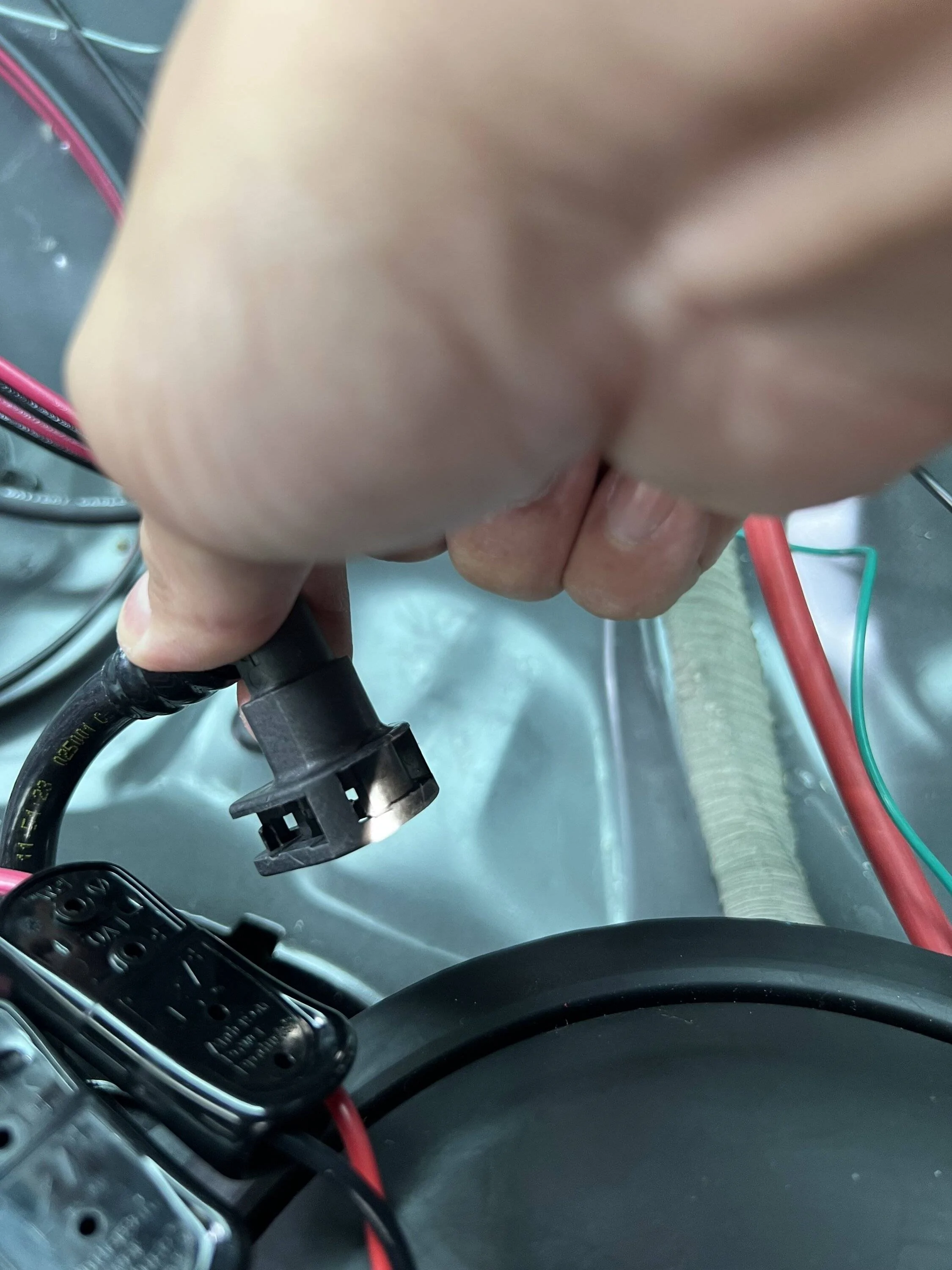

Question, how long before the fuel leftover in the stock line (from the stock fuel hat) runs out?.. lol. Doing my logs now and it keeps leaking out, I wrap a towel around it and tape it up every time.. it SEEMS like it’s getting less and less every drive but wanna make sure it’s ok to leave unplugged like this.
