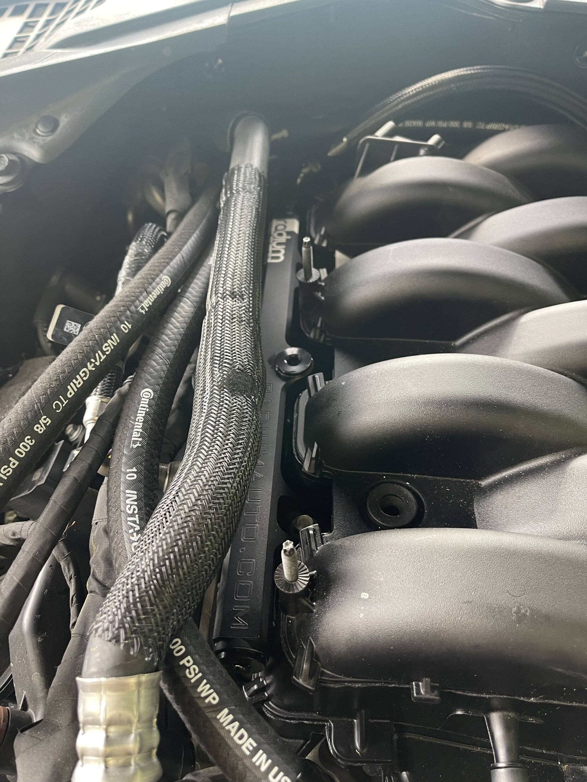

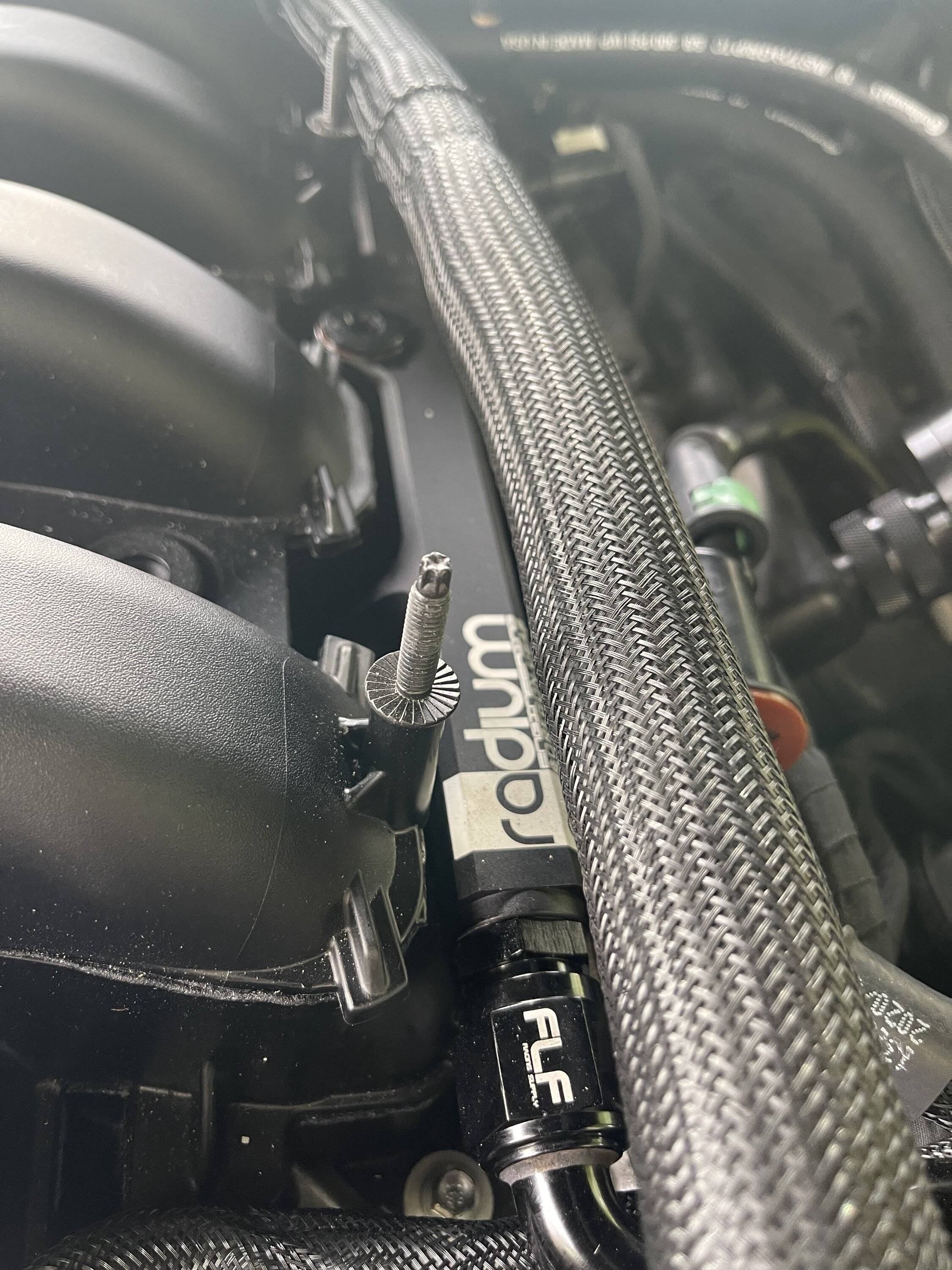

I run radium fuel rails with a crossover. Haven’t had an issue in over a year running them and give your ports to run things like an aftermarket fuel pressure gauge etc etc.
