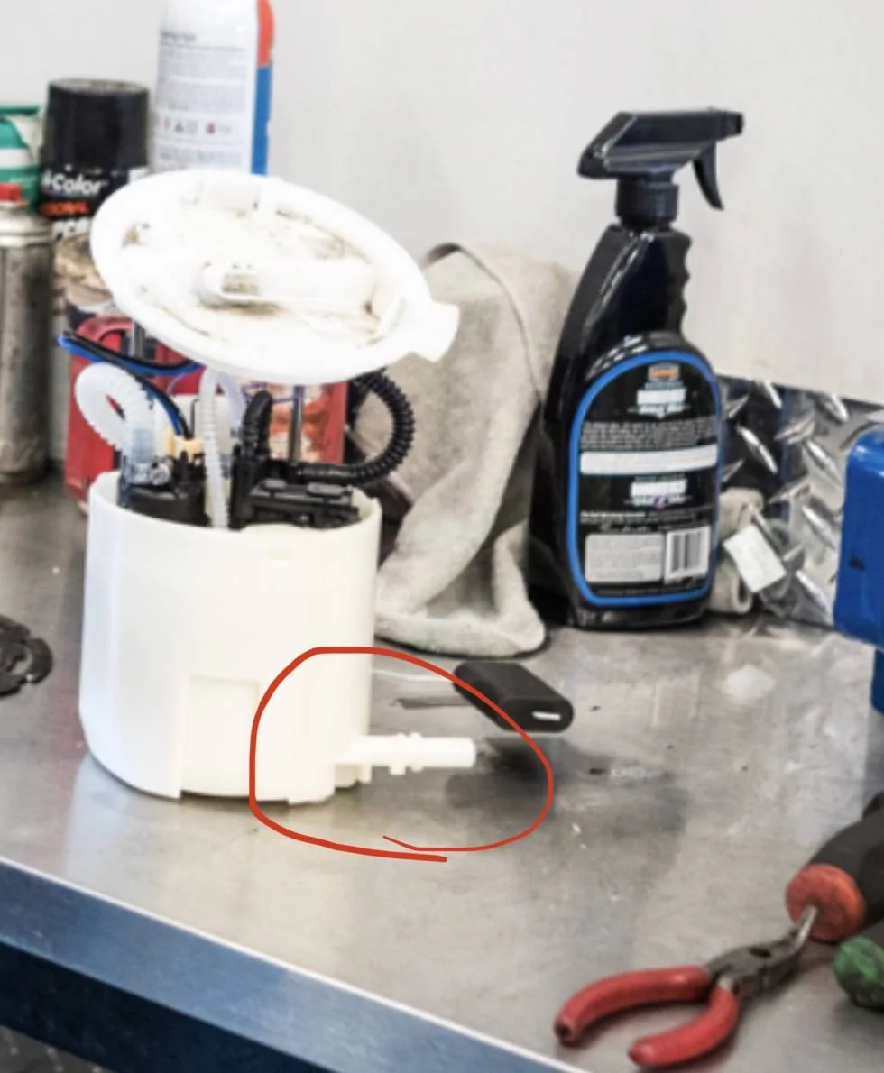

I just installed the Whipple Gen 5 3.0 Stage 2 kit on my 2018 Mustang last week.
The car runs strong until it hits half a tank of gas.
Once it has half a tank of gas or less if I go any more then quarter of throttle the car will go lean and break up, even just normal cruising.
Other then possibly missing the transfer connector on the DW400 pump, is there anything else that would cause this?
If I fill the tank back up everything is fine again until I hit half a tank again so trying to figure out what I should look for.

Isn’t there a Venturi line that pulls fuel from the passenger’s side of the tank? It sounds like that part isn’t working.

Yes, if you are not pulling from the passenger side the car will go lean at half tank

Is it the transfer connector at the bottom of that the hat that pulls from the other side? I am starting to think that they missed that connection...

The other thing to watch out for is incorrect install of the float itself (snagging).
Eg. The tank might actually be empty (ish) but the level shows as half.
Simplest method for checking, fill it up and take note of how much it takes to fill or keep an eye on the gauge...

your floater is most likely stuck over the cross over hose which isn't letting it give you a accurate reading below half, this is common. Usually happens when you do the install with fuel still in the tank. When the tank is empty it's not an issue, but when you have fuel in te tank the cross over hose likes to float on the fuel and will float its way under the fuel level arm and then not let it come all the way down when you are low on fuel

Thanks for all the suggestions guys.
We pulled the assembly today and it turns out the smaller hose had popped off one end of the venturi outlet.
Got her clamped up good now and she's running strong again!
