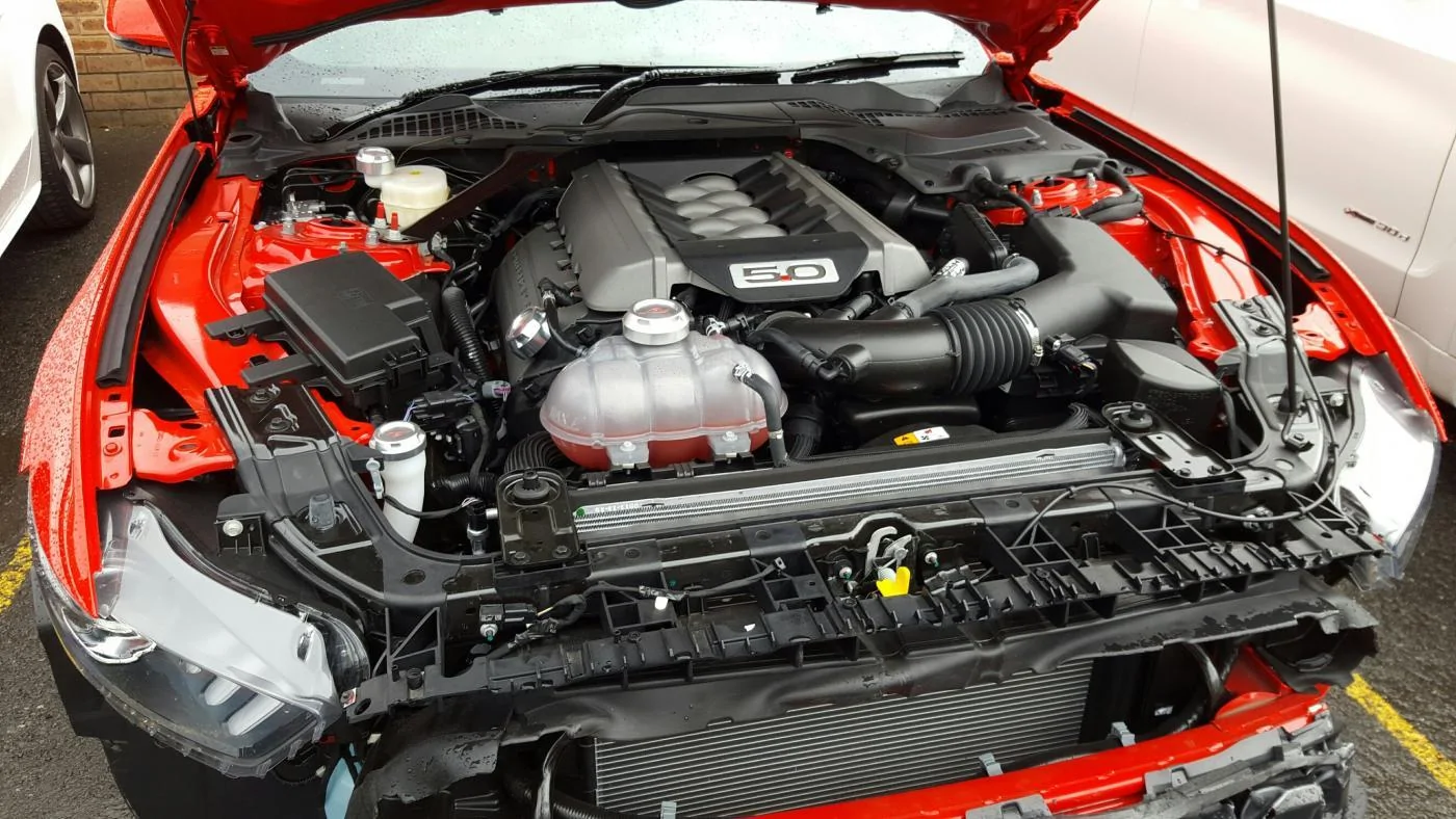

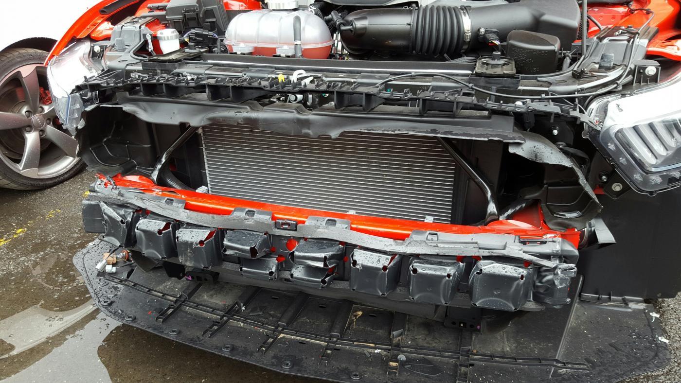

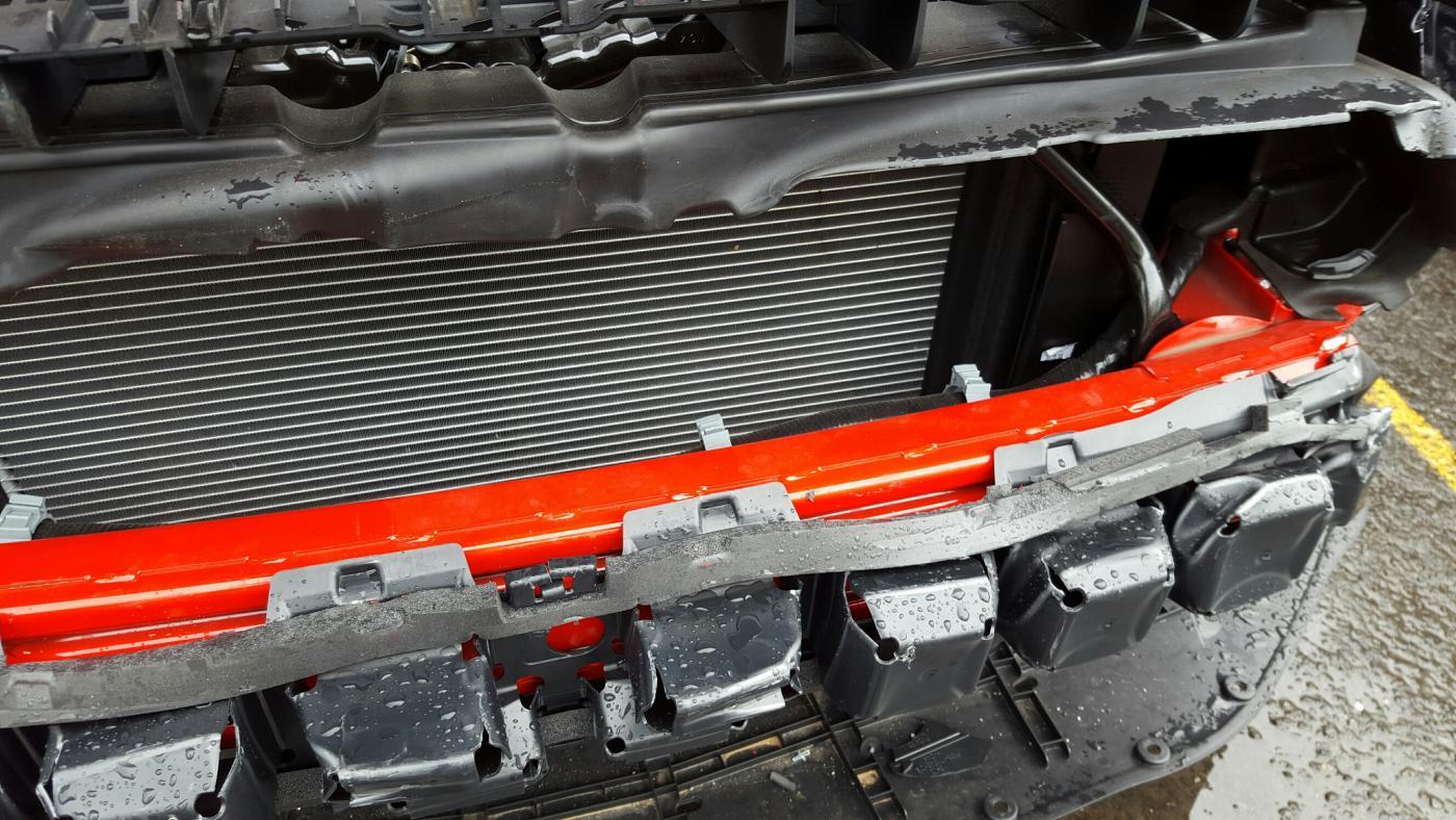

Photos of the car with the front off. The red bar that has the plastic absorption attached to is the only mental piece that will need to be replaced besides the front. Front chin spoiler is fine. Rest of replacement parts will be clips and plastic grill etc. Built Ford Tough

Sorry it happened but fascinating to see behind the scenes how the mustang coped with the accident. I hope it doesn't wind up costing you too much extra in renewals.
Having a mustang to drive around Australia, how lucky can one man be...

Sorry to hear about your mishap and good news no injuries.
Positive to see how well the 'stang held up to the impact. Poor Kia looks well mashed. Hopefully you will be back on the road shortly once parts get shipped which I hope is quicker than we seem to get them in the UK.

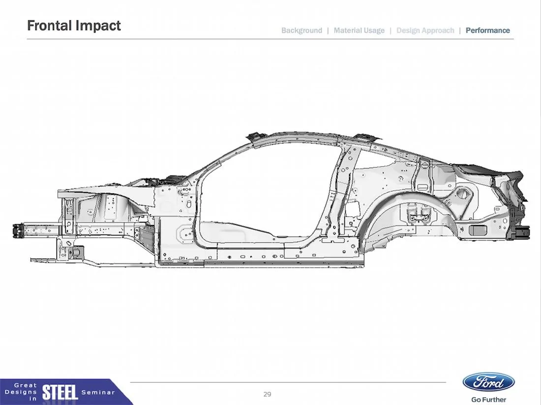

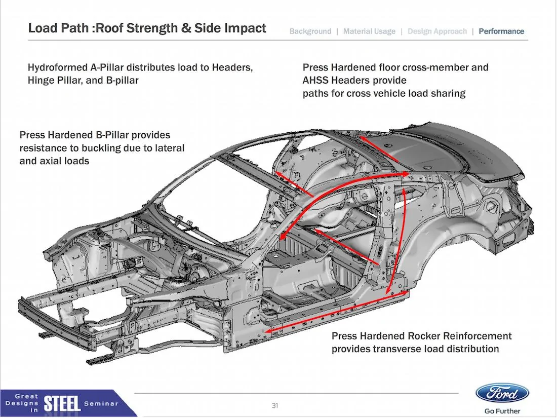

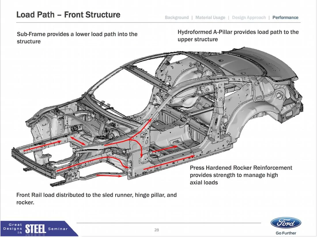

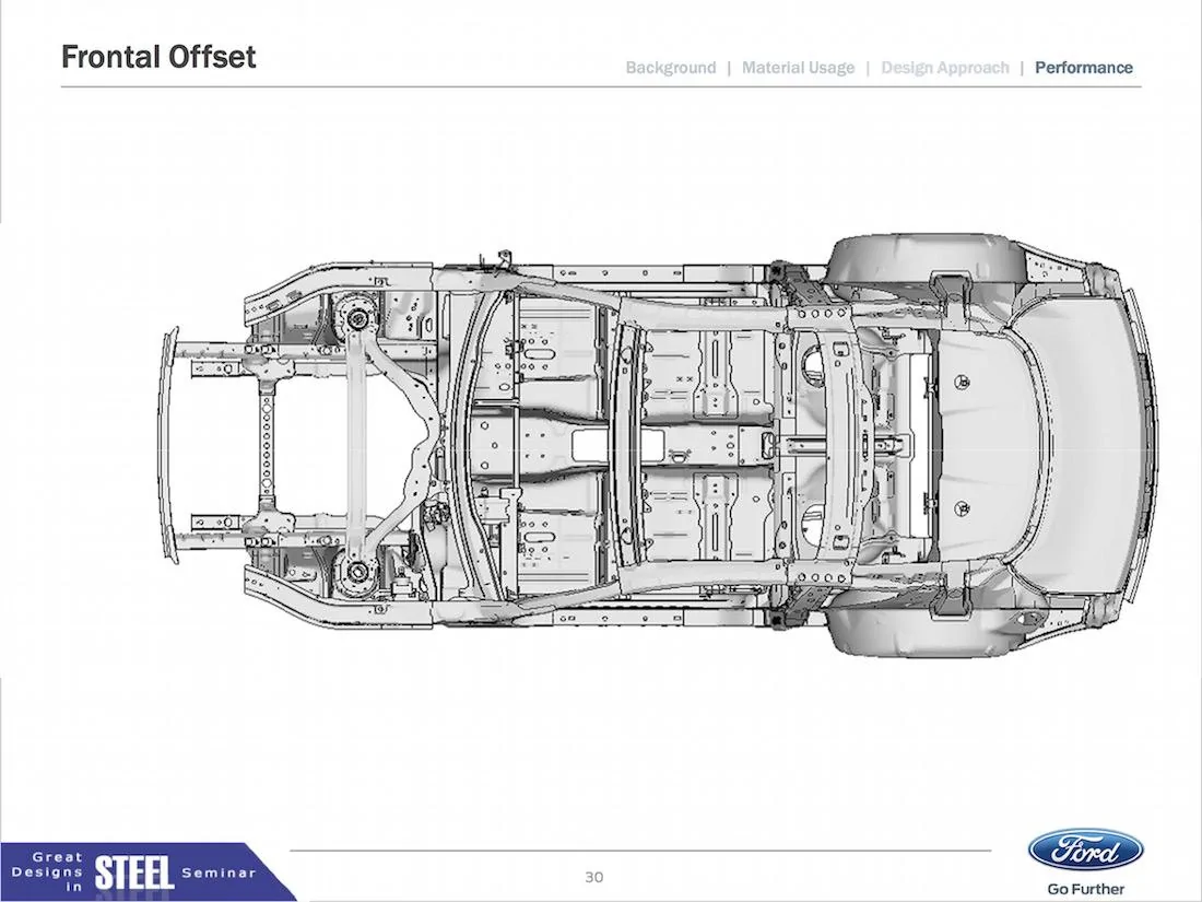

S550 Load paths
Hi Greg good to know everyone is ok, I came across these drawings sometime ago, just not sure where now, a good insight of the design features of the S550

Wow I love these designs. Thankyou very much Actually found the whole document. Something to add to my file on the Mustang. About 34 pages.
