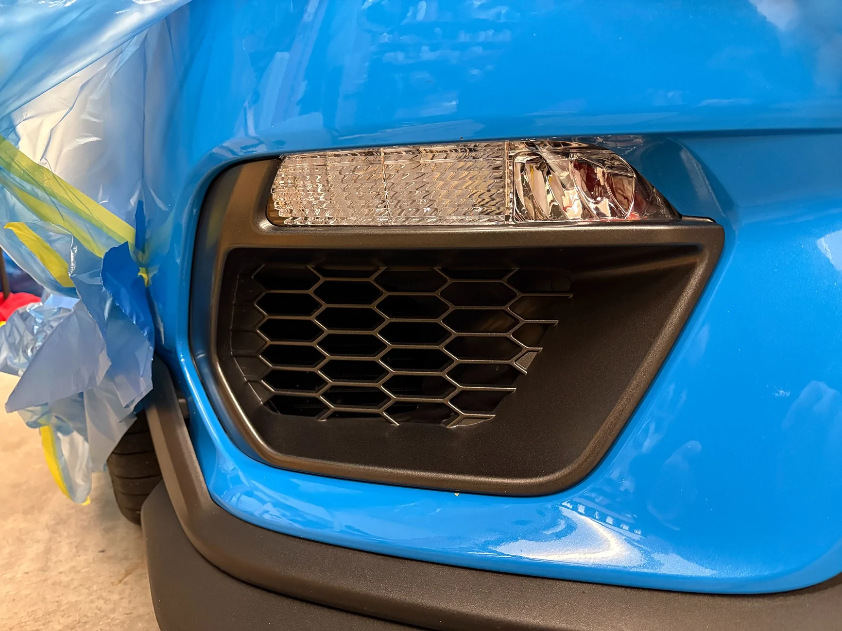

Hey, looking for any recommendations to upgrade my current front turn signals to LED with integrated fog or day running lights. Anyone have any success with a particular product? Thanks

I don't have any experience with LEDs, but I learned that the M1, and GT350 use the nonLED turn signals due to limited space between the bumper and oil coolers. The GT LEDs are very large in comparison.

Can't go wrong with Diode Dynamics. Other name brands that will stand behind their products' quality are probably fine, too, while the no-name junk offered on Amazon and eBay are hit or miss. I found these discontinued Shelby Performance LED signals on close-out a few years ago for my Mach 1 because I wanted to try out the incorporated fog light. (It's nowhere near the quality or intensity and beam pattern as the Diode Dynamics LED w/foglight signals my son has on his 2022 mustang GT.) Also, the better 2015-17 LED signals will have the proper internal resistance built-in so the car's body computer doesn't get confused thinking a bulb is burned out or give erratic blinker frequency from the low current draw inherent to LED lights.

So I have seen. Had whole front end off and attempted to install "will fit" lights and wasted my time. Got opportunity to learn more about my car though. Thanks
